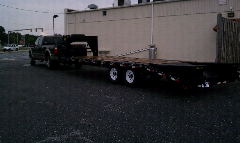

New London Trailers in Forest, VA (near Lynchburg). They were very nice to deal with. I think I got a decent deal. 20 + 5' 14k gooseneck with foldover ramps and pop-up center section on the dovetail. Twin jacks and chain locker plus spare tire for $6,600. It's a well built trailer with 12" I beams running the length of the deck.

Here's a photo of the trailer. Hopefully there will be another photo soon with the tractor on it!

B Hoofed,
That is a nice trailer should work well for your tractor.:thumbsup:
I currently have a Big Tex 12PI 20' I use for my compact tractors and have been well pleased with the way it pulls and has held up well. Next year I will buy another 22' tiltbed 14k trailer and may get another Big Tex.
In some states they do make a big deal over the combined weight rating and others such as mine don't bother with it. That said I think you are using good sense to eliminate that from being a problem.

I've got almost the same trailer. Only difference is mine has the single jack. Good trailer.
