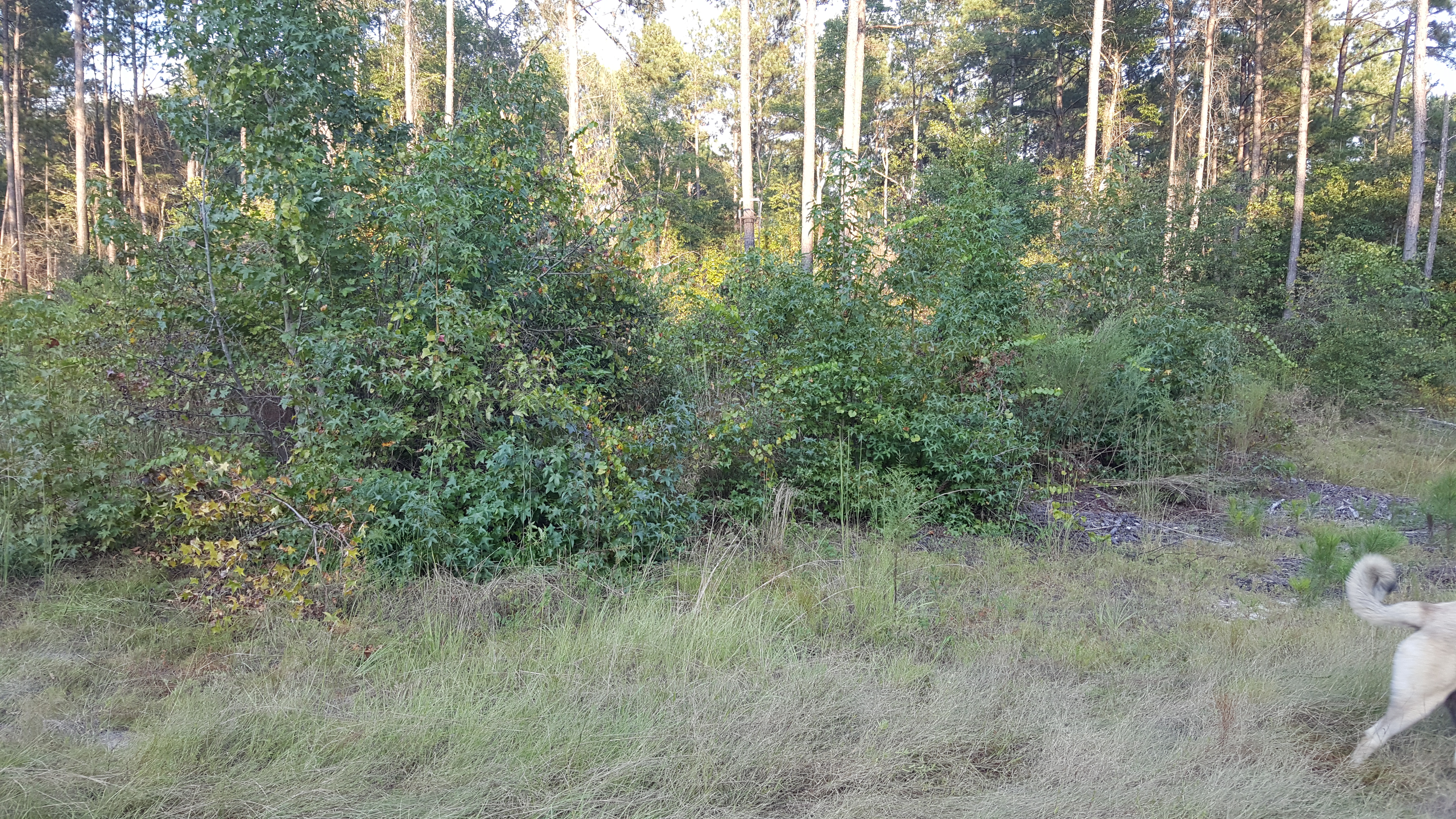

Here is some of the work I need to get done - some of the brush I need to clear. 20170918_183150[1].jpg all under 2 inches at the base, but I don't want to drive over it to get the bush-hog on it. Was wondering if a grapple might be a better approach? Or a FEL based bush-hog? Anything attachments has one that runs on 15gpm. or maybe the Intimidator by Danuser?

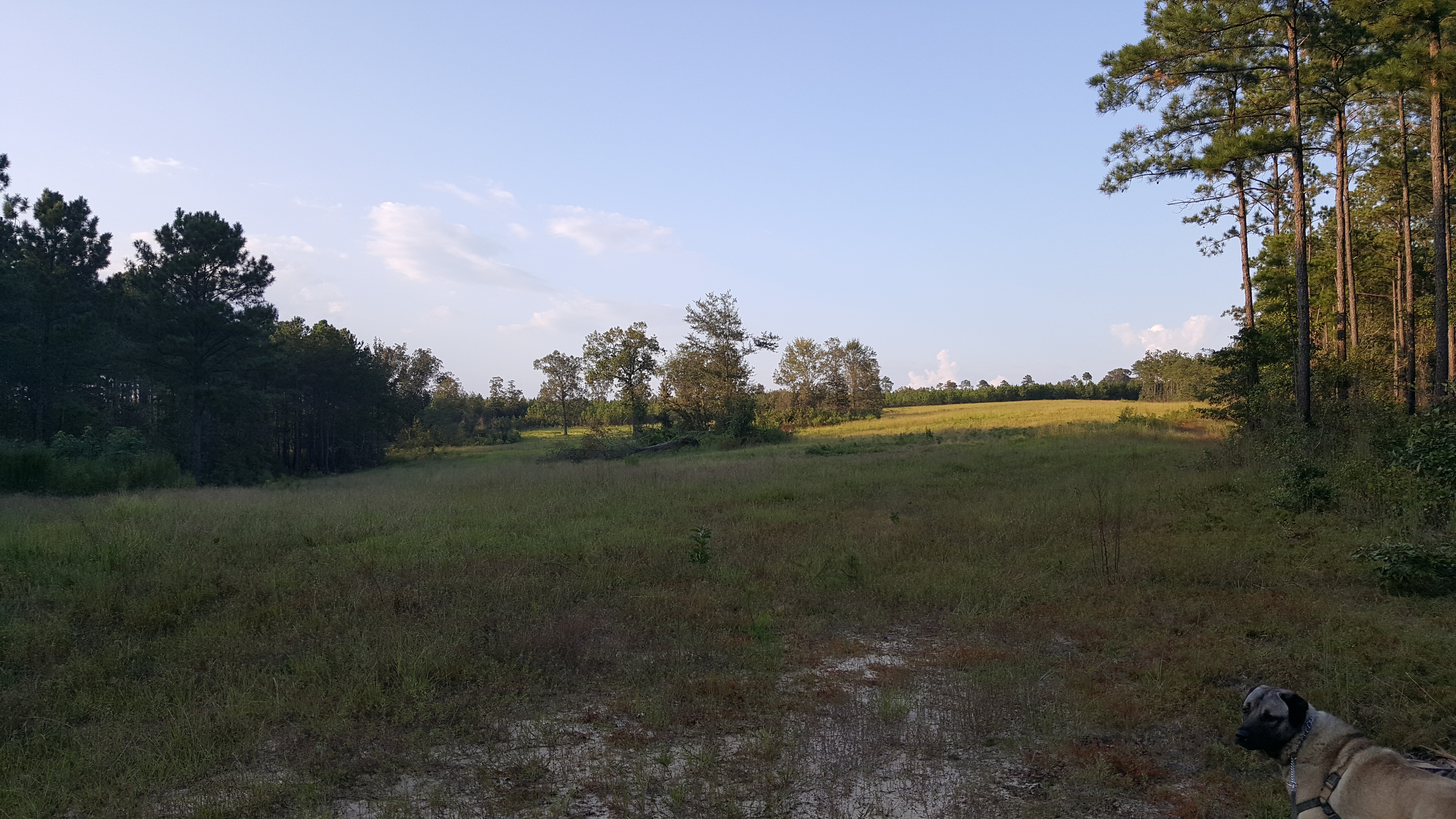

Here's my larger pasture:

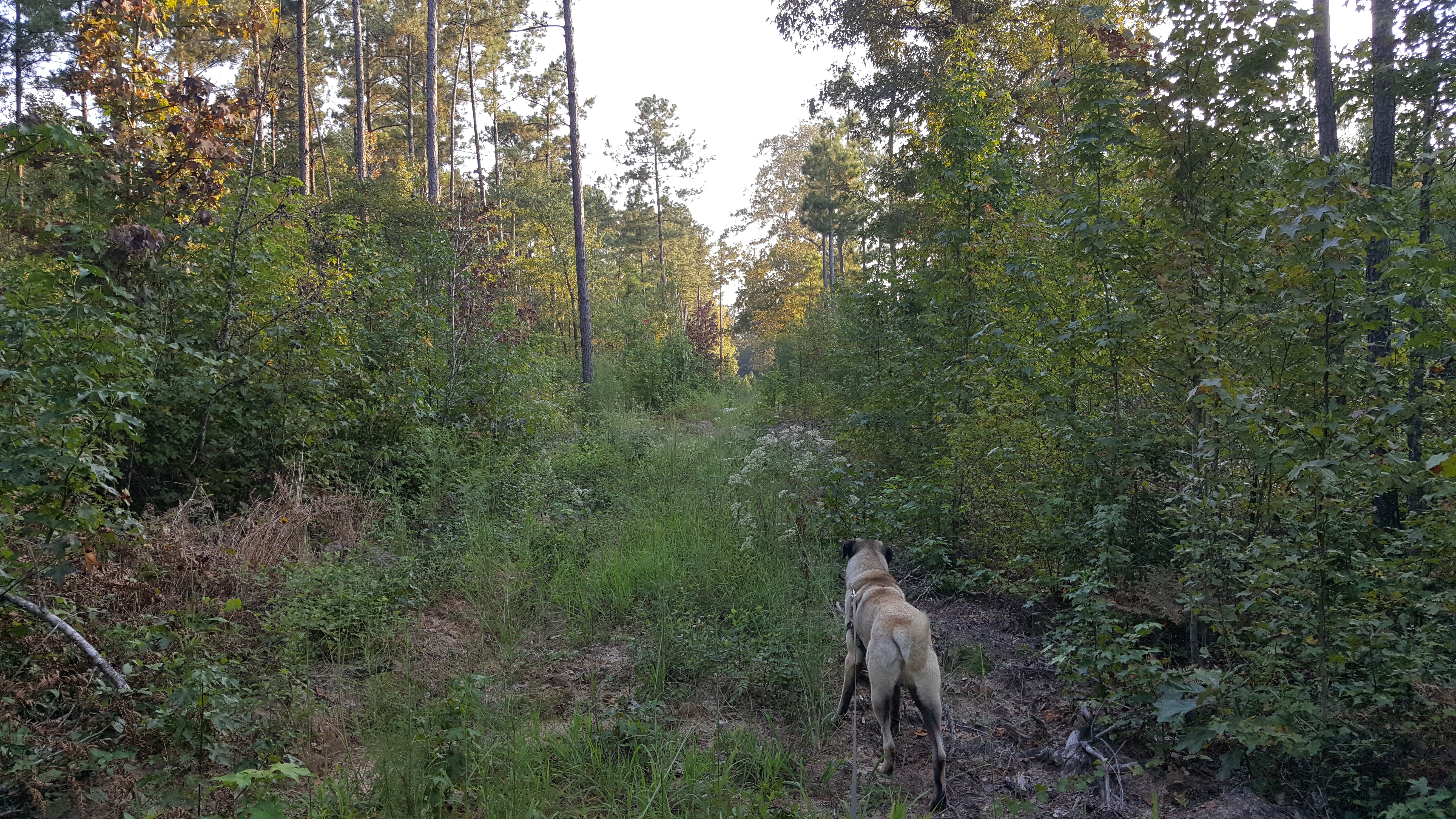

Here's an overgrown fire break. I could get through here on my existing tractor, but the sides are encroaching and getting to big.

Looking at your pictures you should DEFINITELY get a grapple. They are excellent for moving brush. However if you get a 60HP tractor you should be able to drive over all of the brush < 3" DBH and just cut it down.
