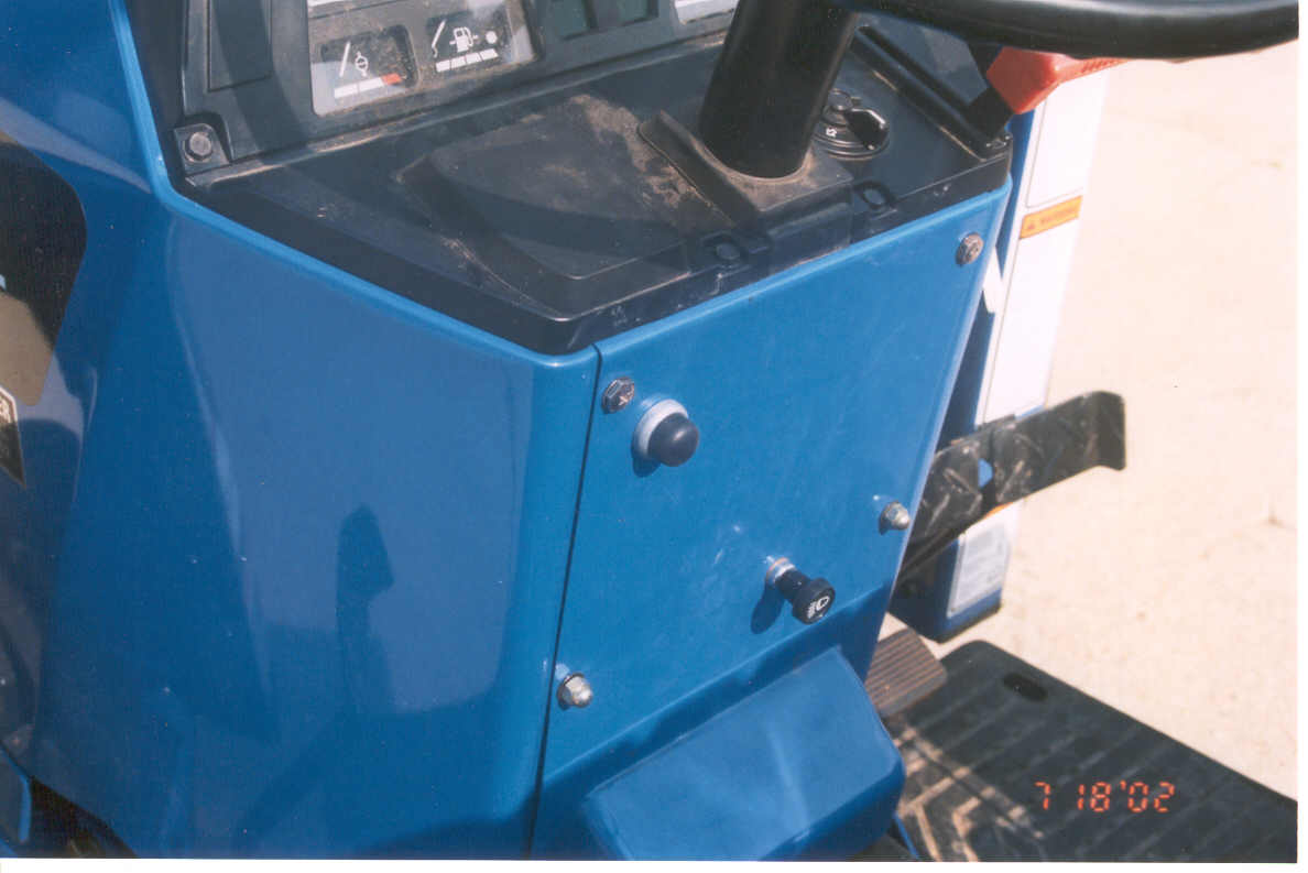

Here's my waterproof horn button on my TC30. I have a feeling it's the big ugly type you spoke of /forums/images/graemlins/frown.gif
It's the button on the upper left side of the vertical panel.

Jerry I would buy one like you have. All the local hardwares in this area have the heavy duty 30 amp starter buttons that look like you could mash them with the heel of your work boots and not do any damage to them. I need it for a horn not a starter motor. Where did you pick your up at?

I bought mine at a local auto parts store. I also believe I saw the same switch at a TSC (Tractor Supply Store). If you can't find one, I'll get you one and send it to you.

Jerry thanks again for the info. I picked one like yours up today at TSC. I am sure it will work fine.
