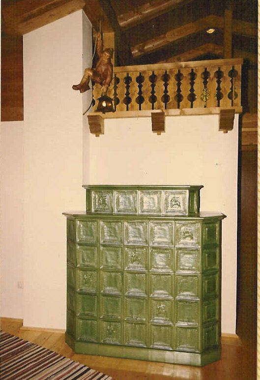

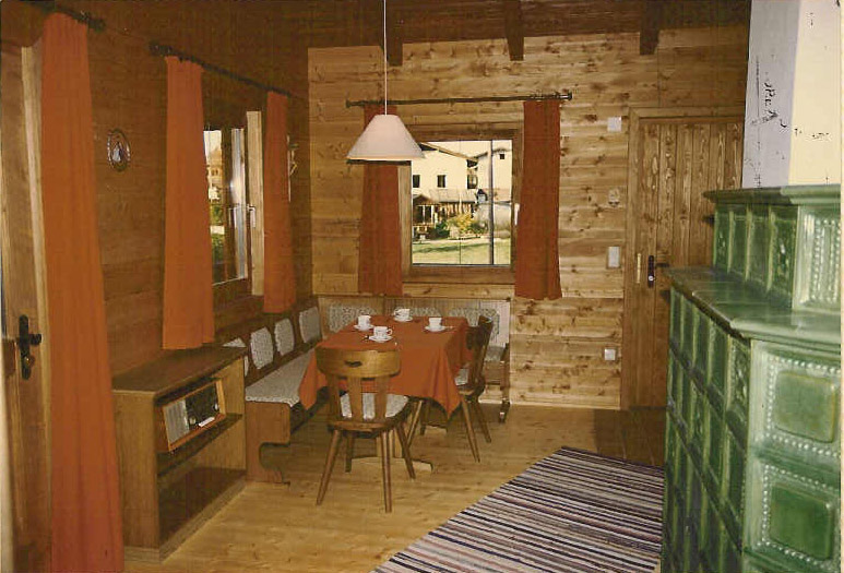

Scanned two pictures from the album. The quality is not the best with the old photos.
The masonry heater is shown in the living room and behind it is the steps to the basement where the fire box door is located... so the wood never comes into the living space and the fire box is raised on the backside due to the steps so no stooping to load the wood.
It is a very simple design and has worked extremely well and now always has a small bench in front of it making it a very popular place in the home...
The small loft above is carpeted and is always nice and warm... the kids love to spend time up there playing above it all.

those are beautiful, i can imagine they create a
very nice heat.
thanks for the pics and info
