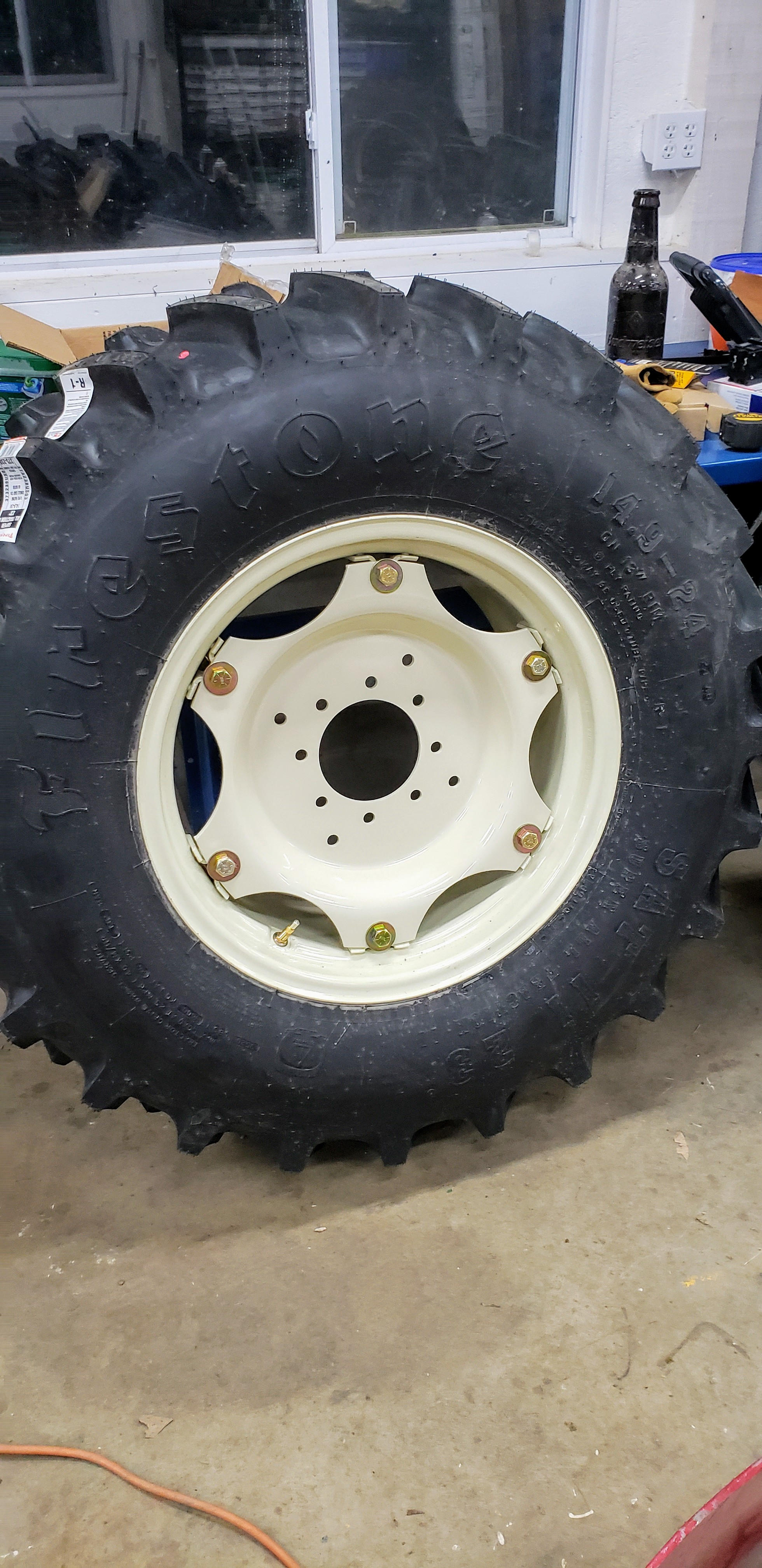

Well I finally got these on the tractor last night. The rims were not an exact match to the center plate bolt pattern and required the holes being slotted .090 outwards for the bolts to go thru correctly. The rims came powder coated IH white so I opted to paint the center plates to match since they needed painted anyways.

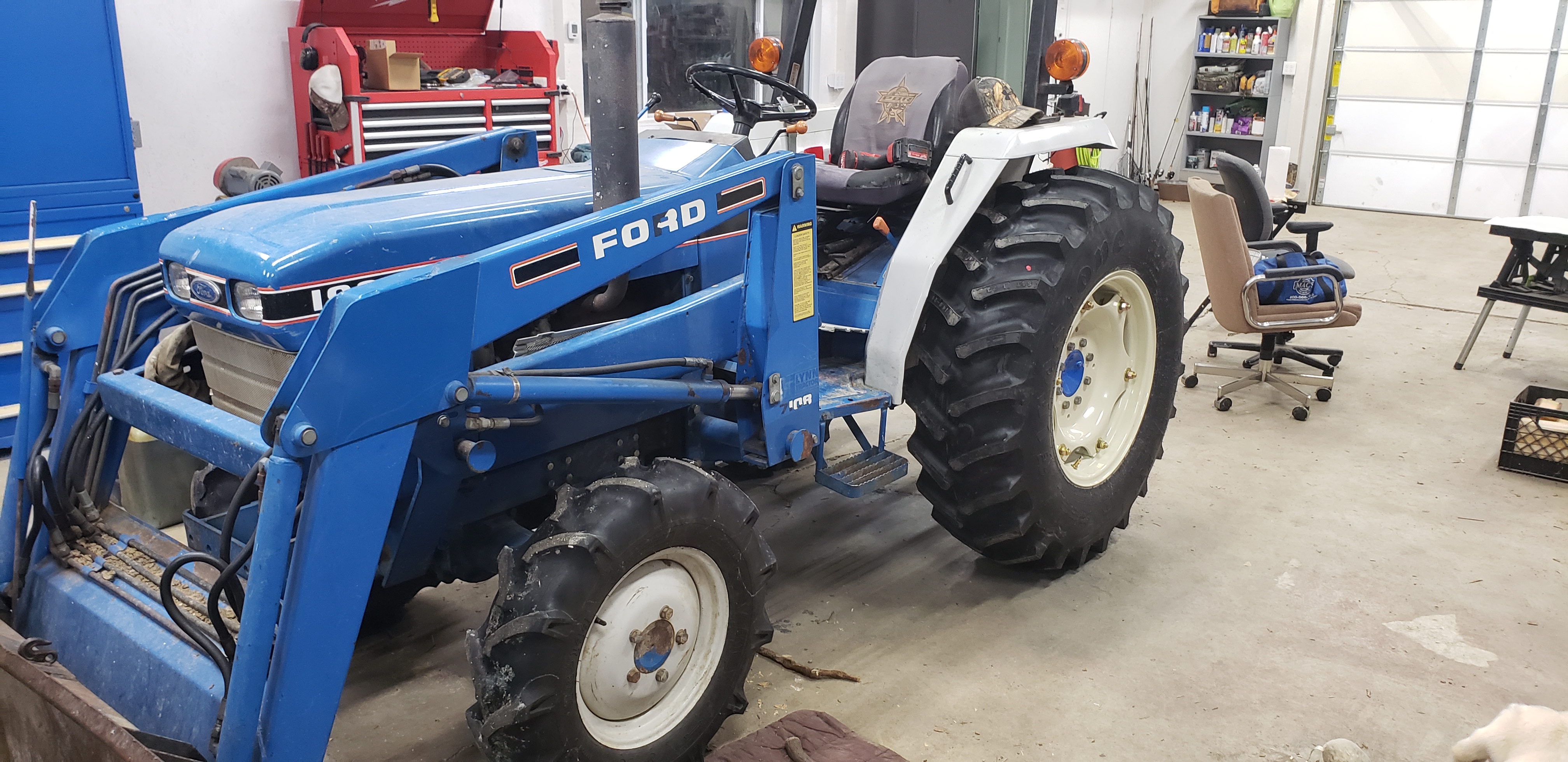

View attachment 591705View attachment 591706View attachment 591707
Looks like you have the 14.9 x28 tires.
I still have mine, but switched to 13.6 x28, and the 3pt stabilizer rubbing issue is gone.
Looks like the lower balls on your 3pt hitch arms might be quite worn.
I replaced the arms (about $100 each), though I could have just replaced the ball ends.
Great little tractor! Mine, with some new parts, and all new paint, really does look like new.

Did you change your front tires to the corresponding size as well since 13.6x24 are over 2" smaller in diameter than the 14.9x24?
Never had an issue with the stabilizers rubbing on mine, but I am religous about tightening them up after putting any implement on.
I agree it is a great little machine. My dad has a 1710 that I have ran a lot before i bought my tractor a few years back that I liked but the 1920 is so much more machine in every way it isnt even funny.
