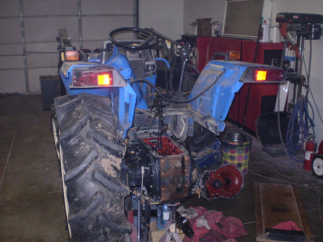

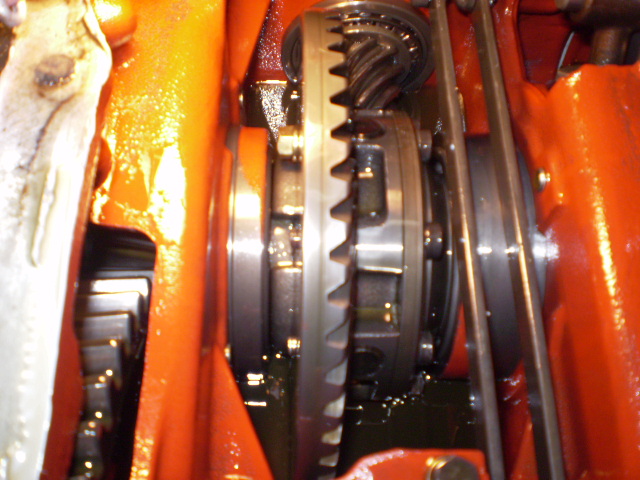

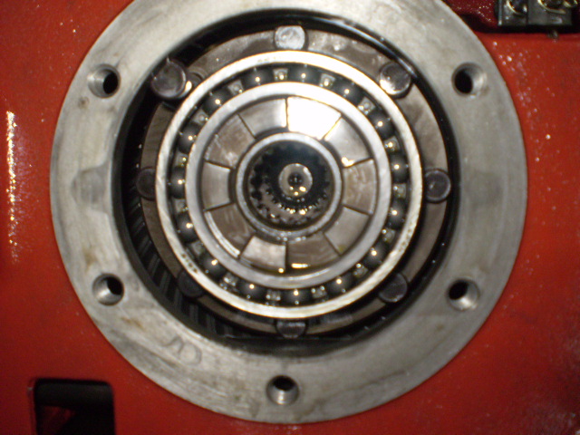

I finally am getting around to finding out what is wrong with my tractor . It appears i have sheared off 7 of the 8 ring gear bolts , I can only assume this was caused by some of them coming loose because I can find no other cause for it & amazinglly one is still in place & still tight .
I have yet to find anyone that carrys parts for this model of Iseki but I would have to think many other models would be the same . If any one knows where to find these bolts your input would be appreciated . I am also still looking for gears for the front drive axle .
Even as far as I have it tore down , I still cant get to where I can get the bolts out yet , but I will try to post pics of them once I do . I dont have a manual so I,m not sure if I will have to remove the left side axle assembly or seperate the rear end case from the main case or not . Any input about this would also be welcome . Thanks Bob

I have never actually worked on an Iseki, but it looks like the same design as most CUT's. You will have to remove both axle housings to to get the carrier out, but should not need to remove the differential housing from the transmission case. Looking at the pictures those ring gear bolts don't look to be anything special. If you remove the remaining bolt you can measure the bolt diameter and thread pitch, there will also be a number on top of the bolt head indicating the hardness. I would guess it is an 11, but could be a 9 or 13 too. Now that I said that depending on where they were sourced it could be 10.9 also. Any decent nut and bolt supplier should be able to get the right bolt for you if you provide them with the diameter, pitch, length, and hardness.

Howdy Al & thanks , Its going to be a few days before I can get the rest apart to get the bolt out , I grinched my back perty good removing the side case it was much heavier then I had expected . But Yep there a one of a kind bolt head , there just round & flat but have a half moon cut in them to fit into the curve of the carrier . but if I could find the right strenght bolt I,m sure I could machine the head down to make it fit properlly . ;)
Brian
Thanks Brian , thats what I was kind of afraid of so I apreciate you clearing that up . Being made in japan its hard telling where the bolt was made but I have yet to find any markings or numbers on any other bolts let alone gears , so it may be a guessing game . I will post more though once I find out for sure . I,m glad to here I probablly not have to seperate the cases though :D . Thanks again guys . Bob

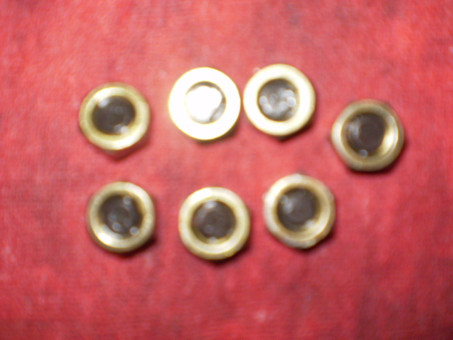

I sheared all my bolts on my front differential a couple of years back.
Front was easier to dismantle.
What I found was that the factory used metal clips with tabs to lock the bolts in place.
Jerky movements caused the tabs to open and the bolts unscrewed themselves.
I always questioned if they were ever torqued correctly.
I purchased the highest grade metric I could find and drilled the heads to safety lock wire them as well as used lock-tite.
That was 4 yrs ago.
It did cost me a crown and pinion set however. Ouch-costly!
Good luck, you'll get 'er done!

Thanks for the input PILOON , Yes that does sound costly . If it wasn,t for that one lonely bolt holding on I beleive I would have been in the same boat . Glad you got yours up & running . ;)
By the length of the broken bolts sticking past the ring gear I have no doubt being loose caused them to snap . If I am ever able to remember how it goes back together they wont come loose again :D

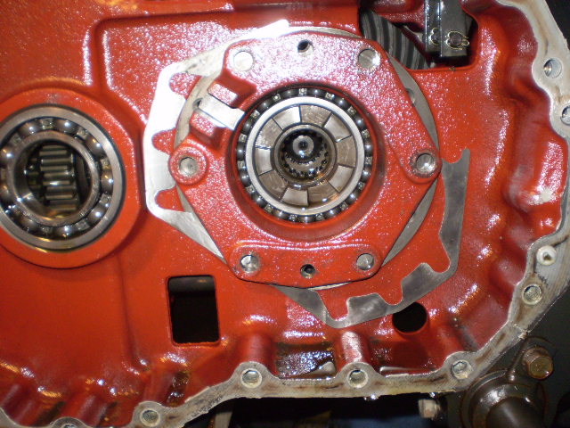

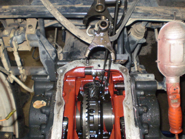

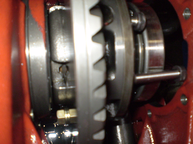

I figured I,d update . The bolts are close to coming out the carrier bearing hole I still had hope of not having to tear down the left side , but they miss by a hair of coming out . Also found the other two nuts & the bolts are broke off in them as well & none appears to have been loose as they all are broke exactlly the same .
Headed out to tear the left side apart , Hopefully I,ll be able to post a pic & measurements of the bolt thats not broken soon . Thanks for looking , Bob
