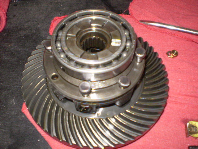

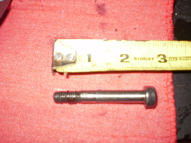

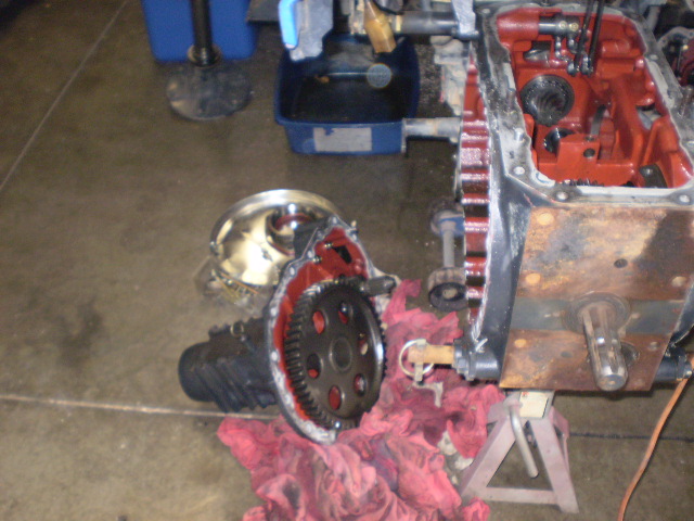

Thankyou Darryl for Your time researching and the link . I have been searching for a couple of years for that type of info on the web , I knew there had to be something but had no luck finding it . So in short " You da Man " :D . I have looked through all of the pages on the 1240 & printed perty much anything I will ever need from front to back .
I wouldn,t say its just close , it looks to be exactlly like my Iseki other then some of the body parts & electrical / cellenoids for the 3 point . At least I have something to go by now . I,m not sure what good the part #,s will do or who I can order them from but those look to be the exact bolts I need & I also found all of the gears I need for the front end . All I have to do now is see if I can buy them . Much further ahead then I was though so Thankyou for that . :thumbsup:
I got the rest of it tore apart yesterday & now have the center section out on the bench , the only thing I can find wrong are the 7 sheared bolts , so with this info it looks like I will have a shot at saving it as well as being able to put it back together . I,ll update when I find more out . :)

I thought I would update this . I decided rather then taking a chance of getting the wrong bolts from an online place that gives no description on bolt specs I would go through my bolt stash :D .
I found what seems to be the perfect solution . Eight grade 8 , 5/16ths bolts that the threads are were a 1/4 inch to long , shoulder length is perfect , I cut them off using a die grinder chased the threads & they actually fit more snug in the carrier and ring gear then the originals . The hex heads fit perfectlly to keep the bolt from turning & i installed nyloc nuts with no lock washers . I'll get some pics before I drop the unit back in & start putting it back together .
It looks much stronger now then if I would have used the same bolts that were in it before, plus I still haven't spent a dime in the repair . I hope to have it back together & in operation in the next few days if all goes well ;)
