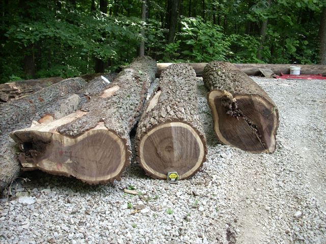

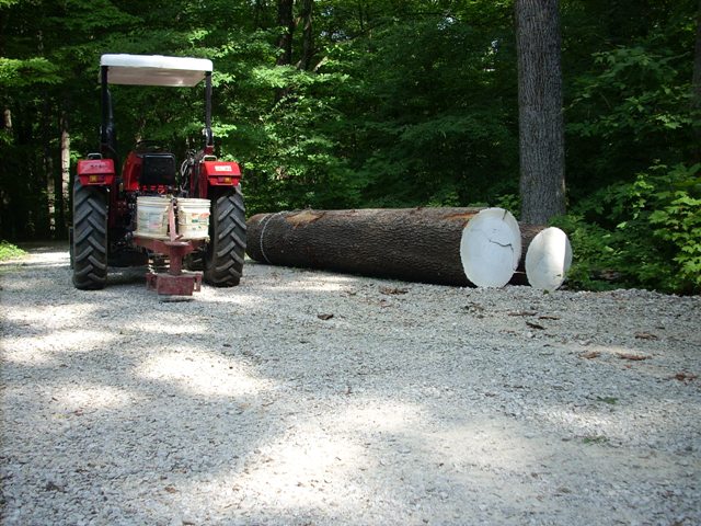

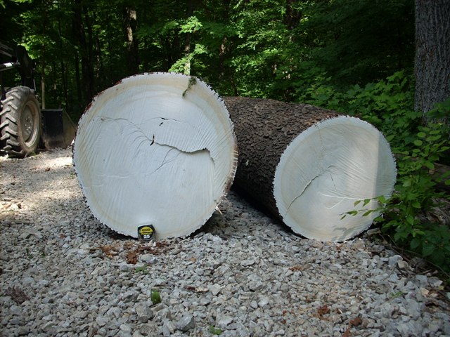

I finally got the Cherry dragged out of the woods. Not an easy task even with my 45Hp 4x4 tractor. I had to cut about 4' off the but log to remove most of the rotten center. I'm glad that was as far as it went. I did get a price from a friend of a friend, $65/hr. He is a carpenter by day. Not sure if the price is good but, with out knowing how fast he can cut....The $65/hr compared to 25 cents a bd-ft, is 260 bd-ft/hr.
I will have a lot of work moving, sticking and stacking. I plan to weight down the stacks with concrete blocks to keep it all flat.
How long can the logs sit before I have them cut? I have applied a coat of paint to the log ends to slow the drying and checking.
See photos. The Cherry shot has a 25' tape measure at the bottom for size ref.

The pile is growing. In the photos, there is one Cherry and one walnut. I have 4 more walnuts to drag up and the Cherry had 2 branches. Those branches were 12' long and about 20" dia. Beyound that there are several decent 12" dia Cherry logs.
