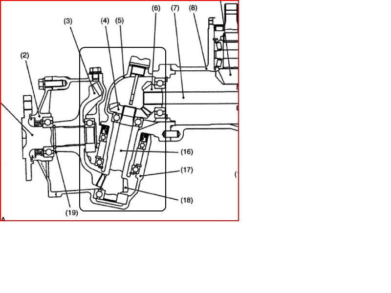

Attached is assembly drawing for hub on a BX. Hope this helps.

It is hard to explain where it is leaking since I don't know the proper terminology, but I have attached a jpeg from RDS's pdf with the part circled that is leaking. I need to clean up the axle and dry it up and try to get a good look at it to see exactly where it is leaking, like from the bottom or top, etc.
The axle itself I was surprised that I was able to put a little pressure on the tire itself and see the complete axle shifting back and forth as much as it was. It seemed like allot. So tightening up that center bolt should fix that then? This is common I guess? You can feel the axle shifting when driving it. It almost makes a clunk sound when it shifts.

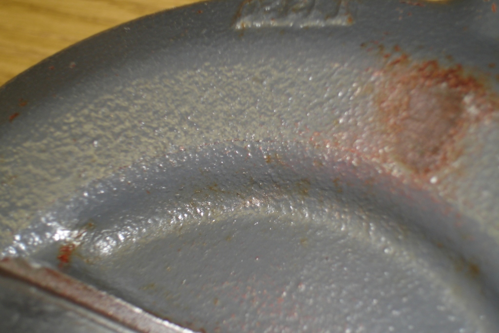

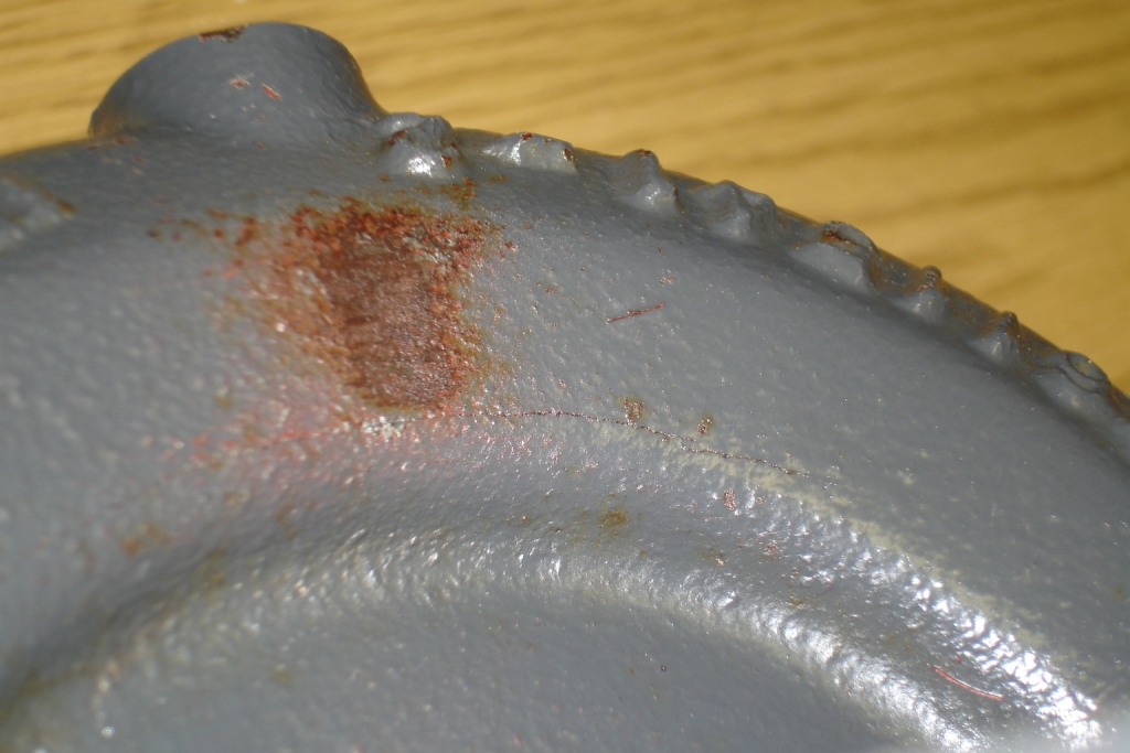

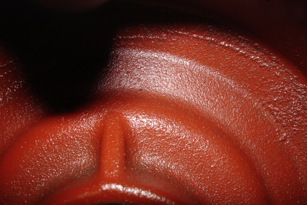

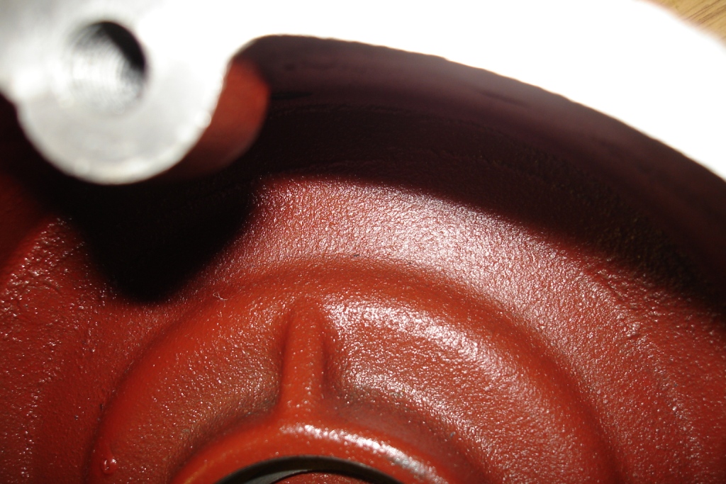

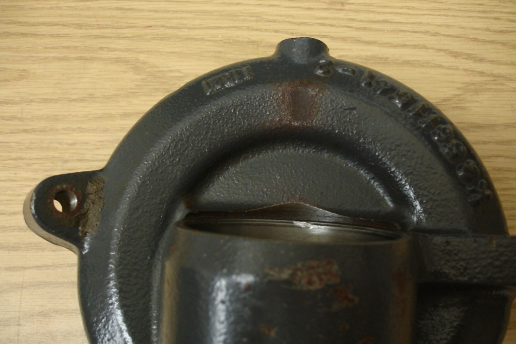

Izicc,
The area you circled was where my leak showed up. Started small, but got bigger to the point where there would be a good pint on the floor each morning due to the crack getting bigger. The oil seemed like it was coming from the seal (see attached, part 050 on the diagram of page 86). Even the dealer thought it was just the seal, and in fact replaced it 3 times before giving up and sending it home.
It took some time to get really bad, but eventually it did. Some really heavy lifting help to speed the process :D.
But as you will see by looking at the pictures, it was definately a cracked casting. I wasn't sure where the problem was when I got ready to tear it apart, so I ordered all the bearings, seals, and the bevel gear casting (of course it turned out to be the drive gear casting instead..:mad:)
Picture 1 is one end of the crack.
Picture 2 is the other end (kinda hard to see in this picture, but it runs all the way down to the left side of the picture following the curve of the casting).
Picture 3 & 4 are the inside of the casting. If you look just left and just right of the center of the pictures you can see to black spots where the casting had chipped away. Zoom in on those spots and you can see and follow the crack from one side of the picture to the other. It was hard to see initially, but the black spots clued me in on where the crack was on the inside.
The last picture is to give some perspective on where the crack is on the casting. In fact if you look to the left side you can get a better view of what picture 2 was trying to show.
