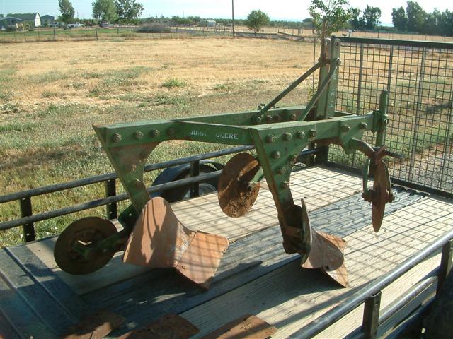

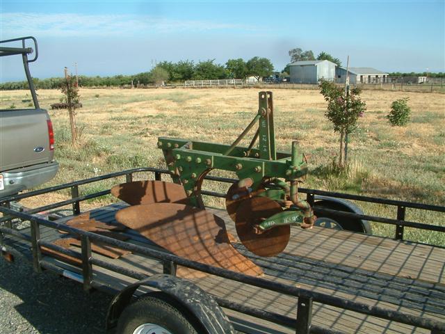

Here's my $200 JD 2-14 plow that I bought off craigslist a few years ago. The plowshares and coulters are in pretty good shape.
The 3pt hitch on this particular plow was shot--wouldn't hold an adjustment. So I had to weld up a replacement hitch.
Check that plow you're eyeballing carefully--you may run into a similar problem.
