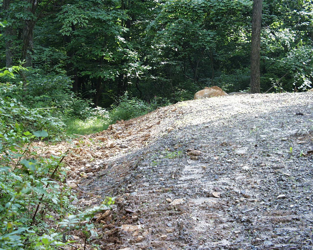

Seat Time's Update:
I called my neighbor on Saturday around lunchtime...his answering machine picked up so I left a message that I'd like to meet and chat about the job his contractor did on the septic. So far he hasn't returned my call. I'll try again today from work.
I have a couple of pictures now...this'll be my first attempt at adding pics to a post. Fingers crossed...If these take alright I'll add a couple more showing the other property line.
The first pic with the split rail fence shows the septic mound in the backround. The fence is mine and my intention is to re-fence about a foot inside my property line, which would put the fence about ten feet to the right. You may be able to make out a wooden survey stake with orange tape in front of the big boulder. There is also tape tied to the branches above.
The second pic is taken from the same end of the mound...I just walked around the boulder from the first pic and shot down the same angle/direction. You may be able to see a wooden survey stake at the end of the mound. Essentially, the property line runs right about at the edge of the "flat" top of the mound...maybe just a little down the slope from the "flat" top.
Maybe I'm making too much of this as when you look at the pics it doesn't seem too bad...
