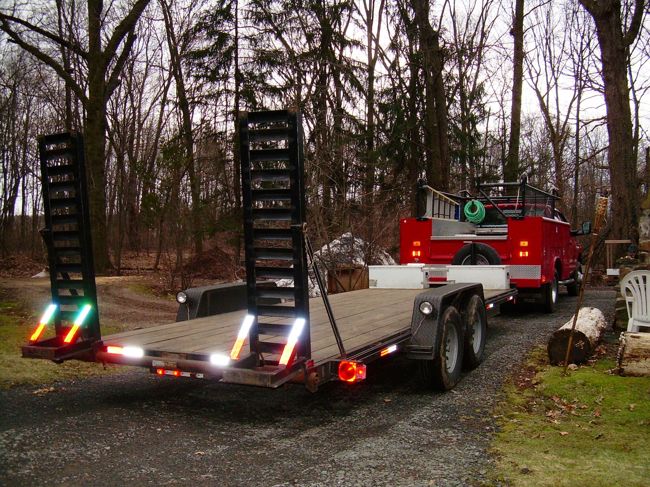

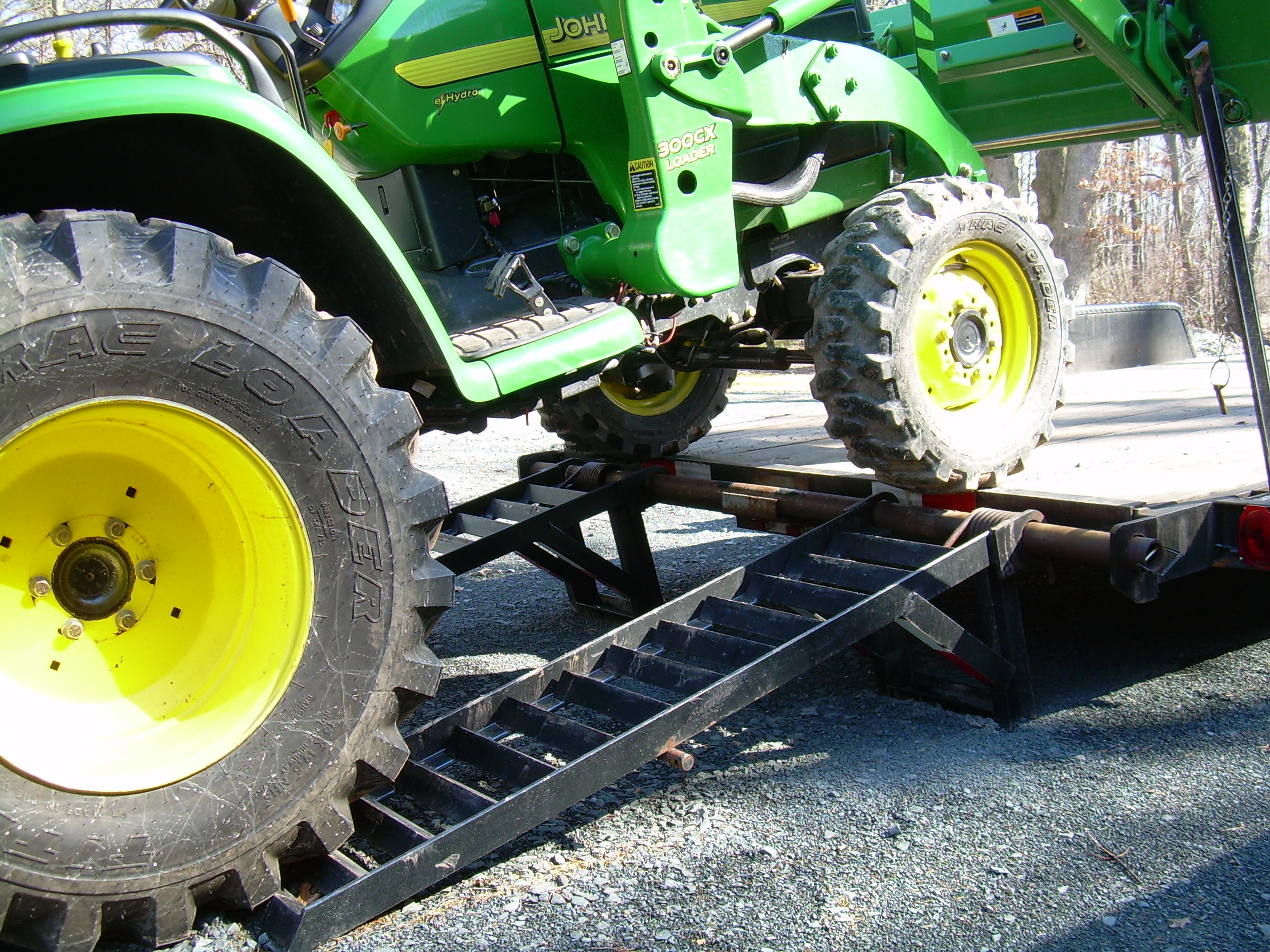

That might be easy and quick if you have HST, but 5 sec to shift and pop the clutch with out pulling a wheelie as you roll backwards downhill:confused2:
I agree, if you were far enough back to lift the truck off the ground, better off to keep going, especially if the rears were on the ramps. reversing direction from that position in a hurry could cause undesirable front end climb.
Couldn't happen to me cause first of all my truck is to heavy, but also I have the stands under the ramps, don't know why all ramps don't have them. I can load the trailer with out it being coupled to the truck.
JB.
