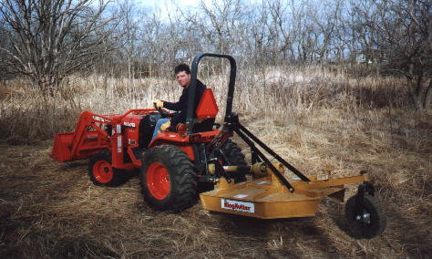

Not to gang up on you since I do have an orange garage queen. I am sorry to say but a finish mower has no buisness where hogs hardly even break a sweat. I accidently ran over an eight inch stump I had cut last year with my Sthil. It was covered in weeds and Sumac and brambles. It stuck up about six inches. I backed my KK hog into the weeds to cut them and kabam--like as in a really loud KABAAAAAAAM. The tractor shook, the hog jumped sideways and then started going katwhap--katwhap. I was somewhat miffed at all the commotion not remembering the stump was there and so I pulled out and then for an encore of course I stupidly did the same thing again. Well, the hog is fine, I guess the tractor is OK and the stump--it ain't there anymore. So, just my humlbe opinion but your 30 horsepower "lawnmower" is just that--a lawnmower! It becomes a brush/stump/tree eating 30 horse hog when you put a cutter on it, till you do it is just a lawnmower being abused. Better watch out, I will call the Society for Prevention of Cruelty to Kubotas on you and then you will be sorry /w3tcompact/icons/wink.gif . Oh, I think I could buy at least three and maybe four KK hogs for the price of one Kubota belly finish mower with change left over. J
