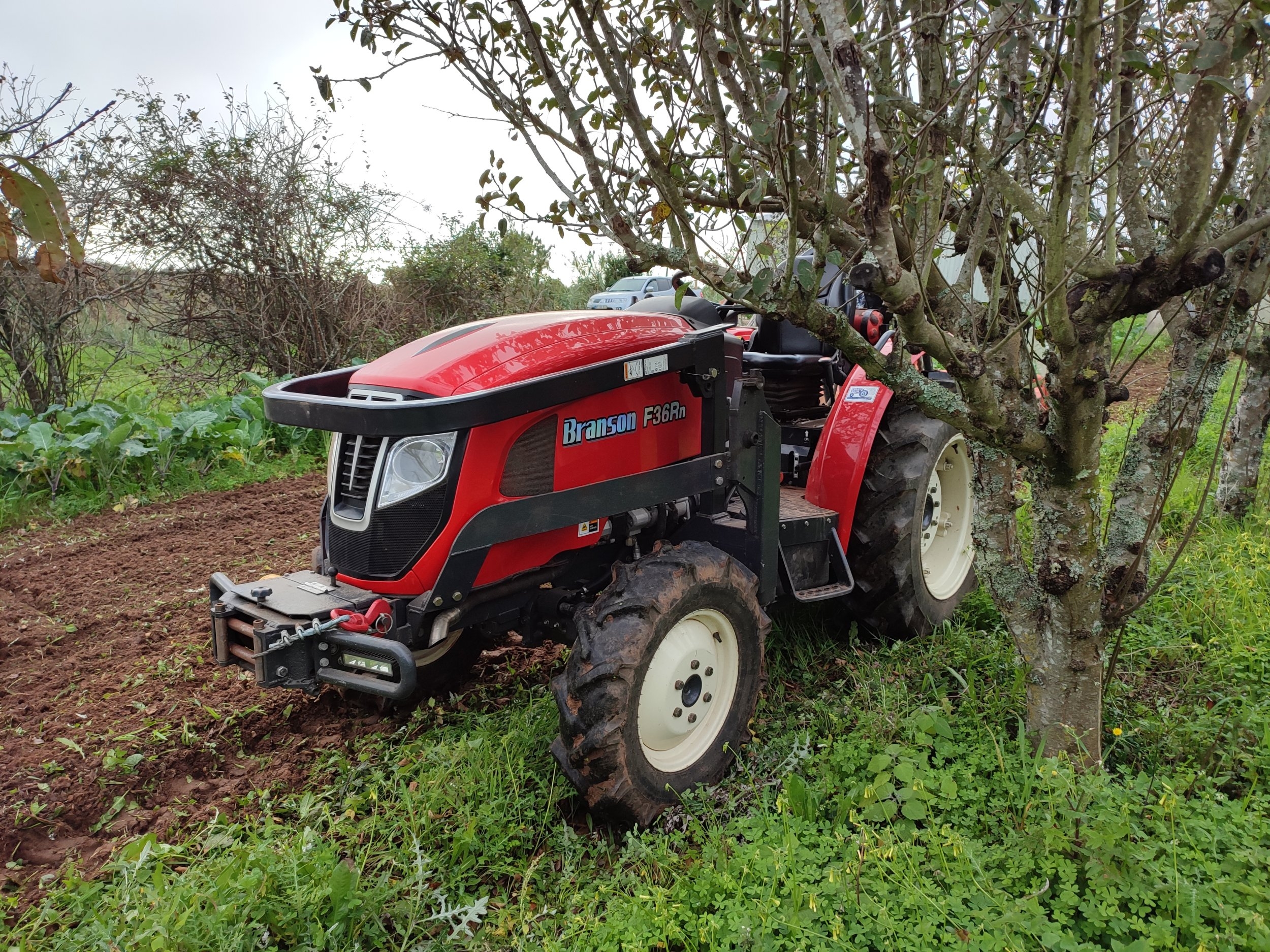

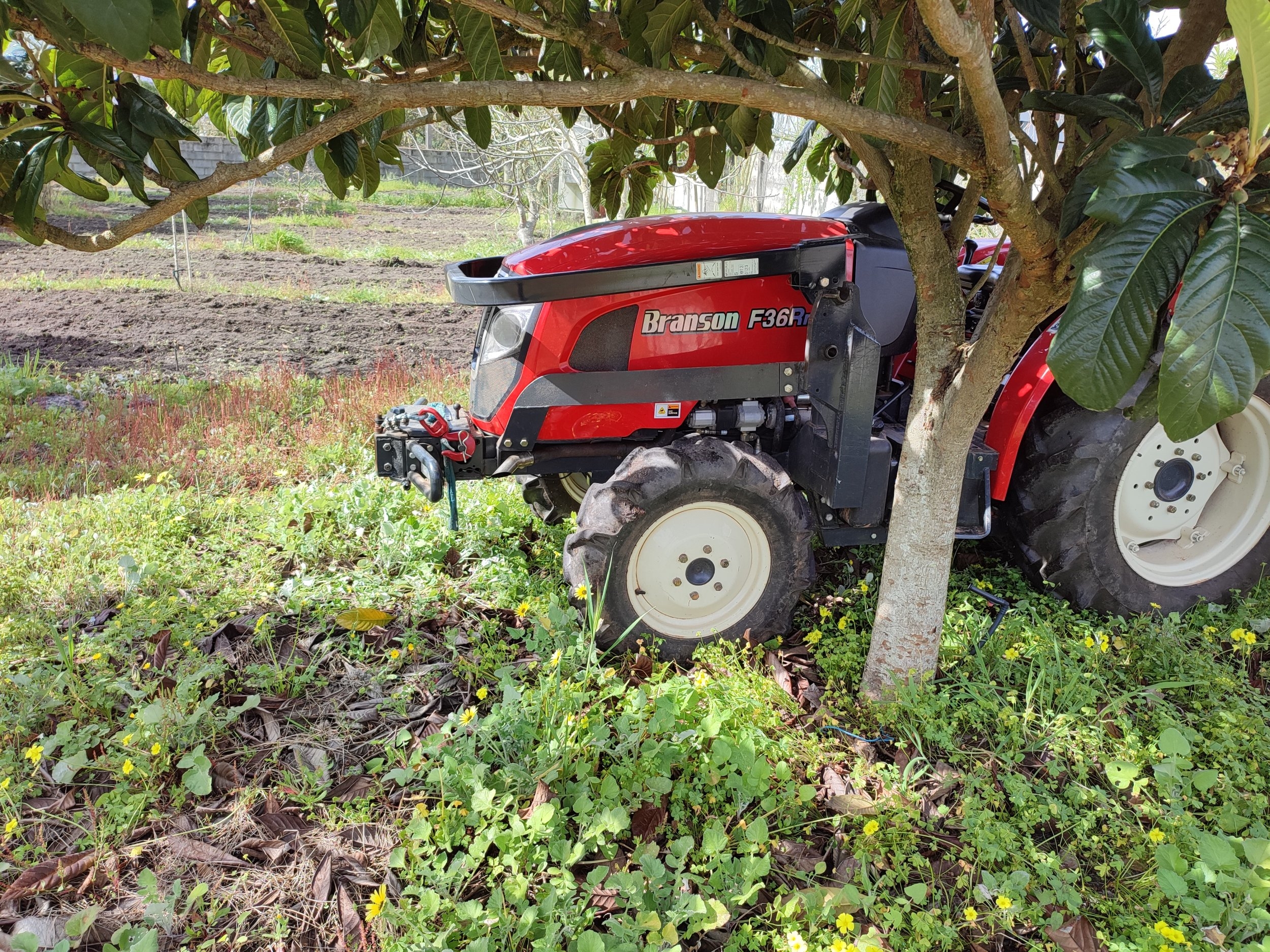

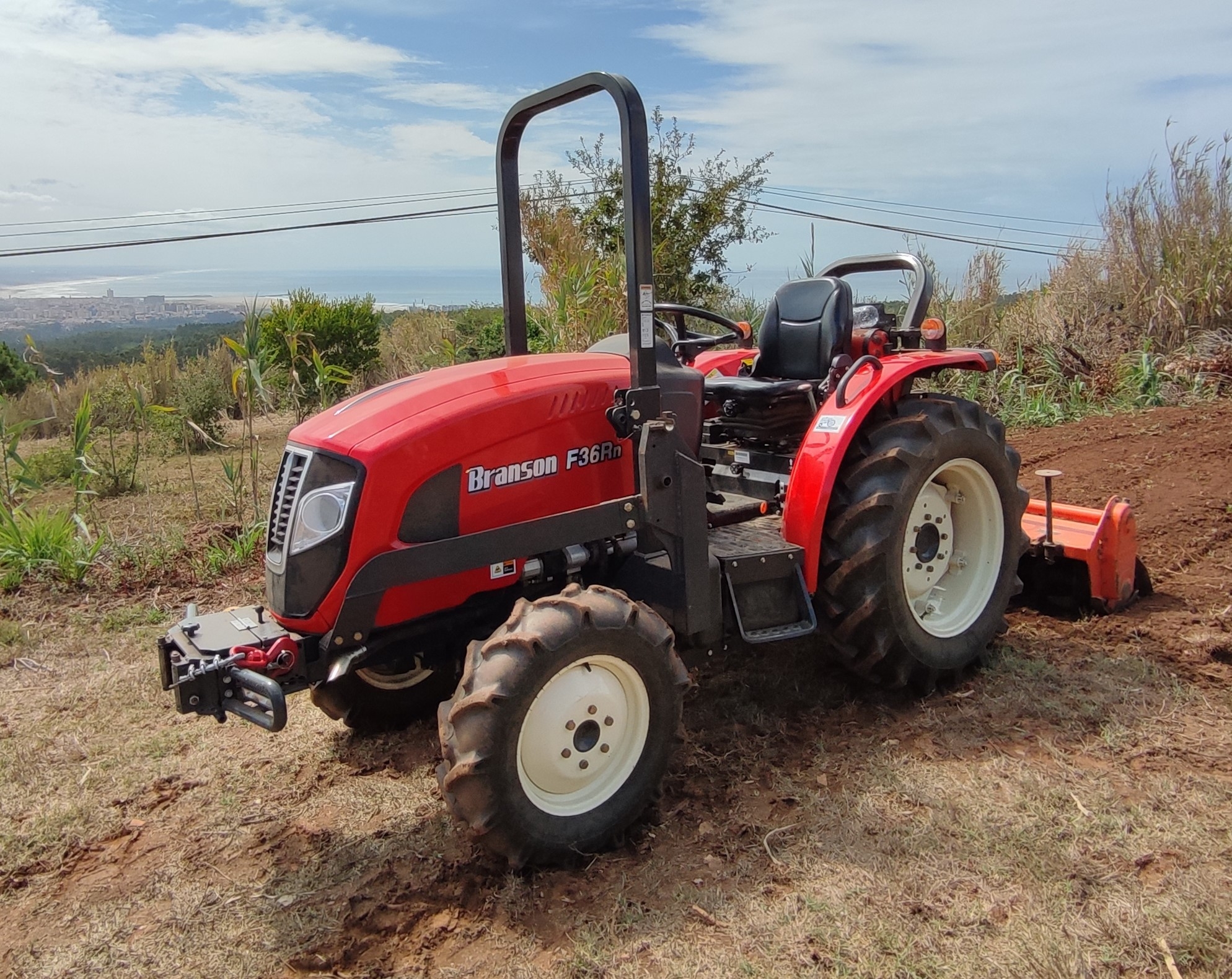

They do. It's called mid mounted ROPS and I wouldn't want a tractor without it. Those are mostly offered in orchard/vineyard tractors because when folded, it makes for a really low profile.
The only con I see, is that on some models, you have to lift if to open the hood. Not really a big deal, specially since 2018-ish, all mid mounted ROPS in Europe have a gas strut to aid lifting. You can literally lift it with one finger. Branson actually updated the hood design to correct this minor issue with this style of ROPS.
Other than that, you won't get a ROPS to bang your head when hooking implements, also it's within your view range, so you tend to be aware if you're going to hit something.

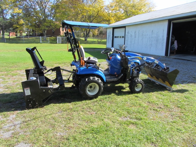

I need them up for the three canopies.

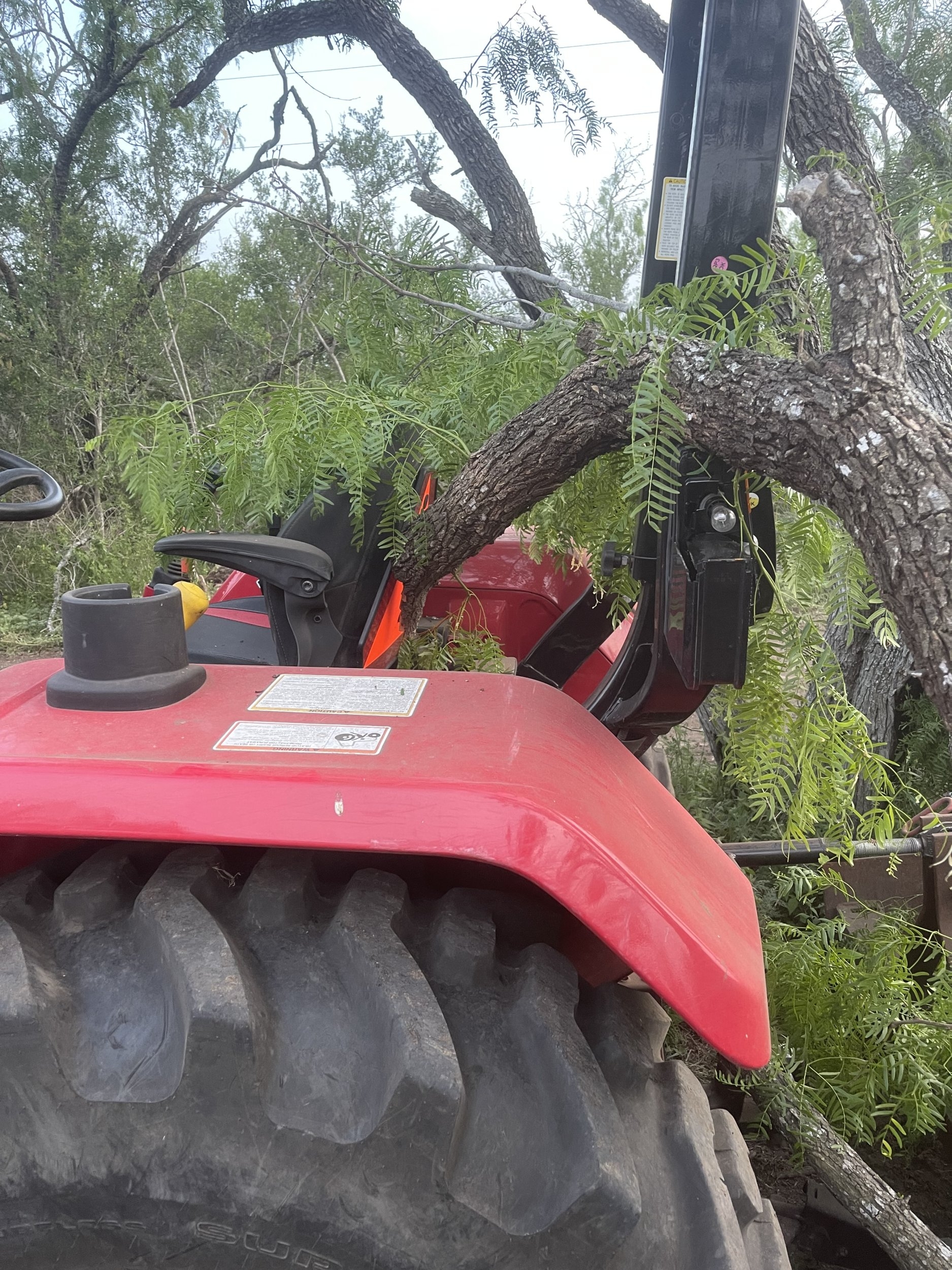

no this is what it looks like after a branch smacks you
