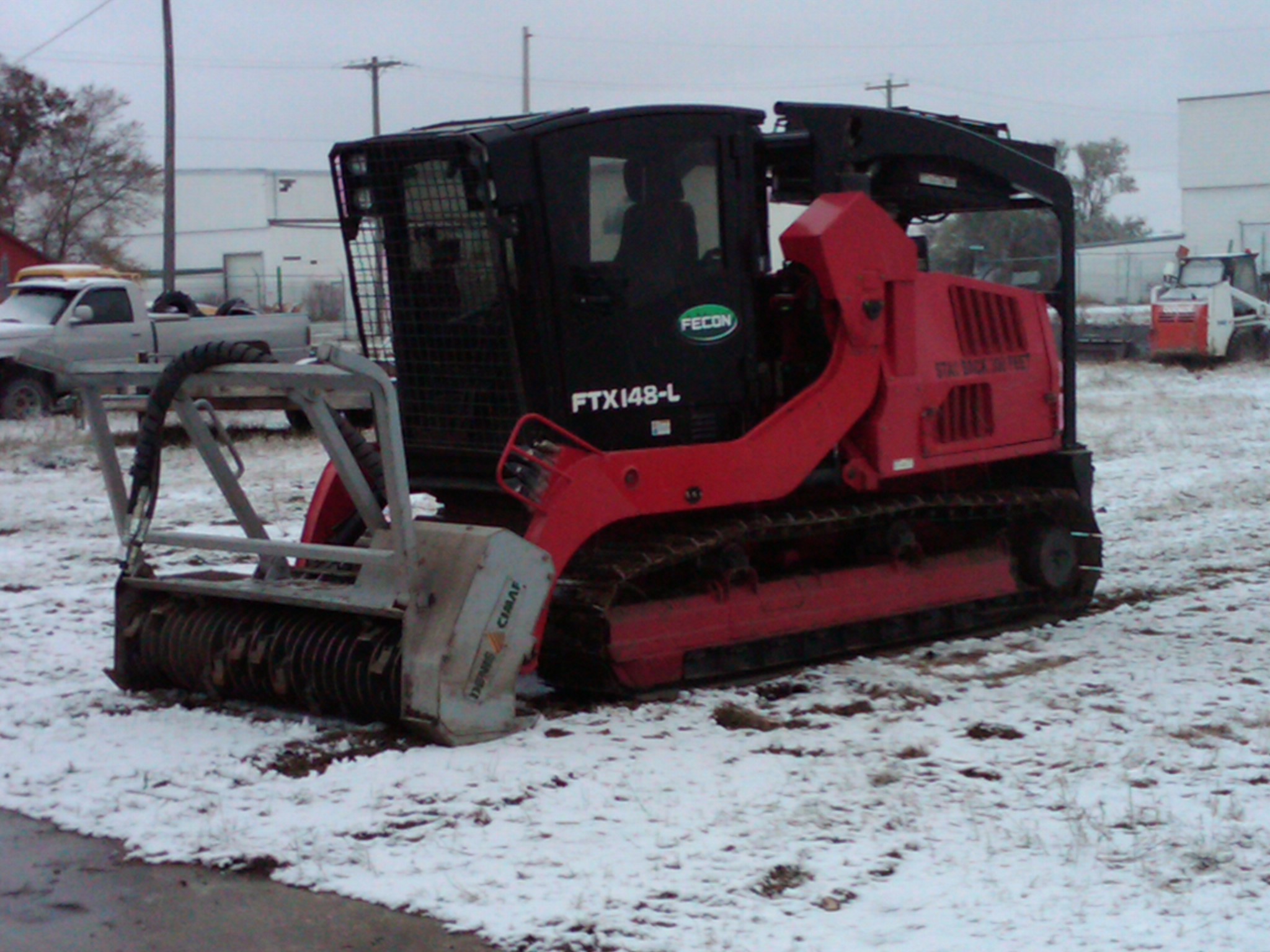

So on paper it makes the tractor better than the competition I suppose. The numbers sound impressive though. I guess that's the point. Not only is 140 HP not enough to pull that kind of load but the tractor must soak up at least 25 or 30 HP to move the tracks and hydraulic cylinders. I'm not knocking the 148 by any means, I would like to own one someday. Does anyone know if the 148 uses a two speed hydraulic motor to drive the head? I heard that they make a difference.
   / New 148 Pics and a Video Link. #48
I know Fecon is on this site so I imagine they can give a better explanation as to why its rated that way I asked before and was given a explanation but i don't want to butcher it and give the wrong idea. I ran a direct competitors machine for around 23hrs and I settled on the 148 its here now just waiting for the BH85 its coming from Ohio (on its way now) and some couplers to mate my Cimaf 180D to it. The 148 is undoubtedly a purpose built machine vs a modified skid steer, and I have no doubt it will serve me well. Yes Robbie I'm posting pics with the 180D on it as soon as I can that should make you drool. :D

I agree it is a good machine. I like the steel tracks better but that my opinion. With the power of the 148 I think the days of stalling the rotor are gone. Happy Mulching. You have to get Gilles to come a tune her up!
   / New 148 Pics and a Video Link. #50
now THAT is a good looking 148
I agree on the carrier quality....I am a big fan of the 148...just not the head :rolleyes:
