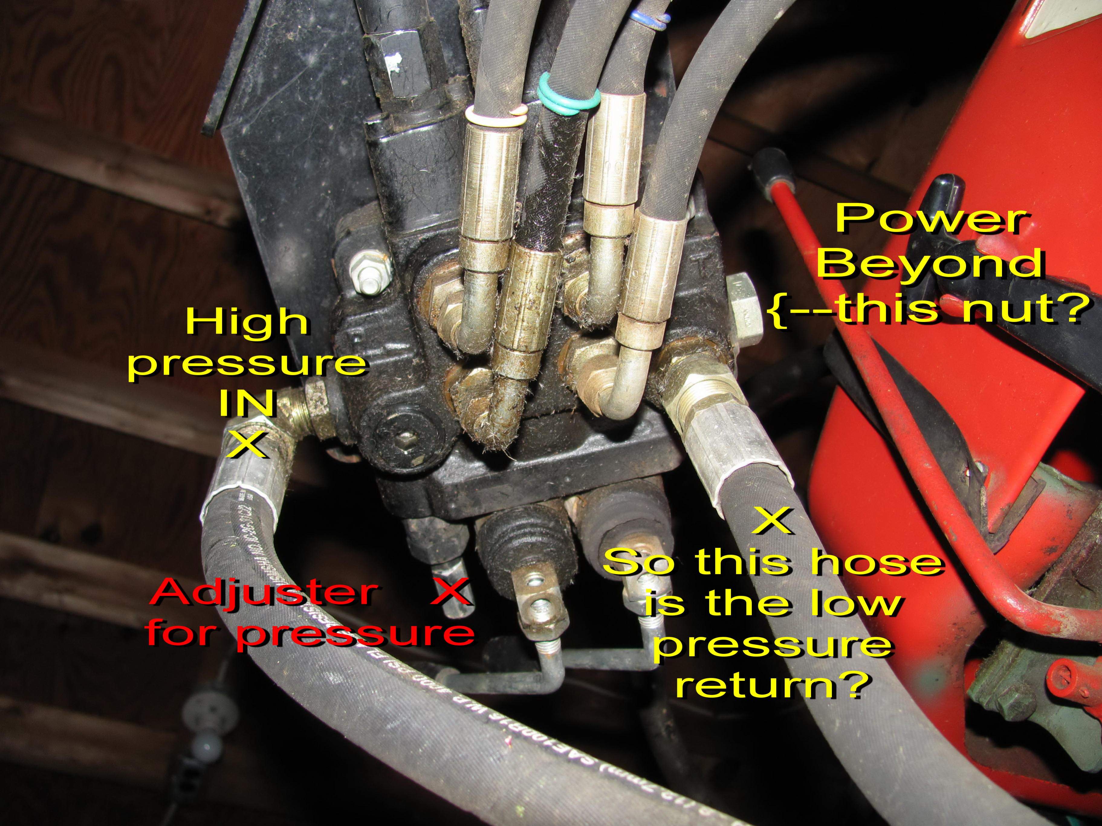

Someone else is havin' the same problem as me....tryin' to figure out how to connect a grapple....I just printed out the pic of his valve.on my B/W Laser Printer... I can say that mine wasn't connected the same way.... but somewhat reversed....
so I guess I still need someone to draw a picture or a sketch to how my system must be connected..if I connect mine the same as this OP my system I should be okay as the valve looks to be a 2 spool type like the one I'm using...I'll post the photo....
if the OP won't mind :D ... now where the return X low pressure hose is connected this is what I had plugged.... the right side with the plug (marked is this the PB port....
is where I was told to connect my PB fitting and was connected by 2 wire hose into the other cut steel line (return) into the rear axle of the tractor.....the pressure line from the pump was not connected to the left side....
but to the top inport where the pic posted shows it bein' plugged...so maybe this caused my valve to blow out the casting....they exchanged it for a new one...but I'm not connecting this new 2 spool valve it till I get the exact proper info.. .Thank You....Ampa <>

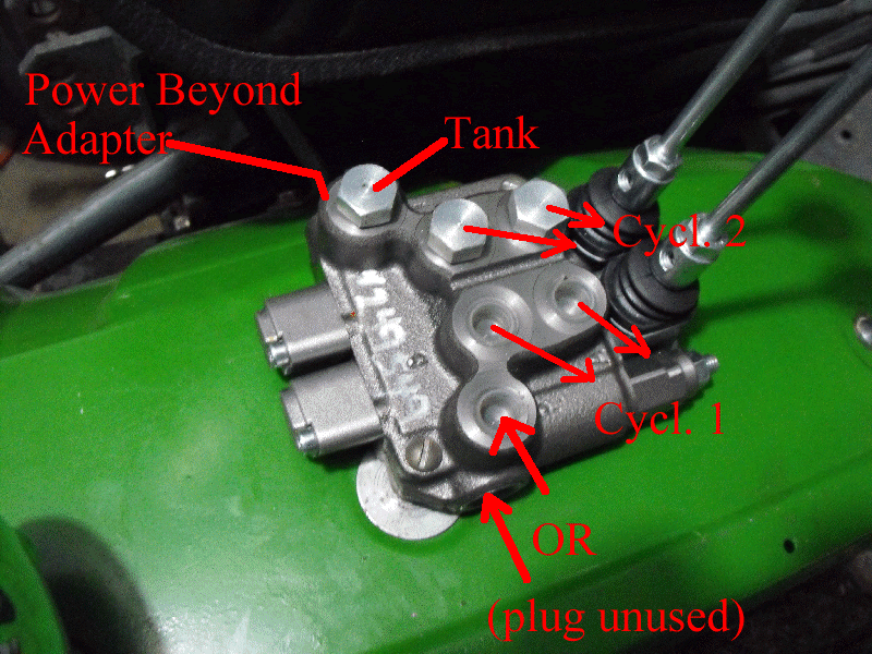

I borrowed (stole) this image from DonnieP (hope you don't mind) post. It shows all the ports that you need to use and where they go. Just as JJ reminded me several times not to block the return (tank port) it must be routed back to the transmission. On my tractor I had to use the transmission oil fill hole for the return line. You may have another way to get the return line back to the transmission but if you don't then the fill cap may be the only way. As JJ says, "DON"T BLOCK THE RETURN PORT" :D cause it causes things to break.

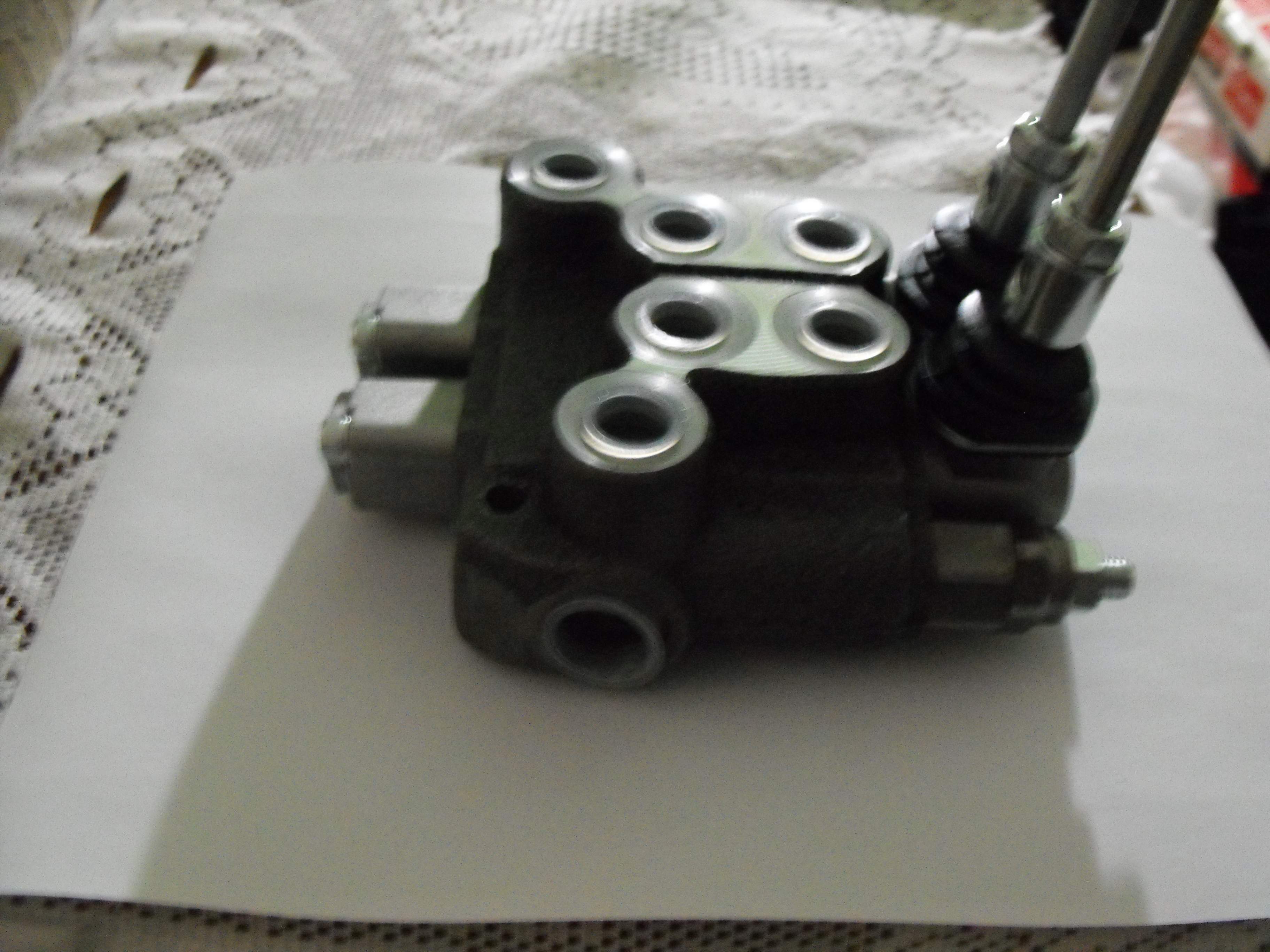

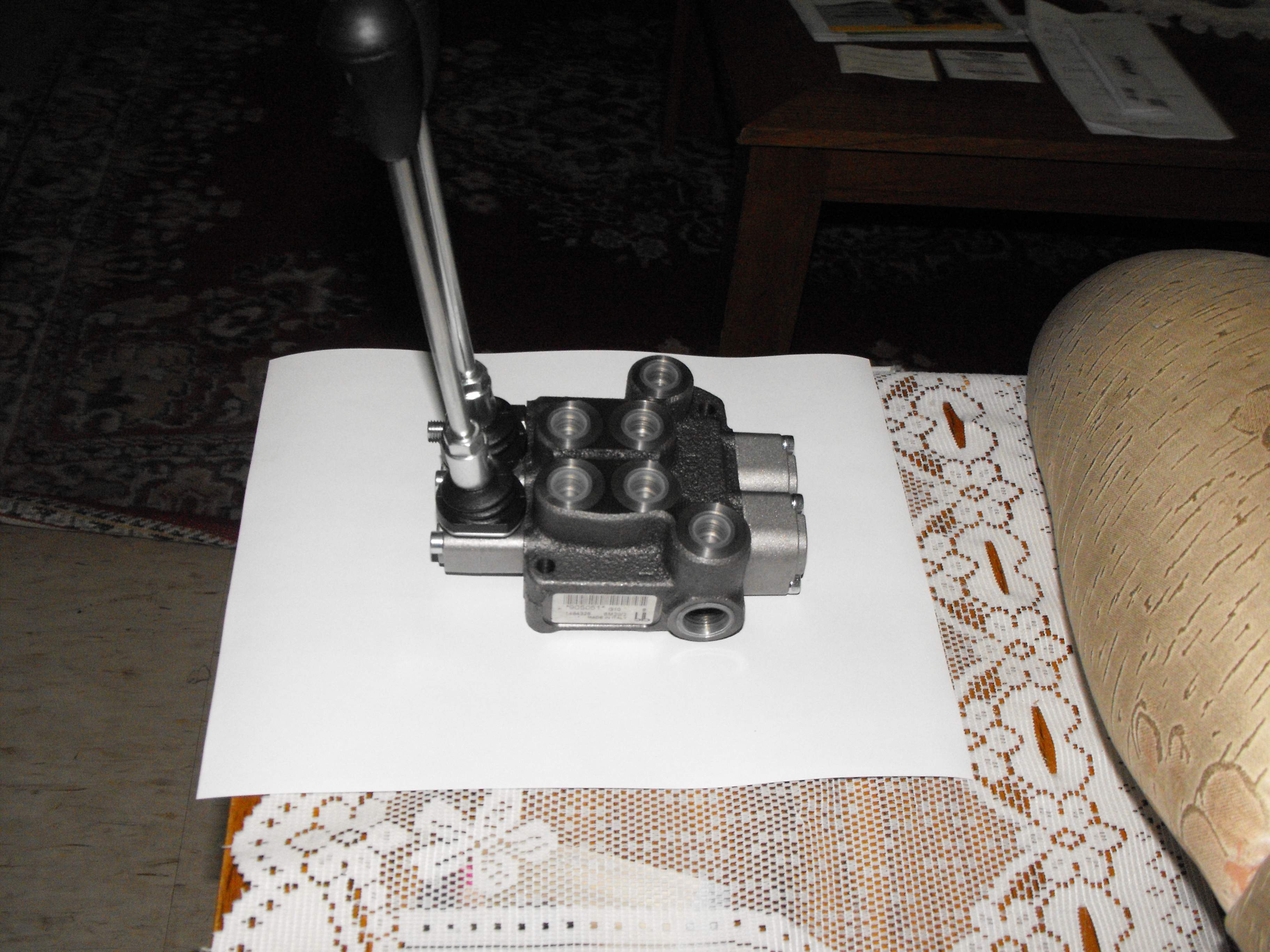

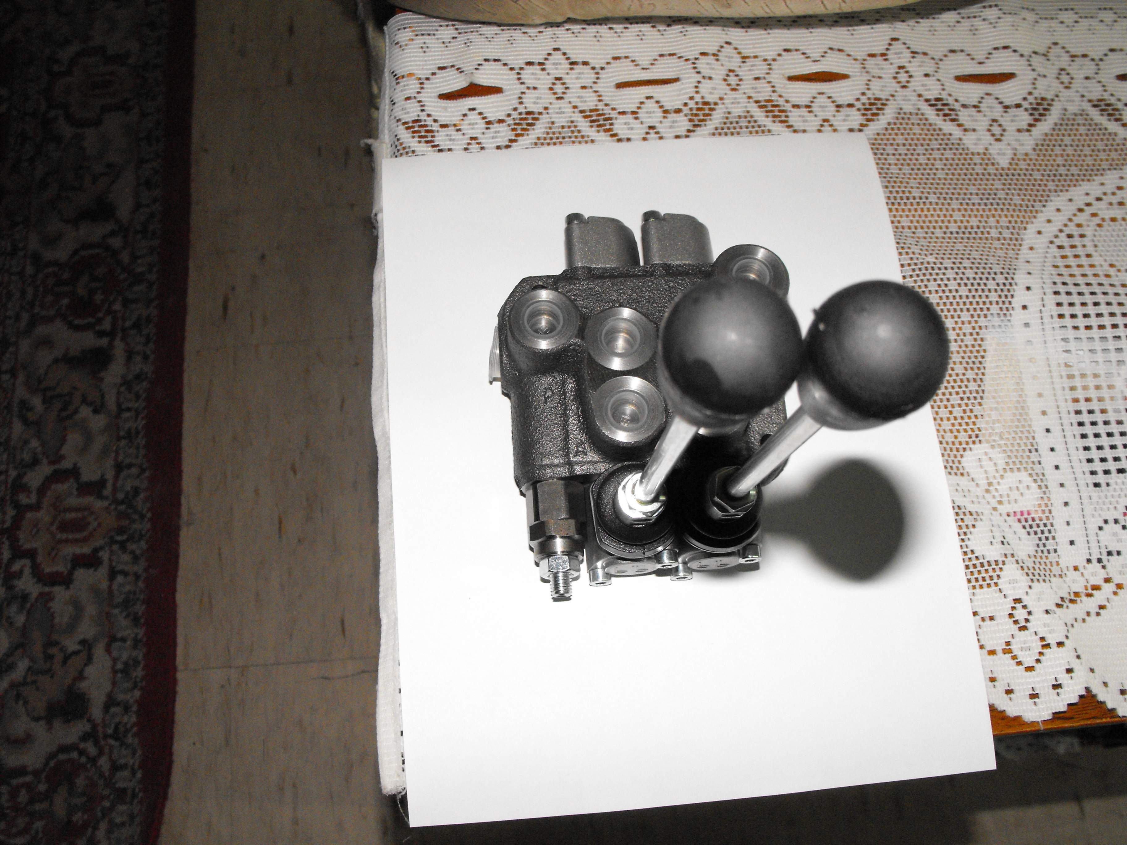

J_J that 2 spool valve is somewhat different than the new one I picked up today....here's 3 pics of this new replacement valve.....
   / New 2 spool valve has hairline crack in casting #15
Does this valve have PB or BY by that side port. If it does, are you going to use it in the PB mode?

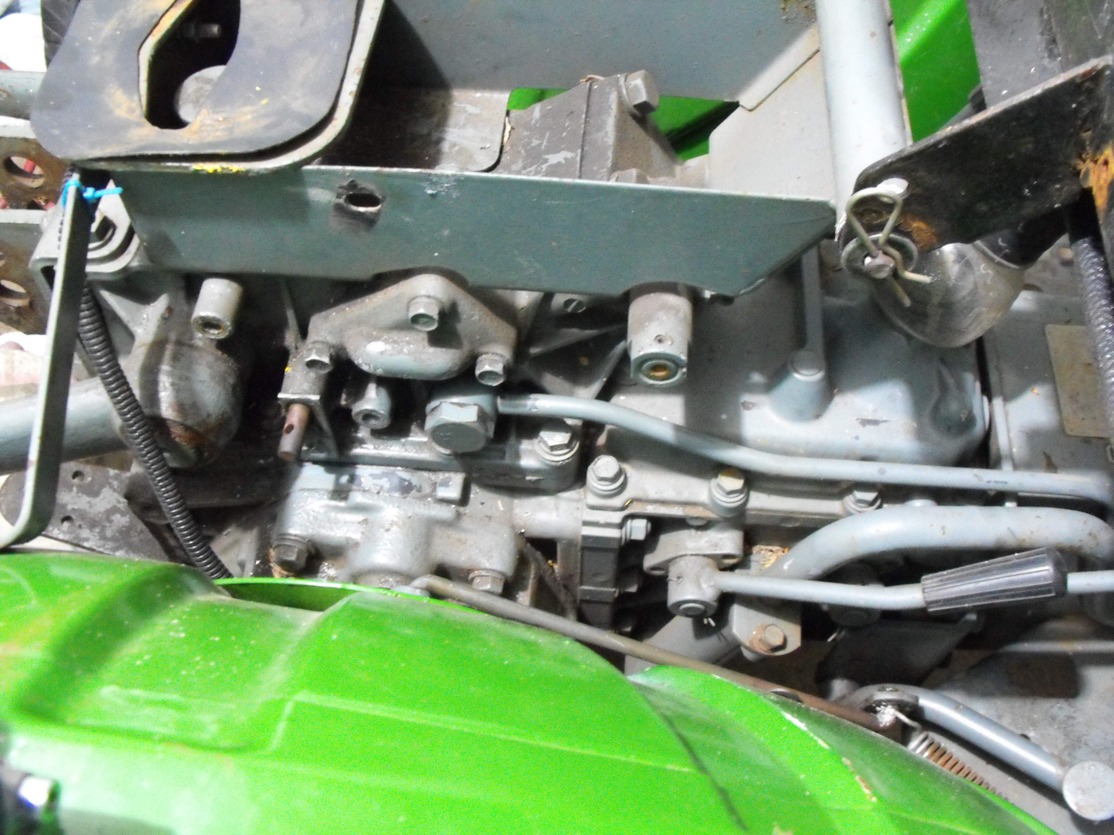

Here's an old pic of my tractors original "P" line before I cut it .the tank refill is under the seat frame you can see the plastic cap sticking up...the large steel suction tube remains the same (uncut).....
that one and only small line comes from the front engine mounted pump and into the side via a banjo type fitting....this maybe where I'm getting confused :confused2: since it is now cut and I have one end that I assume is the inport....
okay now what about the other cut end....is this not considered the return because it goes back into the rear axle and feeds the 3 pt hitch rear lift...this may be where the confusion is bein' created in my mind...this whole issue is mind boggling to me....I'm gonna' really study J_J's diagram closely....I know for a fact J_J has everthing down to a "T"....
it's just hardheaded guys like me who need to go back to school:D....to understand plain english:D.....gosh....I'm so sorry for all the problems I'm causin' on here....one thing I need to know....is this OP setup is working okay? isn't it?...why couldn't I just connect mine the same way ?:confused2:
I have an appointment for which I must drive out to an out of town hospital to get my once every 5 year colonscopy checkup @ 9:45 tomorrow morning....so right now I'm way too busy goin' back and fourth to and from the bathroom :D....so I probley won't be doin' no more work on this tractor till real late tomorrow if I feel up to it....
anyhow I've got plenty of time to get this issue straightened up in my mind....I'm not needing more oil spatter than I already have....it's darn good thing I didn't change out the old fluid I had a feelin' something bad would happen and it did....Thanks guys I need all the help I can get....I wish I could get one of you guys to come connect it proper for me:D....take care Ampa <>

Here is some advice, let's see if we can take this step by step and try to resolve the problem so that when the snow flies you can plow:):), which, if I read you right, is what you really want to be able to do, as opposed to fabricating hydraulic cylinder brackets and worrying about how to hook up the valves.:confused:
My objective here is to advise you specifically where to connect each of the three lines that go to/from your valve, as that is where it appears the problems lie. In other words, I am volunteering to help you interpret the diagram JJ sent along.
Step 1.
Does your new valve have power beyond capabilty and if so does it need anything added to make that happen? If you do not know, surely the good folk at Princess Auto can help you out with this question. It is really important we know this before proceeding.:thumbsup:
Step 2.
You may have already done this, but can you please post a picture of how you have cut and inserted new fittings into that pressure line that runs from the pump on the front of the tractor to the old 3 pt valve with the banjo fitting?
Step 3.
A few posts ago, I think you posted a picture of a gizmo you fabricated to allow a return line to go into where the hydraulic fluid filler goes. Is that right, or did I imagine that? If so, can you please post that picture, or a closer up shot again?
Step 4.
I take it by your posts you are comfortable with how to hook the workports on the valve to your two front cylinders, yes?;)
So, let's see if we can get a common basis of understanding going here and then get this hooked up for you. By the way, I hope all went well today.

remove and return the PB adapter use the same plug I had in the side "P" inport then the low pressure one to the cut end (banjo connection) into the rear axle original 3 pt. hitch hydraulics....I don't care if the onboard 3 pt. hydraulics work or don't as like I mentioned....I won't be ever using them again....If I'm still doin' this wrong....which I don't think this time around....but if so...using a loop or "T" setup may be the next only option....there's no way of usin' the filler cap area as I can see....unless
I could tap into where the dip stick is locacated if it has threads to install a proper fit fittin'...I will leave you with this info...and will wait for your input on this....I really do appreciate all the help I can get...I'm really not too happy with myself....as always take care Ampa <>
   / New 2 spool valve has hairline crack in casting #19
Ampa:
Sorry to here about your test results, don't know if you are religious or not, but I will pray for you.
The Tractor -- what you wrote up should work fine, no PB sleeve installed. Now there a couple people who will worry that if you use the 3 Pt for anything too heavy it might back pressure the outport and make it rupture again, but I think the chances of that happening are pretty slim. There are alot of front loaders on tractors out there using exactly that same hookup.
If you like take some pictures after you get 'er all plumbed together and we'll have a look see over this marvellous electronic world, just to verify.
The important part and the one I cannot see, is to make sure the PB adapter is removed. Otherwise we risk the same issue as last time, and we certainly do not want, or need, a repeat. Those nice folks at Princess might get a bit suspicious.
