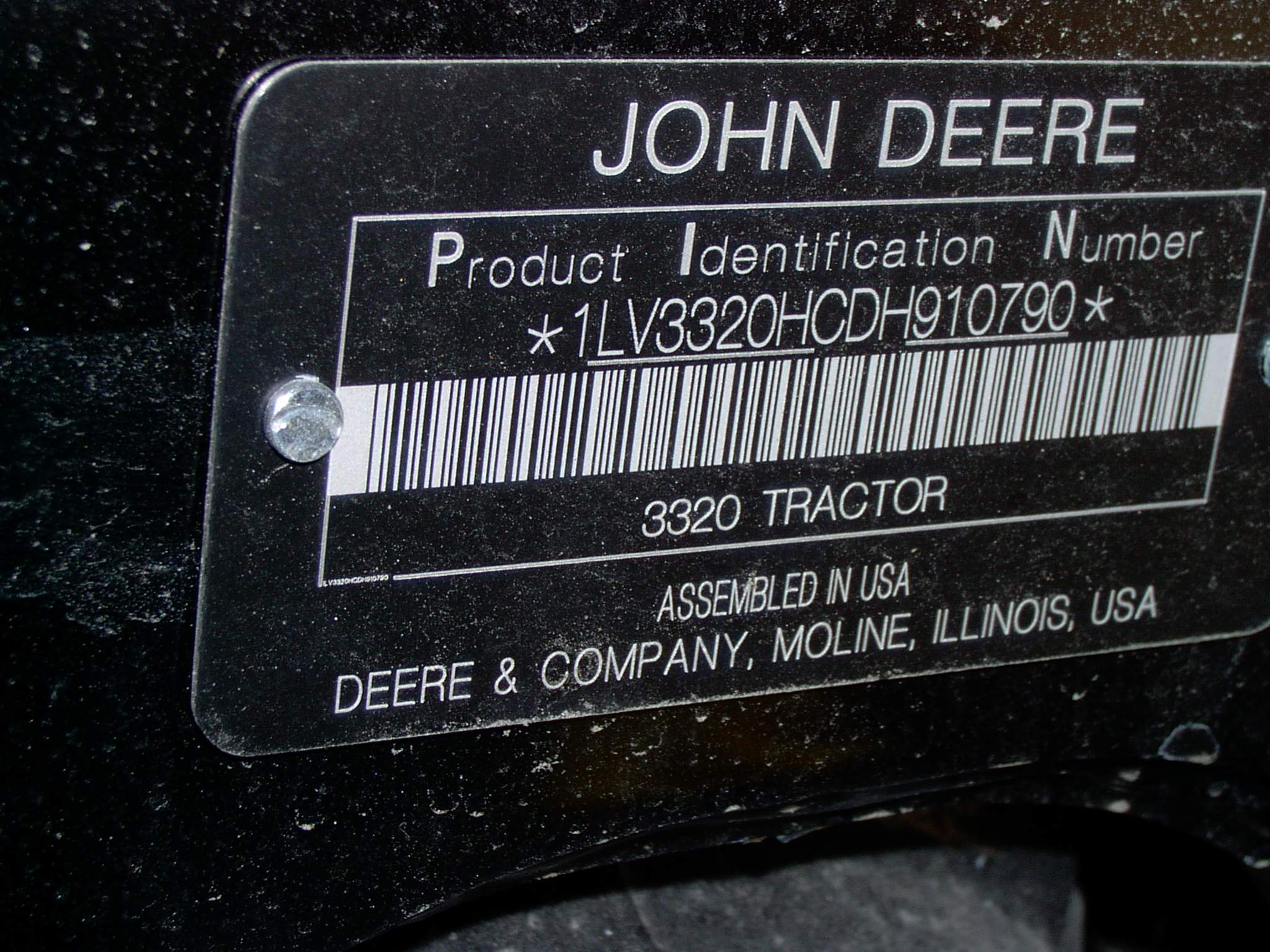

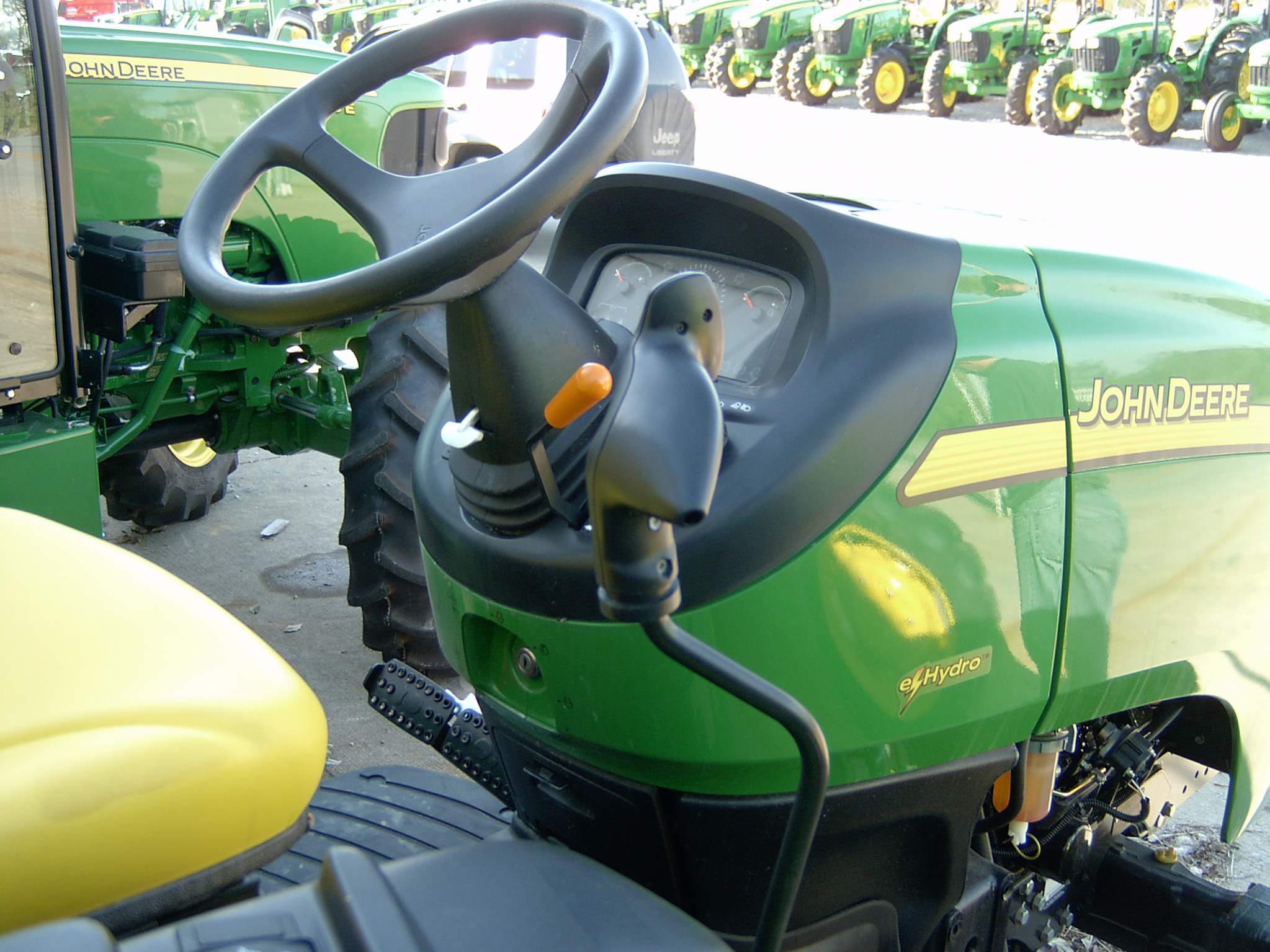

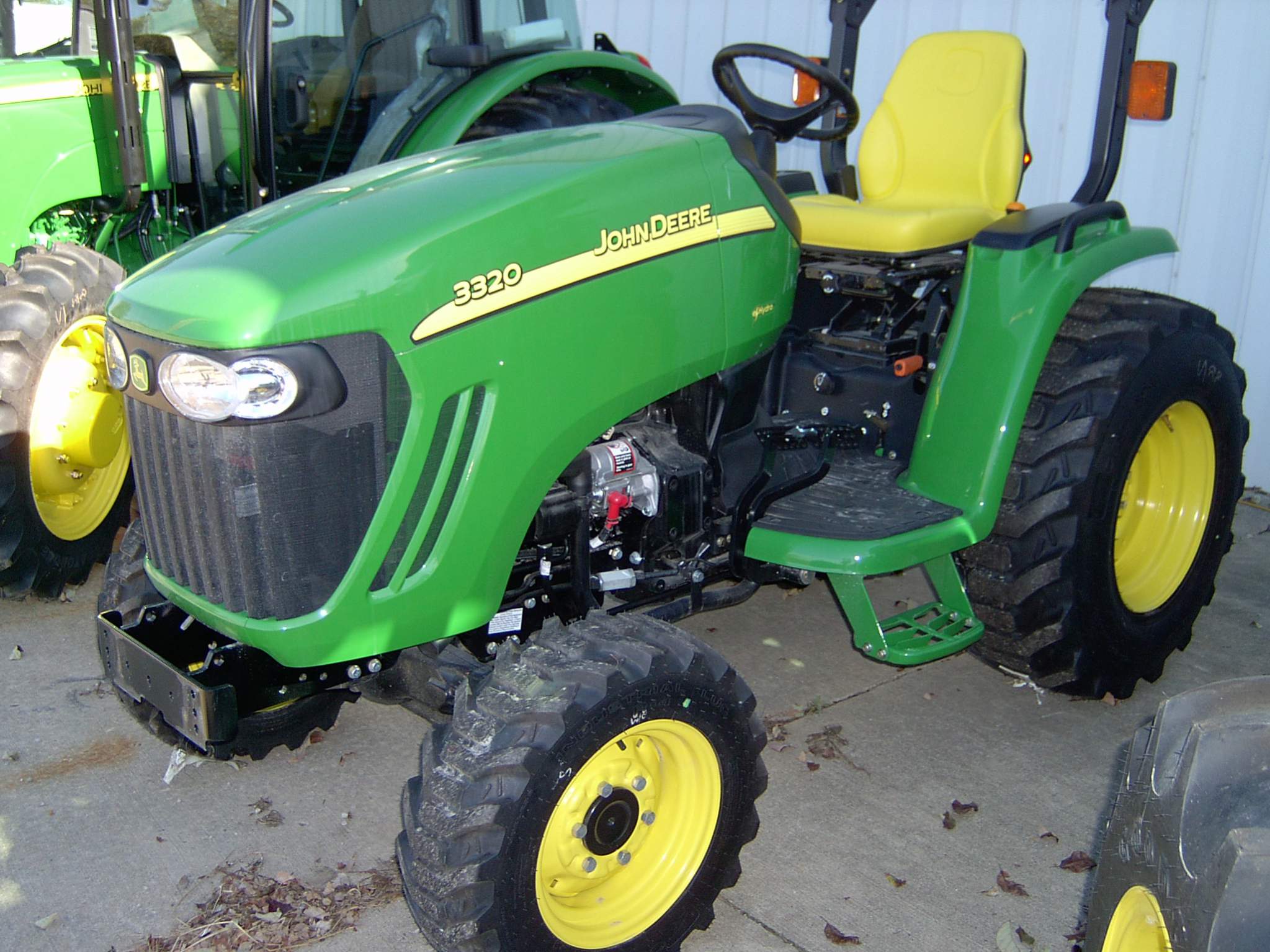

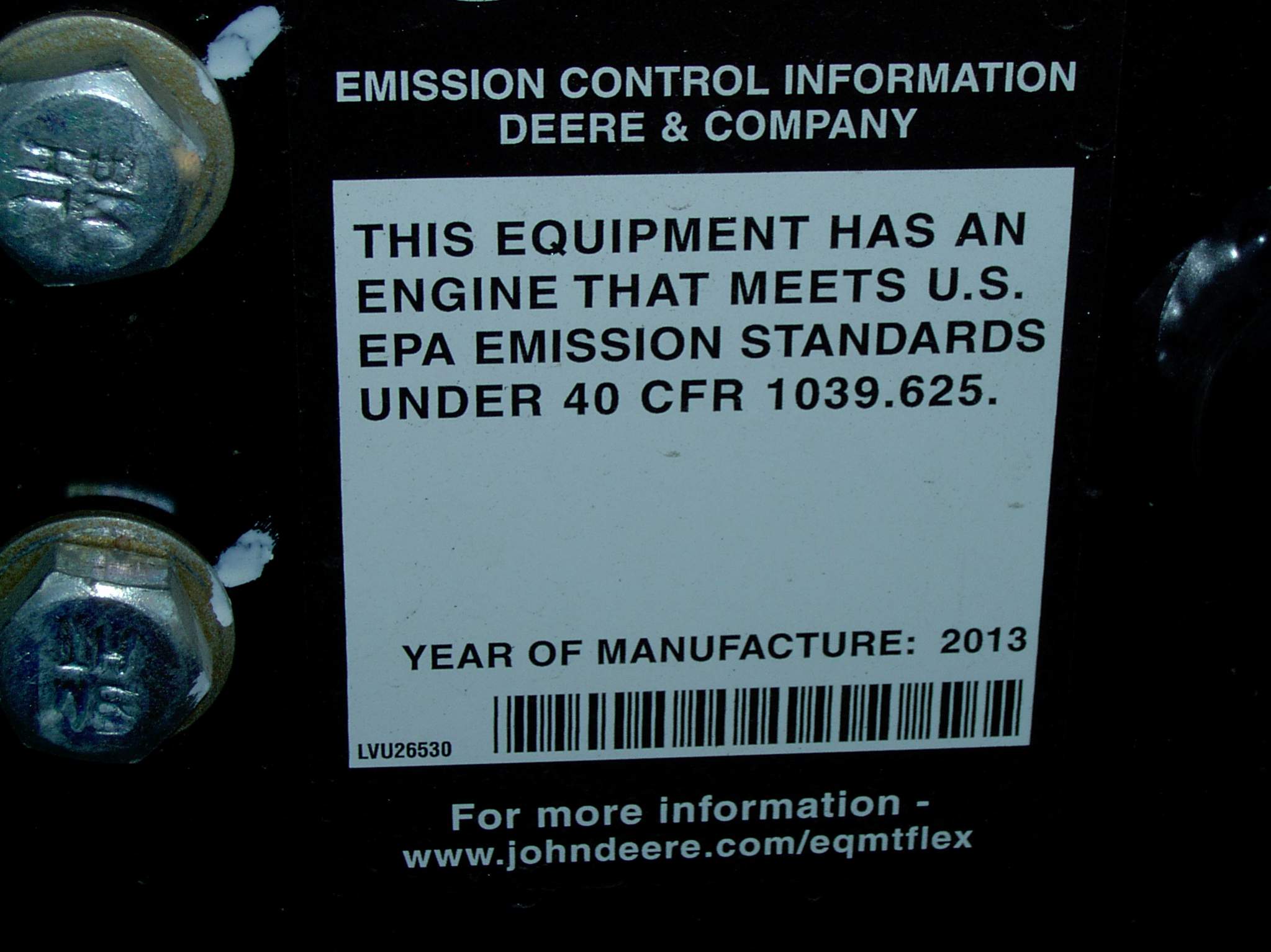

Ok, here's the pics. It's still a 3320 old style. has some different things than mine. steve 001.jpgsteve 003.jpgsteve 004.jpgsteve 005.jpg
