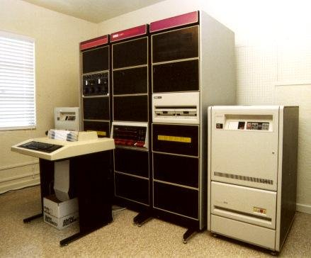

gary_dsc said:
Thank you, pdp11, for your concise and direct answer. Now i know the proper starting procedure. By the way, does your handle have anything to do with the DEC minicomputer that was built back in the 70's?
Yes, it does. I know it doesn't quite go with the theme of a tractor forum, but it's surprising how many people make the connection.
   / New 2520 coming soon #17
Is that your system? I've spent a lot of time programming pdp 8's, pdp 11's and vax's. Programming was real fun with those systems, especially the small 11's. You wrote your own O/S, drivers, etc. I miss that time a lot. Oh well, guess that doesn't have much to do with tractors.
   / New 2520 coming soon #18
Yes, it's one one of them. That's the 11/70. I also have an 11/83, a MicroVAX 3100, and a Pro350. However, I use a simulator most of the time to save electricity :)
