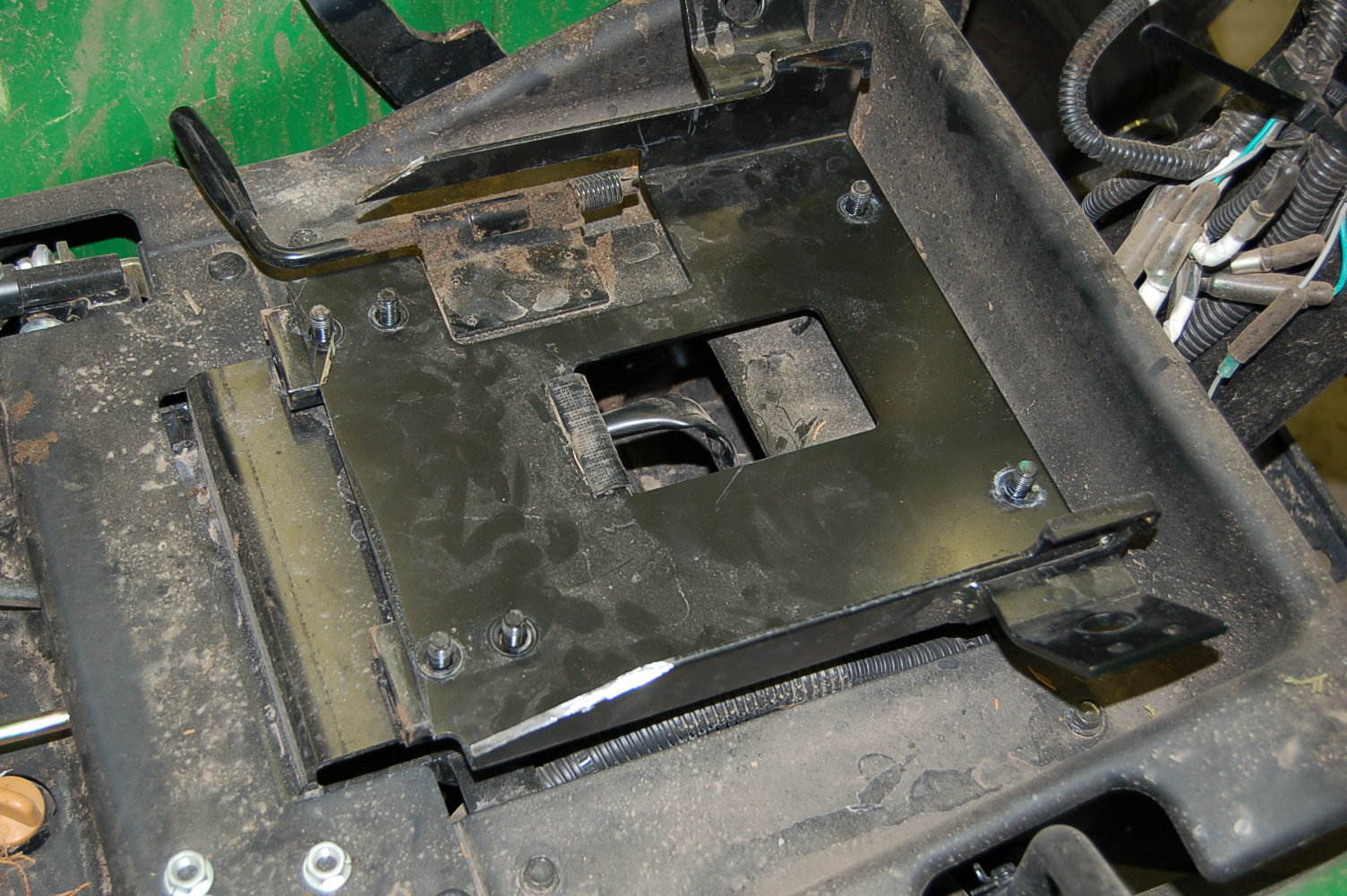

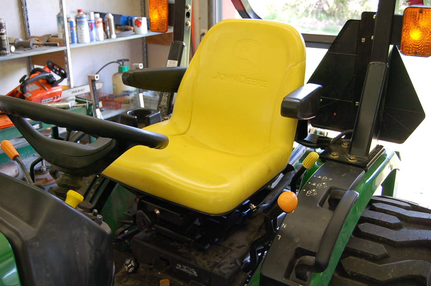

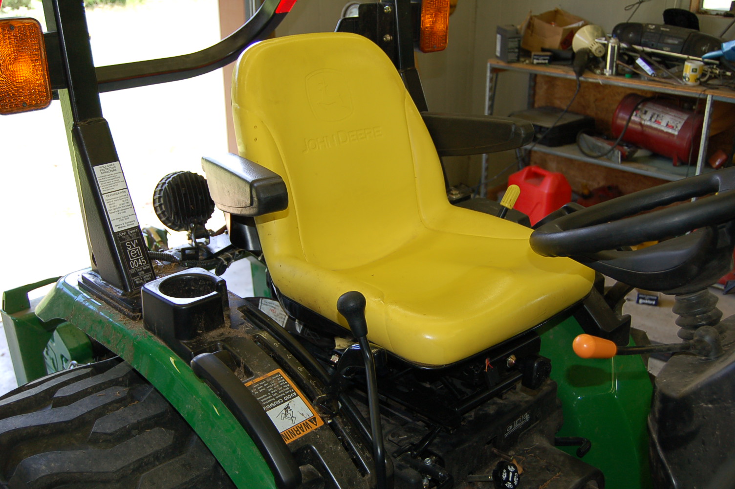

after spending last 2 years on an uncomfortable seat, i made up my mind that the seat on my 2520 would be comfortable or else. i liked the armrests on the b3030 so when i purchased my 2520 i told the dealer i wanted armrests for it. he found these from unknown ztr and threw them in with the deal. i bought a seat suspension off EBAY that i think was for an exmark for 88.50. i took the origional seat mount off and cut off everything except the seatbelt mounts and welded the suspension to the origional mount and everything works including seat adjuster and safety switch. when i put seatbelts back on, i left springs off them as it always seemed to be in the way when i raised or lowered the deck. now i have a seat that makes my a** smile.......

Looks real good to me. It's got to be infinitely better than the factory seat. Good work!

spent 6 hours in the seat today and the suspension seat/ armrest combo worked well.basic seat has good support and add on suspension really helped. good upgrade to 2520.......`
