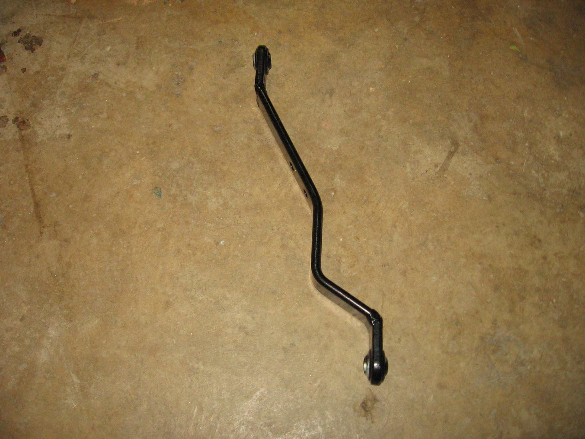

Ok question- the right draft link rubs the tire when backing. I have the RB on there. I will be doing snow pushing with it in reverse. How do I correct that?
   / New 2720 arrived! #13
First off...Congratulations on the sweet set of toys.
Regarding your draft link hitting, you should ensure your turnbuckles are tight. I know on our 2520, I have also switched my tires in the rear to give myself another inch of clearance.
I hope this helps.
   / New 2720 arrived! #14
Congrats on your your new machines!!:thumbsup:
As lost stated,make sure your turnbuckles are tight.
I would assume that your 2720 has the newer style lower arms.
Greg
   / New 2720 arrived!
#15
Greg
I appreciate it guys. I wasn't sure if it was that simple. I'm learning. Yes I do have those style arms.
