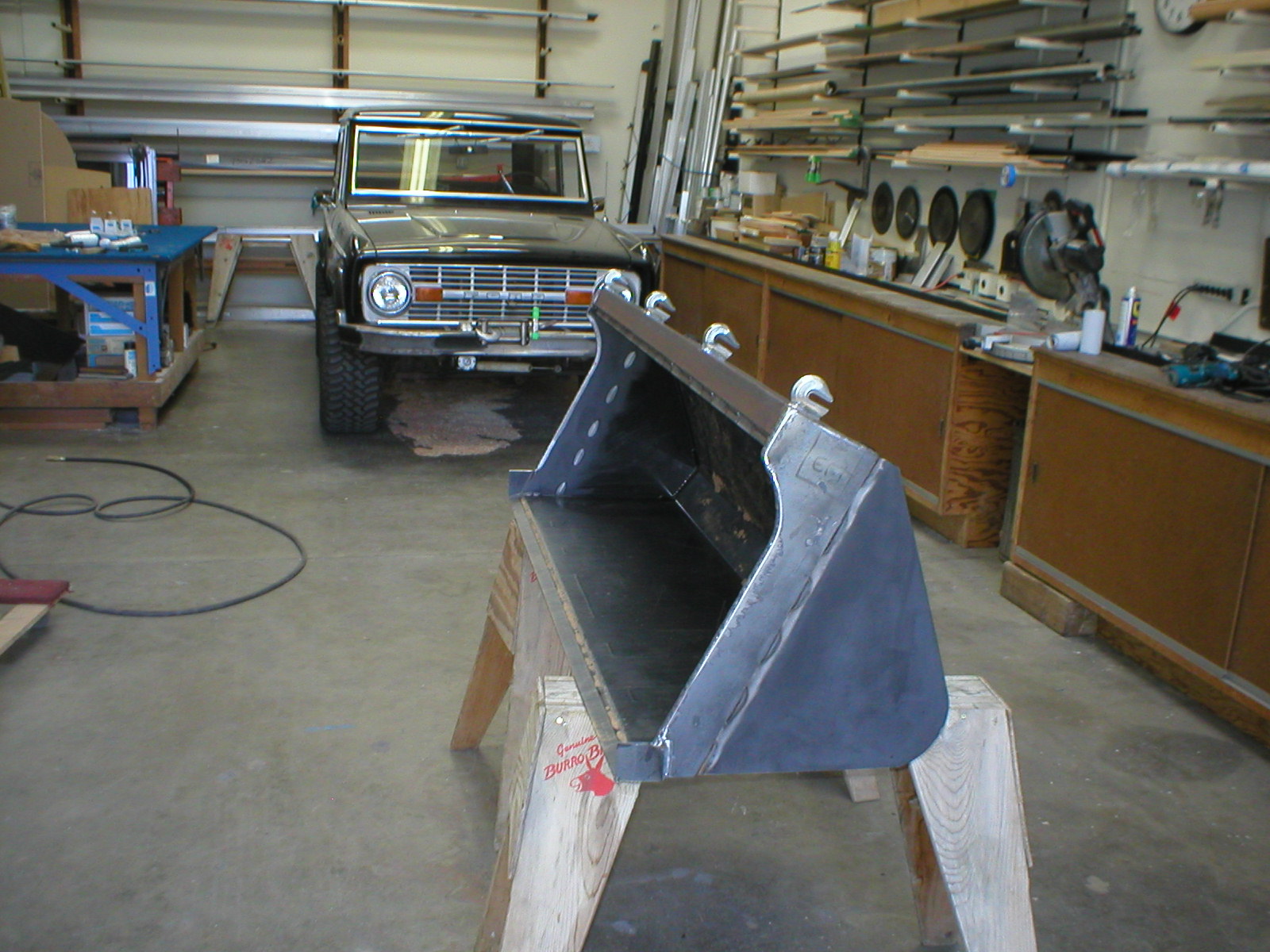

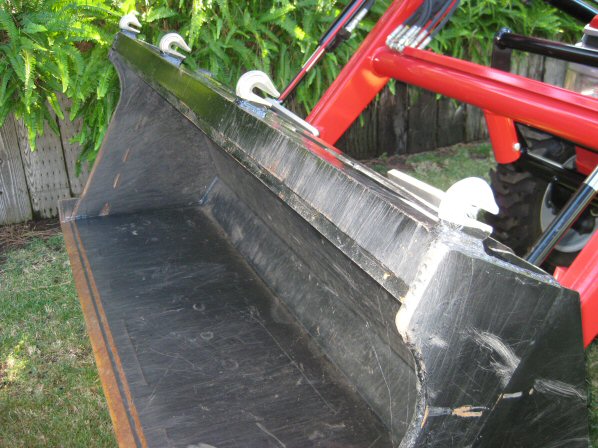

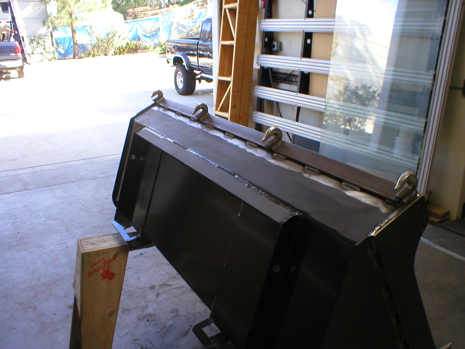

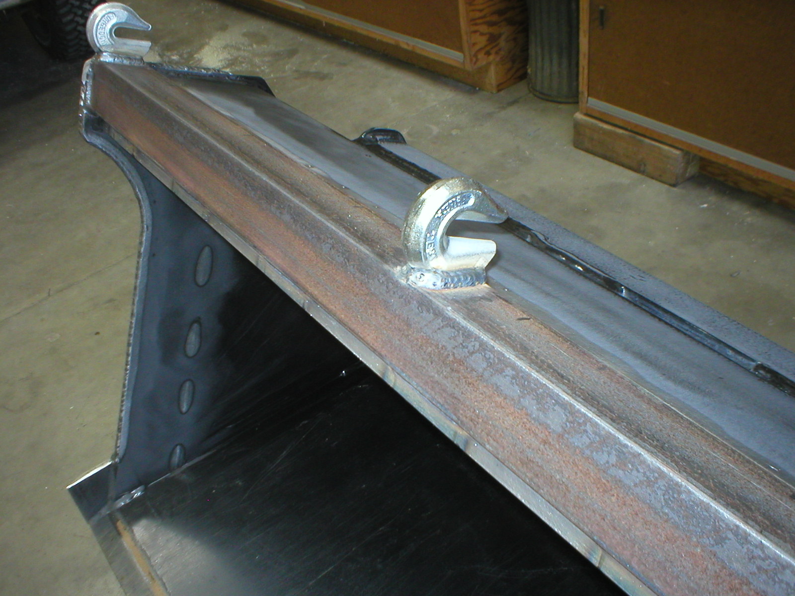

I have found that a 2x2 angle 3/8" thick works very well to have across the top lip of the bucket before welding on said hooks. I also put 3/8" plate on the front sides of my 3215 bucket to help protect from bending. Here's a few pics. ;)
Awesome pics MVR, thanks for that, I hadn't seen this post when they asked me where to weld the hooks, looks like I'll end up with just 2 directly in front of the boom assembly arms where the bucket pivots.
Papers signed, done deal, may have to visit my welding neighbor to add more reinforcement at this point. They wanted around $400 at the dealer for bolt on edge.
Great looking shop btw!
I hope that they put some sort of additional support under the hooks. These smaller buckets are really only built to move loose material and are not all that strong in the std configuration. :(
Best of luck with your new ride, be sure to post pictures when you get it, we all like pics here at TBN. :thumbsup:
Like mtnviewranch said reinforce the top of the bucket before adding hooks. I bought my 2615 with 220 hours and the top of the bucket (same bucket as the 2816) was bent. I had the bucket straightened, reinforcement added, and added three hooks - one in line with each arm and one in the center. A buddy bought a 2816 with 77 hours and the top of the bucket was bent.

Before I added reinforcement to my top edge, I put a little bow in it. Now, with a 1/4" thick piece of angle iron welded across the entire length, and a Markham Welding tooth bar, I can get away with using my bucket for about anything coming to mind.
