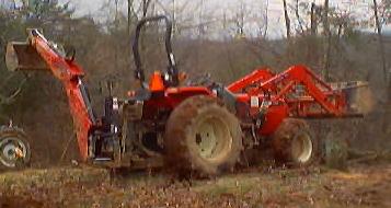

   / New 3045. C86 Backhoe Question.
Carluman
This is the best pic I have so far.
I have used the 36" bucket almost exclusively since I bought the tractor. I just finished up digging a 30 foot culvert for a new road to our house site. The bucket made quick work of a nice trench! I'll swap out for the 18" bucket soon in order to drop in my utility lines and do some french drain work.
The upfront cost was pretty high, but this backhoe is a tool that will be used countless times! The least amount of shovel work, the better. /forums/images/graemlins/grin.gif

   / New 3045. C86 Backhoe Question. #8
I still can't get over a 36" bucket. I wouldn't have guessed that it would have enough power to make good use of one that size. I need to leave this site before I go broke.

You're right about the power issue, though. I can't pull out stumps very well with the bigger bucket because the bigger roots tie the bucket down too easily. This recent culvert ditch, though was like butter. Also, I've moved mountains of clay mudslides with this thing. I've even dug out part of my new basement with it!
I rented a full-sized Cat backhoe when my tlb was in the shop and it had a 24" bucket on it, but the depth was big as well, so the overall volume of material it could remove was pretty high for the width, and was easily 2x what my 36" bucket on the Century could hold.
