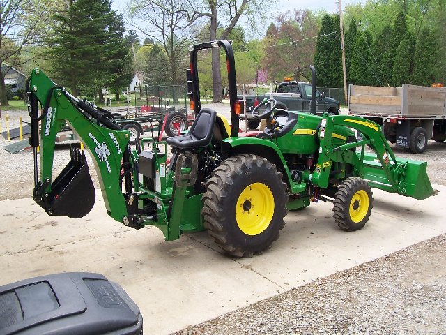

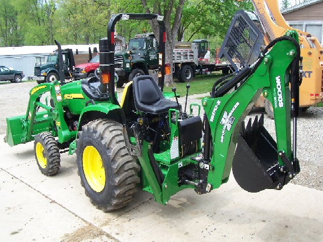

As previously posted I recieved my 3203 with a 300cx loader back in late march and last week I finally got my Woods 70X backhoe! I completed the mounting instalation today with the help from my father. Wasnt too bad to put on, just takes some time. Saved about $400 instaling the hoe myself.
I am posting some pics of my new rig to show that a backhoe can and will work with a 3203 John Deere!

Sharp looking machine you have there:D

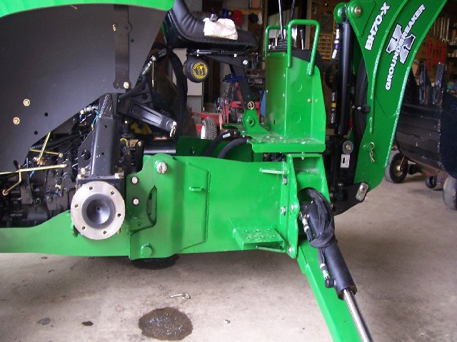

The Woods 70X is built very close to the John Deere 447. The main reason I chose Woods is that they designed a mounting kit specificly for the 3203, wich Deere does not offer the 447 for the 3203. As far as a comparison of specs the Woods has 270lbs more bucket digging force,@(2030lbs of psi) and roughly the same dipper force as the 447. Digging depth is about the same for both models. Yes the BH70-X is a solid, permanent mount, but like the 447 it can be removed to use the 3 point hitch when desired.
I got a chance to use the hoe for the first time today and I am pleased with the performance. The hoe taps into the tractors hydraulic system and it has good power and impressive speed. I have the 9''&18'' buckets and it handles the 18'' very well. In the pics I posted is a shot of the sub frame and shows the conection to the sub frame and the hoe.

That's a great lookin' setup! I'm especially impressed with the length of the rectangular mount that extends along the frame of the tractor.
Appears to be very sound structurally and very similar in design to the JD 8B backhoe that's available on the JD 990.
