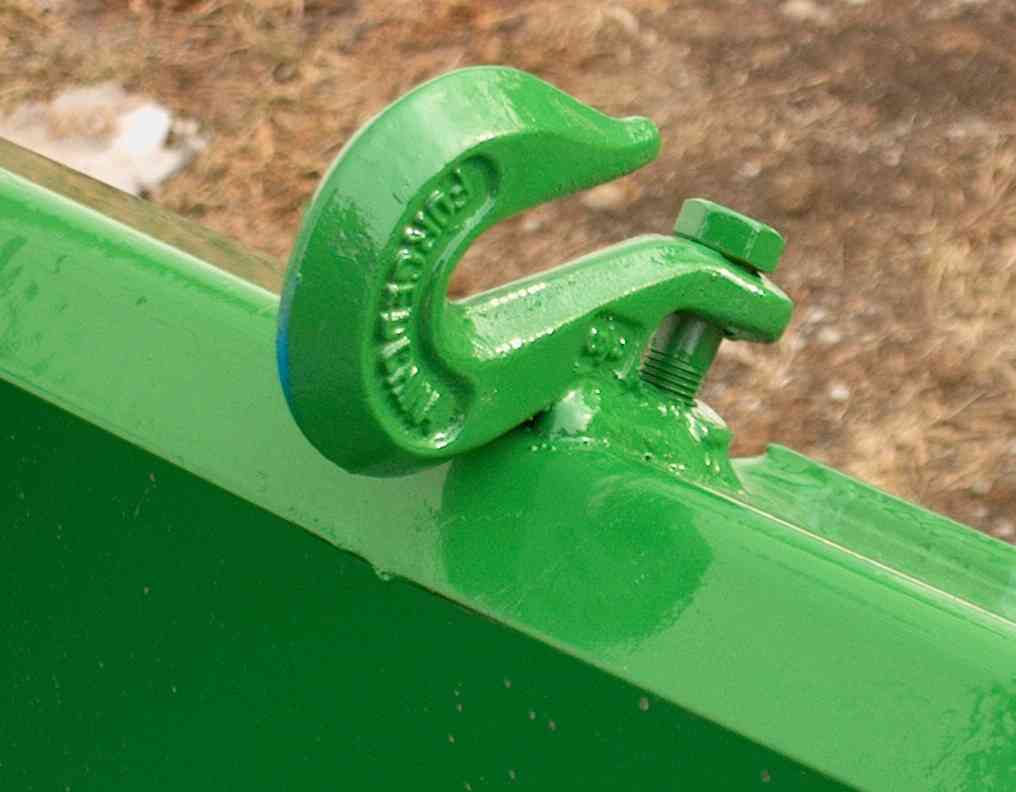

Here is a closeup of the bucket.

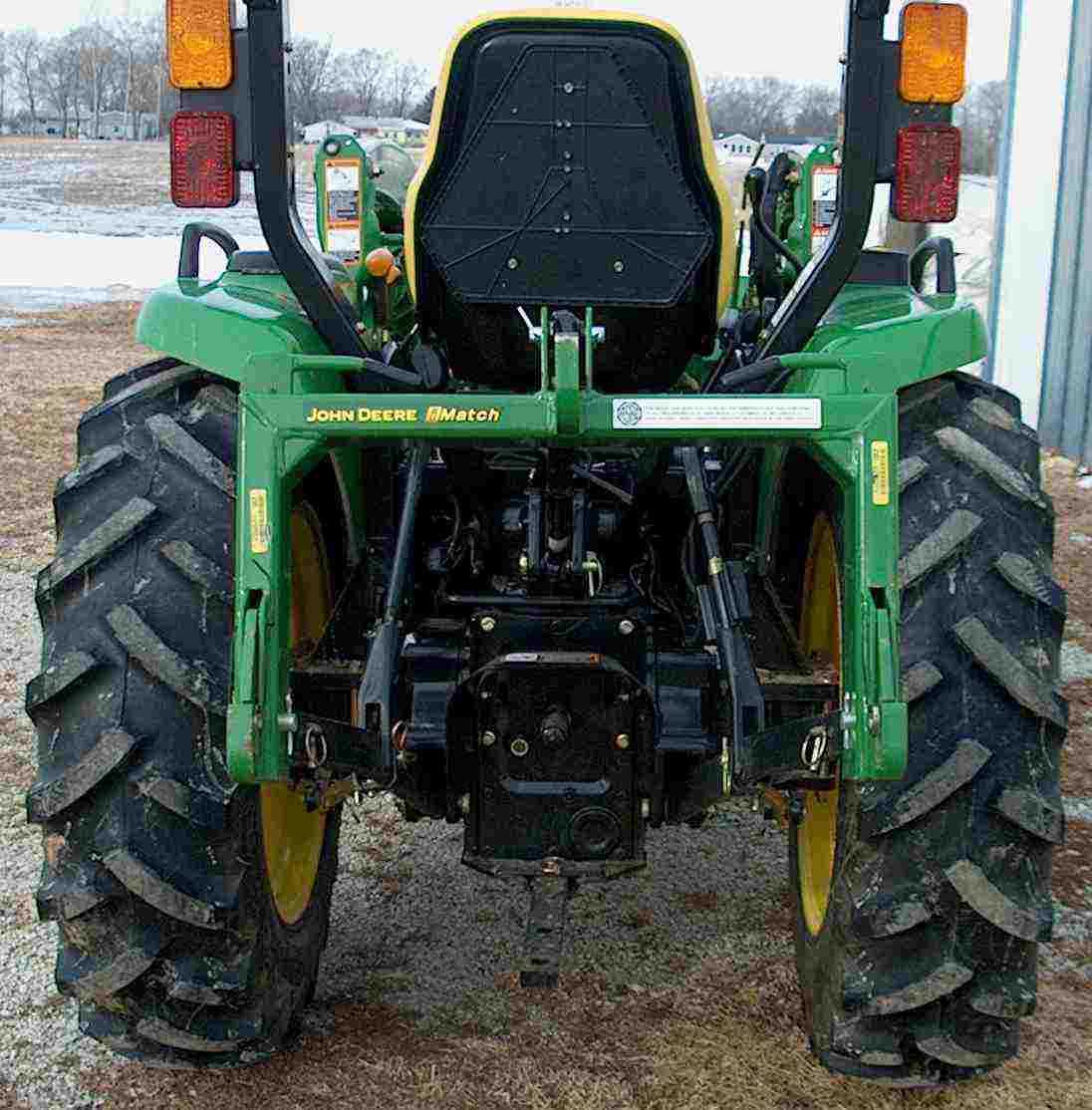

I wasn't sure about purchasing an Imatch. But after reading posts on TBN I decided to go ahead and spend the extra money. I do a lot of switching of equipment without anyone around. After using this today, it may be the best option I have ever added.

I thought about getting an I-Match but I don't have the first piece of Deere equipment and figure the chances of it working with my stuff was slim. I have a 3 point hitch backhoe and the last time I hooked it up I almost mashed me, the backhoe and the rear of the tractor. So yesterday I bought one of the generic 3 point quick hitchs. My backhoe has adjustable positions on the hitch so I will set it up to match my quick hitch. The quick hitch only cost me $99. I backed up to my other pieces of equipment and it wasn't close. /forums/images/graemlins/frown.gif

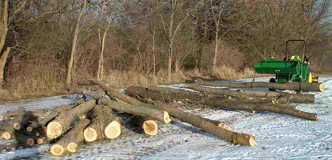

I spent the better part of the day cleaning up trees we cut down around one of the fields on Monday and Tuesday. Here is a shot of some of the work the 4310 and I were able to accomplish today.

Looks great!!! /forums/images/graemlins/cool.gif /forums/images/graemlins/cool.gif /forums/images/graemlins/cool.gif

Congratulations Wesdor!! Truly a shweeet tractor. One thing to mention...I couldn't tell if your bucket is reinforced on the top where the hooks are welded on. If not, and your bucket is like the rest of ours, the bucket could easily bend while lifting heavy objects via the hooks. I welded a piece of flat steel 1/2" thick 5" wide all the way across the top of my bucket before I welded the hooks on.
Keep the picture coming and enjoy your tractor!
   / New 4310
#11
Thanks for the advice Jeff. As you say, the top of the bucket isn't reinforced. Since the dealer welded those on, I made the assumption it would hold. And you know the old saying: "You know what assume makes out of U and ME." /forums/images/graemlins/smirk.gif
I think I should plan to reinforce the top. If the weather is at all workable I'll be out again Monday. I have a lot of tree mess to clean up before the spring field work gets here.
