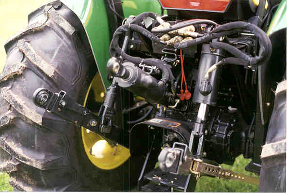

I already have Bill. /w3tcompact/icons/sad.gif When disconnecting the restraining strap that holds the hydraulic top link of the TopnTilt in place I accidently left that strap dangling. See the attachment. You can't see it too well in this picture but on top of that top cylinder there is a steel strap that secures the cylinder in an upward position and is attached to a mounting bracket on the machine. When I hitched up my attachments to test out the TopnTilt hydraulics, this strap accidently got wedged against the mounting bracket and bent like a pretzel into a Mobius strip formation. This tells you something about the power and force of these hydraulics. I will try to straighten the strap out or replace it if I have to.
Lesson Learned: When you remove this restraining strap to lower your top hydraulic cylinder to hitch up one of your implements, make sure you remove this restraining strap altogether and store away in your left fender storage box or secure the strap against the cylinder.

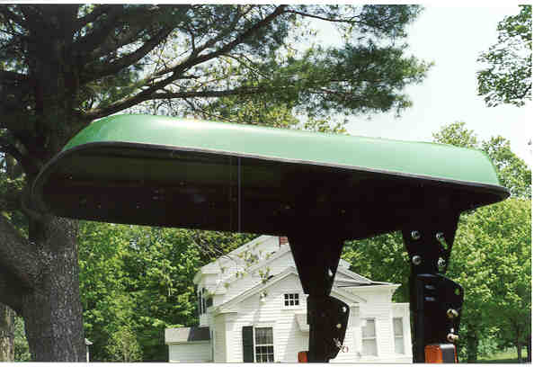

I promised you guys more pictures including shots of the eMatch switches and levers and Top and Tilt action. First one up though is a close-up of the BuckTop canopy. This is a real nice canopy....very well made.

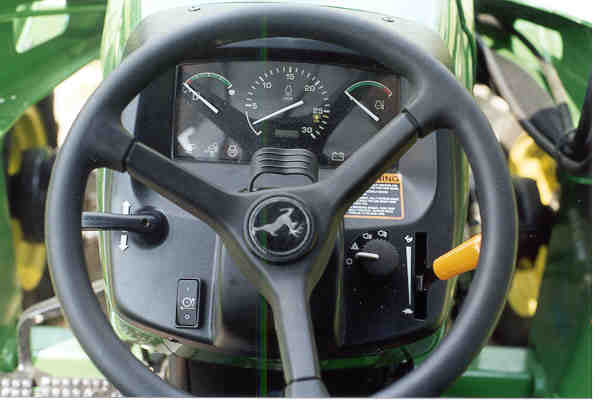

Now, the 4710's dash controls

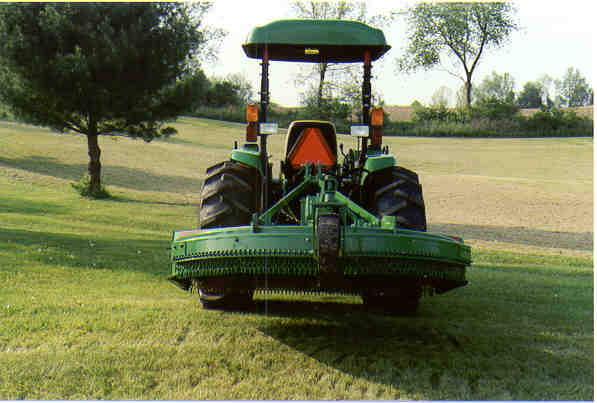

MX6 hitched to Top and Tilt with top cylinder contracted.

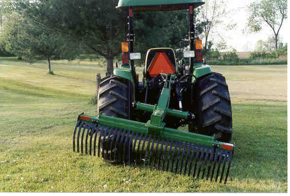

Now, LR1172 landscape rake with top and side links contracted. Here, pitch is shallow and rake level....good for light raking on even terrain.

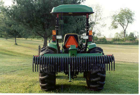

LR1172 landscape rake with both top and side links extended. Pitch is steep and rake angled to accommodate rough and uneven terrain.
