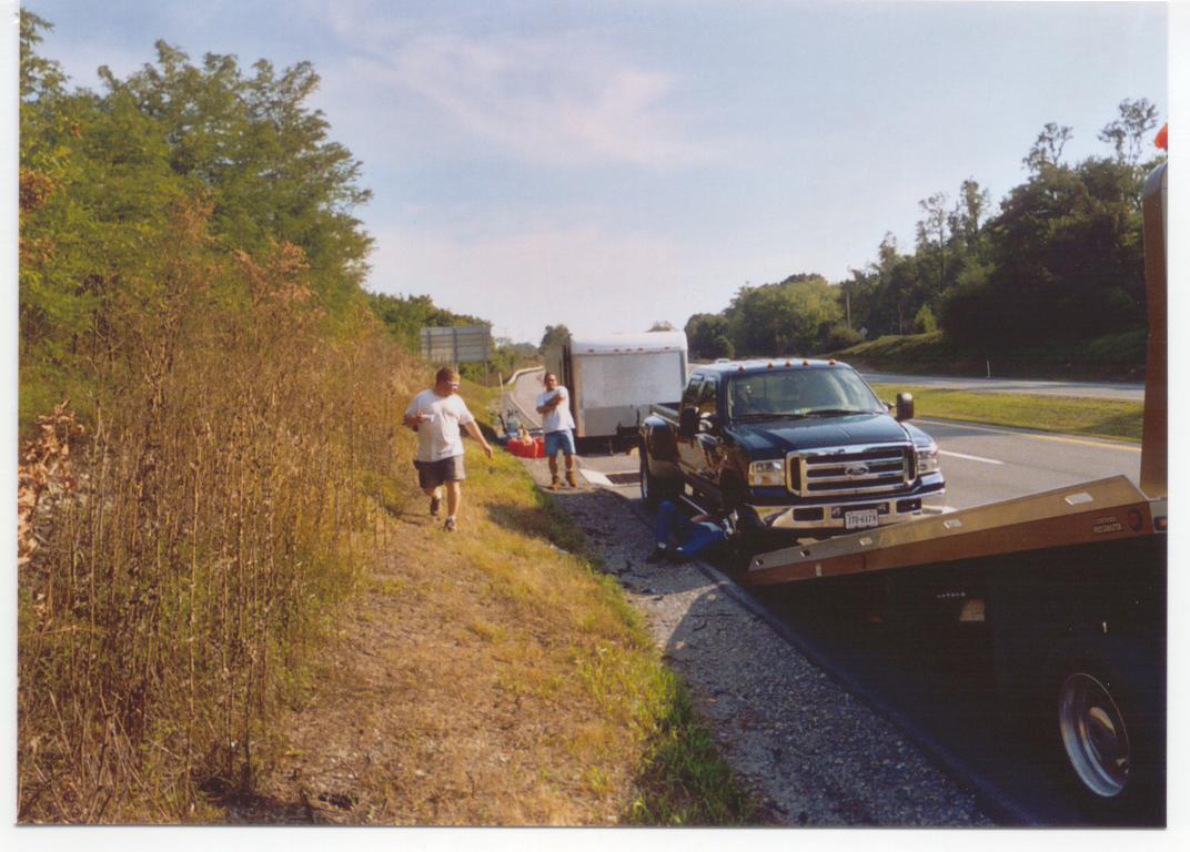

I don't want to destroy your great feelings with the new truck. Believe me, this was my first new vehicle ever purchased. What I learned was that warranties are meaningless if manufacturers simply deny a problem exists. Case in point, Ford says it doesn't leak oil. Case in point #2, Ford says there is nothing mechanically wrong with the truck. I'll let the pictures explain the truth. My message to you, don't let them tell you there isn't a problem and walk away with your tail between your legs because you are a Ford fan. I was a ford fan. Never again.
I hate to think what would happen if I was hauling horses instead of motorcycles. How well do horses do in 100 degree heat, sitting on the side of a road for 10 hours?

I understand exactly what you are saying. A warranty is only as good as the dealer and company standing behind it. It would certainly frustrate me if I had a situation similar to yours. I believe the dealer has some control over this. I chose my dealer carefully, and the sales person I dealt with. I also have the benefit of being fairly well-known in my community for dealing well with people and having a strong network of support. While this guarantees absolutely nothing, I suspect that if a problem were to occur, I would have some help. The selling dealer has already said, for routine service and/or if a problem, he would send someone to pick up my truck (30 mile round trip) and give me an equivalent loaner truck until mine is ready. This makes me feel pretty good about things. Hopefully I will not need anything other than routine service, but things DO happen. I would also mention to Duc that I checked VERY closely on the power output before buying. The six speed manual with the 4:10 gears is rated at less horsepower, which I did not want. I went for the full 350/650 combo. I might even dyno it to make sure they are not exaggerating, although a test on YouTube suggests they are not.
