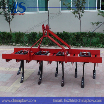

With the soil varying from mud to concrete after a rain get in the pasture while it's moist and workable with a spring tooth cultivator and pointed tip tines. You can usually find them used for a couple hundred bucks. The size tractor you get will decide how many tines you can pull. They will help rip the soil & level it, pull rocks to the surface to remove, and if they get alot of resistance they will give with the springs and jump it for the most part.
Picture is the implement I'm talking about. I'm about to clear 7.5 acres for pasture next year and all my farm friends tell me this is the trick for it. I'm on the prowl for one right now myself.
If the land is hard as a rock, a single point (such as an inexpensive sub-soiler, CountyLine Subsoiler at Tractor Supply Co.) will break things up.
