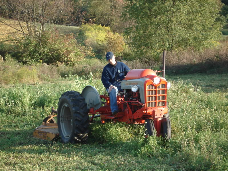

Do y'all like the factory position for the exhaust or do you reroute it? Looks like it will get me in the face where it is and get beaten up if I run it out the back. A friend suggests taking it straight up and putting a flapper on it but it still seems like I'll get a face full.
   / New 860 owner #39
if you ar enit in tall dry grass.. out hte back is out of the face..
   / New 860 owner #40
My 961 has an exhaust stack and I haven't had any issues with it blowing back at me. I'm a fan of exhaust stacks on tractors so it gets my vote. Here is a picture of mine.
