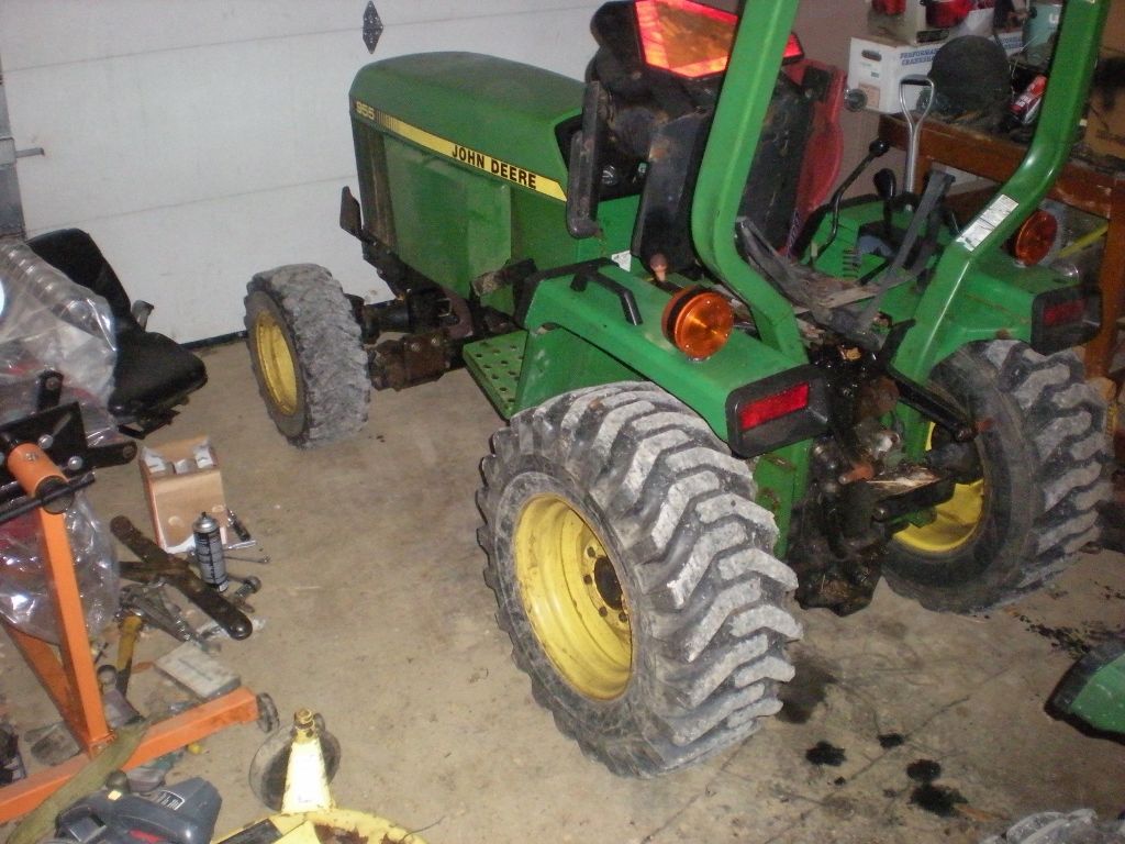

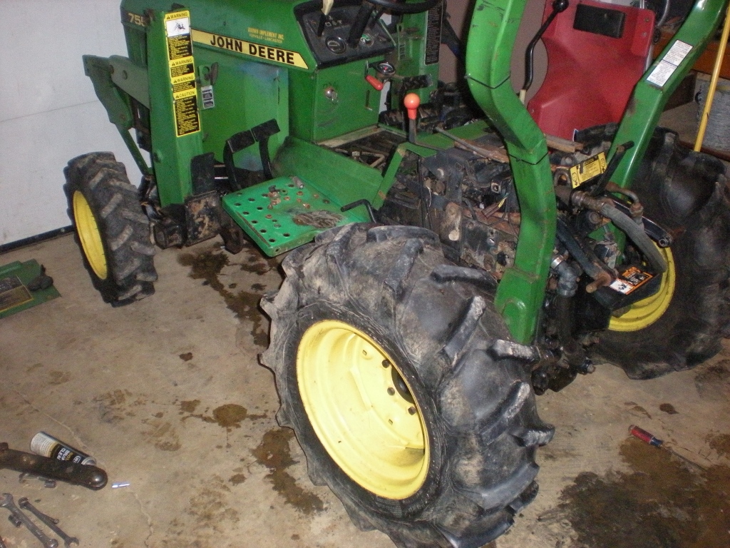

I recently purchased a 955 to replace my 755. I wanted to be able to keep my backhoe but wanted more hp.
Someone had the idle adjusted to 1,000 rpm, so a lot of things are loose. The tach works, but I didn't look to see if the hour meter was moving until the end of the test drive. It is stuck at 879.1 hours. The engine starts and runs well and has no blow by. The oil is clean. I started fixing the sticky pedals. It sat outside for some of its previous life.

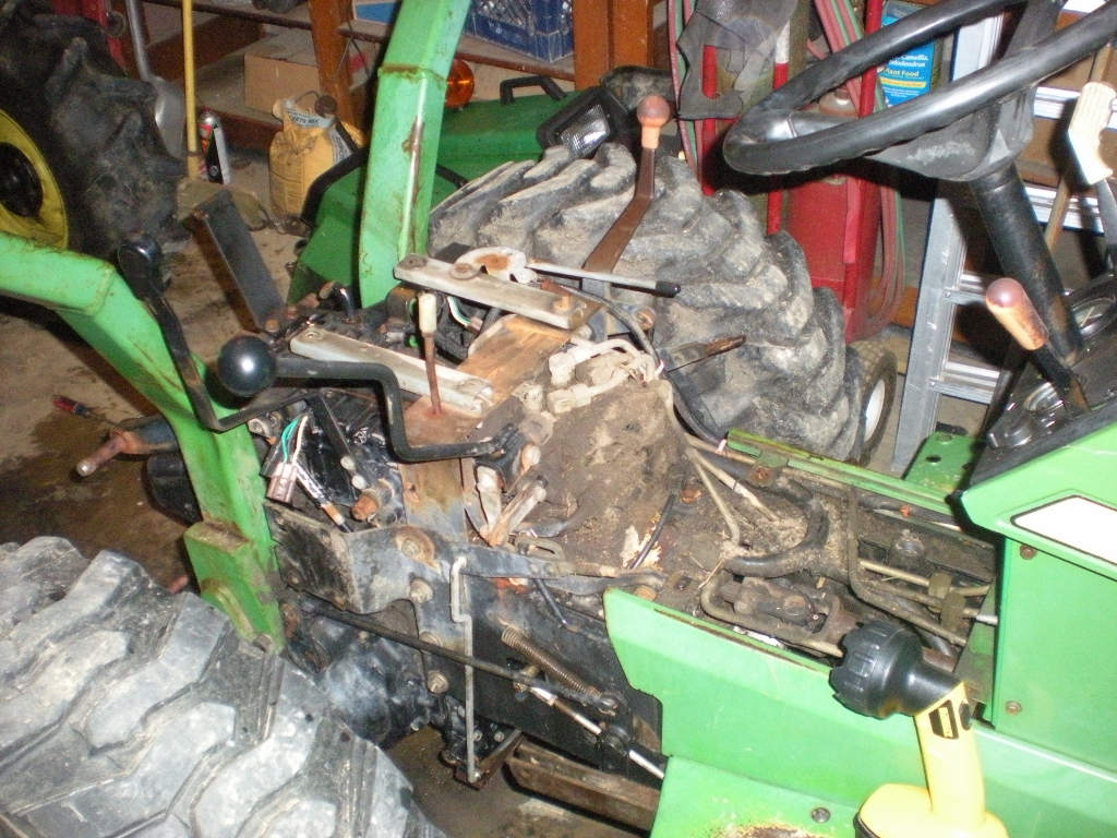

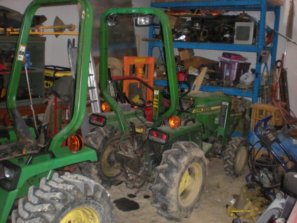

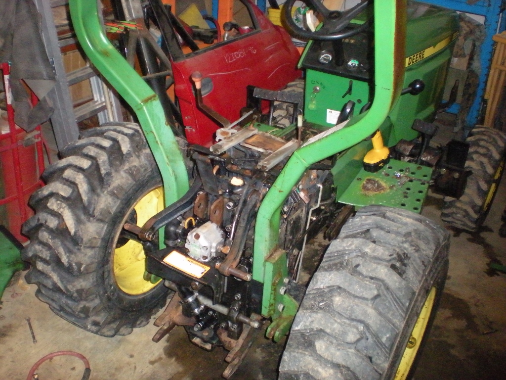

Tomorrow morning I am going to start the power beyond swap. I am really looking forward to tearing two tractors apart.

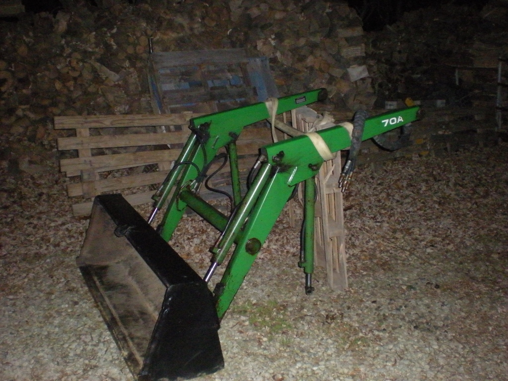

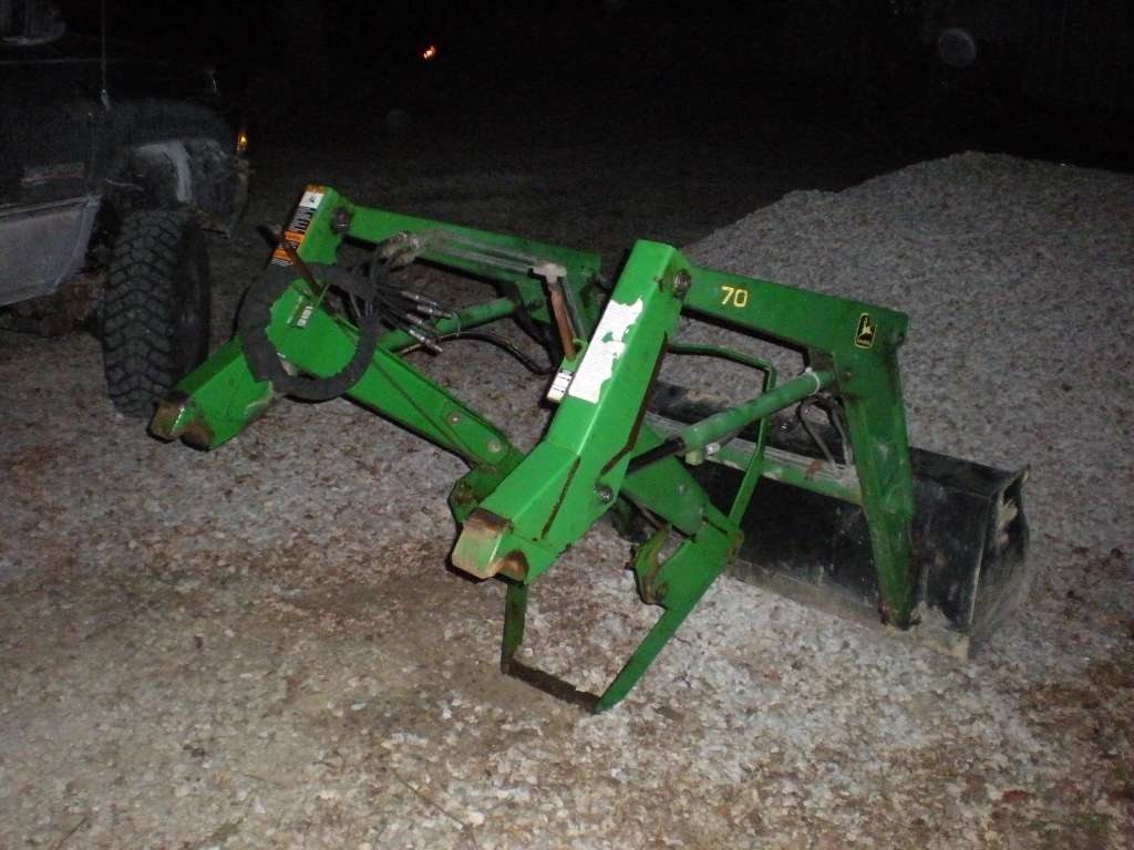

The hard to grease lower bucket pins were bad so I swapped the loaders out at the rear pins.
My 755 came with two decks when I bought it. It also had some extra mounting hardware. The front mower mount is different between the 755 and 855/955. I will need to get a new driveshaft or have mine lengthened.
It also will need new front wheel bearings in the future. I fixed those on the 755 last winter and the parts were around a grand.
I think I will be looking to trade the r4s for some turf tires.
I will be putting the 755 up for sale once I swap the power beyond and clean it up.

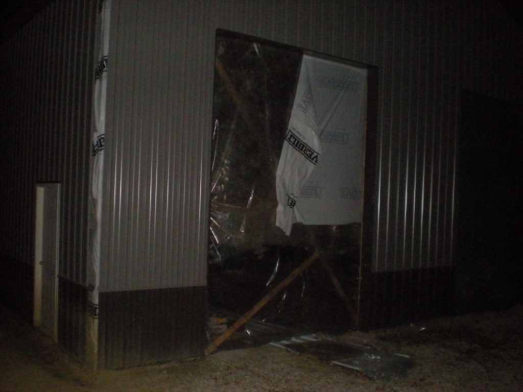

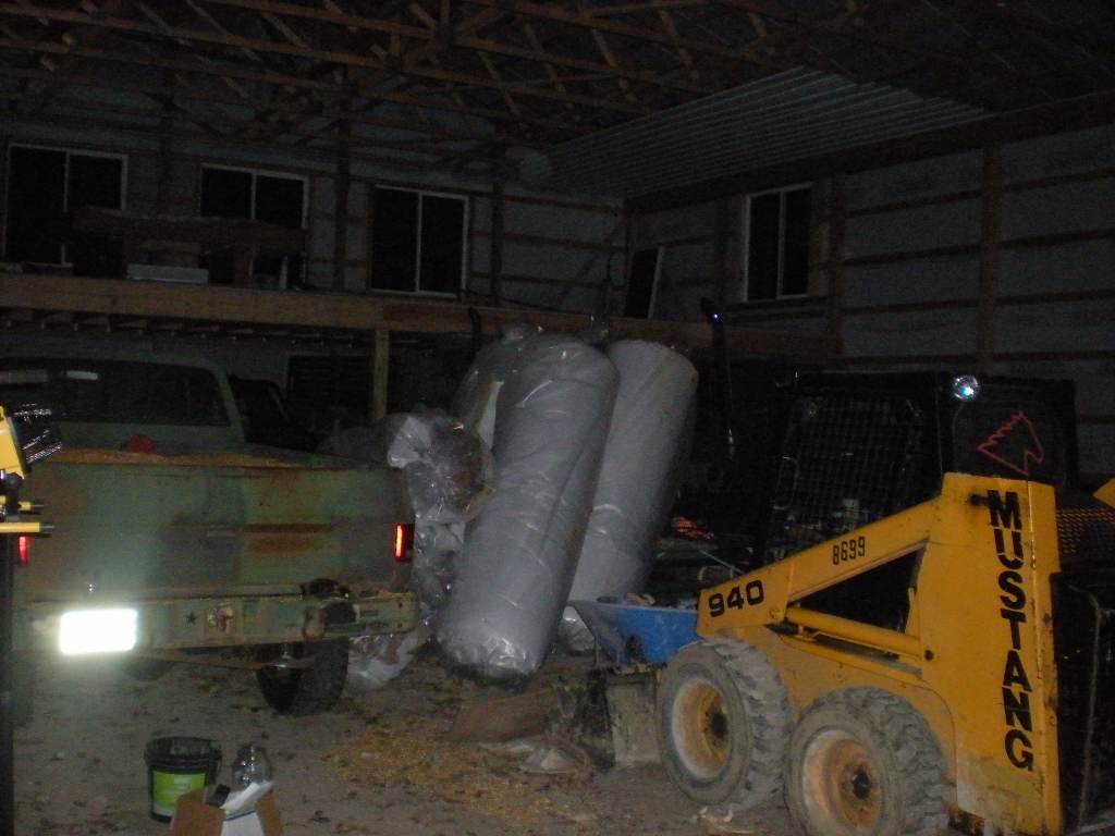

I am not sure how much I will get done today. A friend is on his way over to help me on my pole barn. I was trying to put the ceiling metal up by myself and it was not very time effective. Its 40 x 64 x 16. The sheets are 20'. I got two sheets up and two pieces of insulation in an afternoon.

My dad came to visit today, so I didn't get much done on the tractors other than pressure washing and taking off the fenders. The previous owner sprayed the tractor with fluid film. I am not sure what that is other than a light weight oil. Less than an hour of brush hogging had the tractor covered with grass particles.
I would suggest it for long term outdoor storage but nothing else.
If there is more interest I can post more pics of my barn build. I have been working on it since the July 4th week when I started cutting down trees to make room.

I think someone used lock tight on the plug that covers the diverter. I tried to put some heat to it, but I had no luck. I didn't want to overdo it and mess up some o rings. I put some WD on it and I will try again later. I have been breaking all my 6mm allens even my 3/8 drive one. I thought the impact might help move it, but it is stuck. The one on the 955 has thread sealer on it and it is free.
If I can't get the diverter out, I am going to have to buy some hoses and fitting to loop it or make an aftermarket power beyond.
   / New 955 Need to Swap Power Beyond from 755 #10
