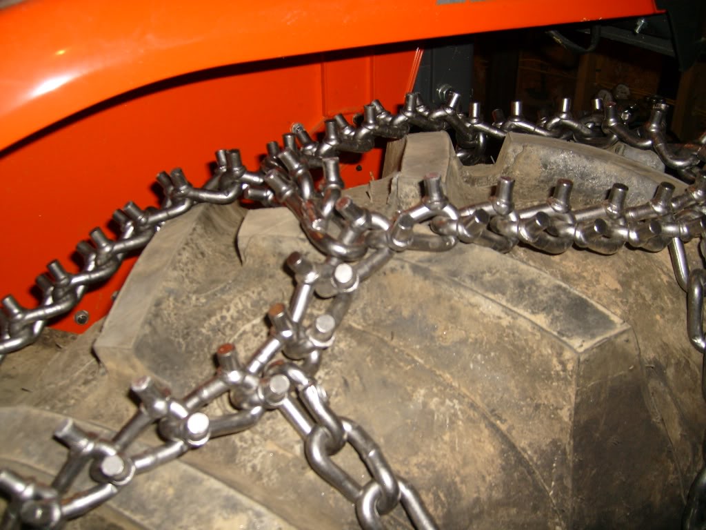

Are they breaking in the same place? I have the same chains but by a different mfg. I can never spell the name correctly, Tellefsdal. Anyway the difference between the two chains is how they connect the cross links with the two chains that wrap around the tire tread. Here's a pic of mine.
If you look at the Talons it looks like the cross link is extra long. I goes from the side chain up around to the tread, turns and becomes one of the two center chains that wrap around the tire tread, then turn again, go across the tread, turn again and now become part of the other center chain, turn once more and head down to the other side chain. They use a welded loop to connect the studded chain at the four locations where it turns. If you look closely I think you can see it in this pic.

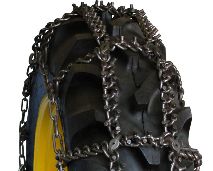

Here is a picture from Aquiline themselves. It looks like they replaced that welded loop with cast steel pieces.
If it's that welded loop that's breaking maybe you can get Aquiline to send you the cast steel links to replace them.

The Talon tire chains I have are like the next picture down that you show with a welded loop that I guess holds everything together. That welded loop isn't the one that breaks, it's them bleeping blanking 9mm studded chains that keep breaking, they might as well made them out of cast iron or aluminum if there going to break that easy. luckily my son found the 2 half's, and I held them together with vise grips while he welded it. looks like they are to brittle and to small, I guess need something with 11-13mm chain on this little tractor, or different brand. This headache started last year when I bolted some chains from the tire rim to the side chain to try and hold them on straight, this year I bought some spring tensioners to see if that will stop the chains from breaking and keep them on straight, will find out soon, 3 strikes/breaks and there off. Right now it's looking like I have to spend another $5-800.00 for tire chains again, not happy about that.

Boy I am glad I got the Norse Tellefsdal chains like Al's. I am having no problems for 10 years and mine are only 5/16" ( 8mm ). My L3010 which is the same size as your L3400 has 12.4 X 24 R1s and weighs about 5000 lbs with loaded tires and loader. Do you have them mounted to tight ?? They need slop. Those little links are quick couplers. So many on there some will come off for sure. I wouldn't like that.
Edit: Looking closer at Al's picture it looks like the links have the drive pins in them - They won't come off.
