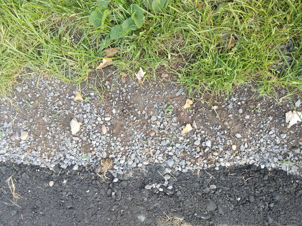

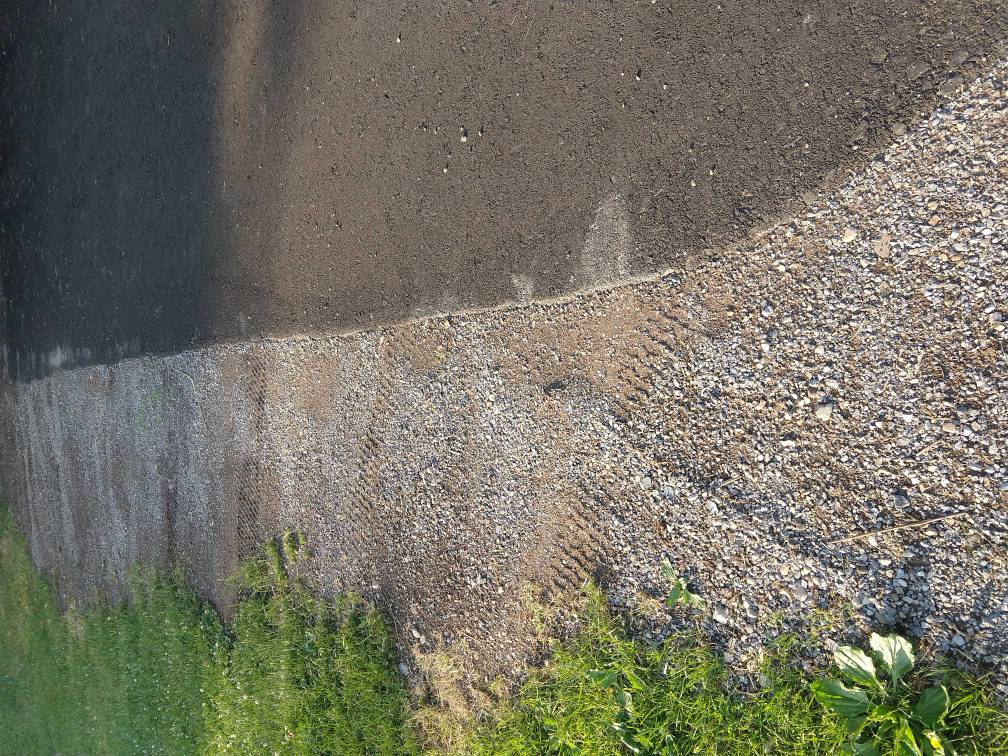

We just had our driveway paved, they strongly recommended that we wait 3 weeks to let tractors or the trash truck on it.
When they did the parking lot at work (forklift and semi truck traffic) they kept everyone off of it for a couple of weeks.
One thing you can do to greatly increase the longevity of the edges is to slope dirt or gravel up to the level of the driveway all the way around.
Ours ended up like this:

I’m definitely going to reinforce the edges. Loam and seed where I won’t be traveling over it and gravel where I will be. Thanks for photos guys.
