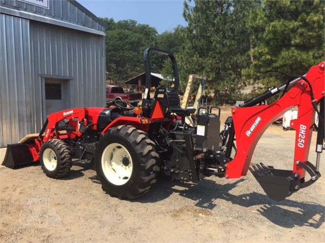

Was suppose to be coming. Now its on backorder. Dealer says Friday a cargo container will unload in L.A. so he thinks Monday. Must be a few of these out there somewhere. I see them on a few tractors being advertised..Again lost on the specs. Theres no info on them.

I just took delivery of my 4720H with the BL200 and BH200. I've put a whole hour on the tractor so far, so not much to offer. The hydraulics are still pretty sticky making it harder to operate smoothly, but I'm sure they will loosen up in time. From the specs I found, the big change in the BH200 is the breakout force being increased to over 4000 pounds. I found one loose bolt on it (after dealer setup) but other than that I really like it. The other big thing I noticed is that they have added a step on both sides, so you no longer need to step up on the outriggers. I had complained about the lack of a step a couple of months ago comparing it to the Kioti tractor, but obviously decided I liked the Branson 4720 more than I liked the NX-5200 Kioti. A lot of the things that made my decision were small, like the quality of the step on the tractor and the fact that there is one on both sides, the location and size of the mirrors, silly little things that Branson seemed to get right and Kioti just missed.

My BH200 doesn't really have any "steps". There is a little ledge that I can shimmy up, though. As for the specs., The BH200 is almost completely identical to the BH76. I posted a pic of the specs a week or so ago. I have about 9 hours on my tractor now, but only about 1 on the BH. The rest has been clearing brush with the FEL.

I bought a bh250? I,m not sure if or what it is yet, it may be the same as the 200. Monday or Tuesday I,m hoping to have it. Anybody seen one of these at a dealer? California and Georgia have gotten some. Anybody know if there's any difference b/t the 200 and 250?

Specs from the manual on BH-200:
Digging depth - 91.2"
Reach from center line of swing point - 123.6"
Loading height bucket at 60degrees - 90"
Maximum leveling angle - 10 degrees
Swing angle - 180 degrees
Transport height - 85.2"
Transport overhang - 46.8"
Bucket Rotation - 149 degrees
Stabilizer spread down - 88.8"
Stabilizer spread up - 68.4"
Angle of Departure - 21 degrees
Shipping weight less bucket - 1340 pounds
Bucket Digging Force - 4554 lbs
Dipper stick digging force - 2530 pounds
Operation pressure - 2346 psi
Available buckets - 9', 12", 16", 18", 24"
