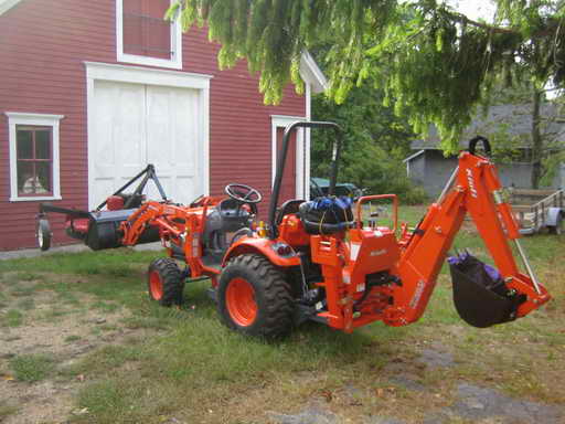

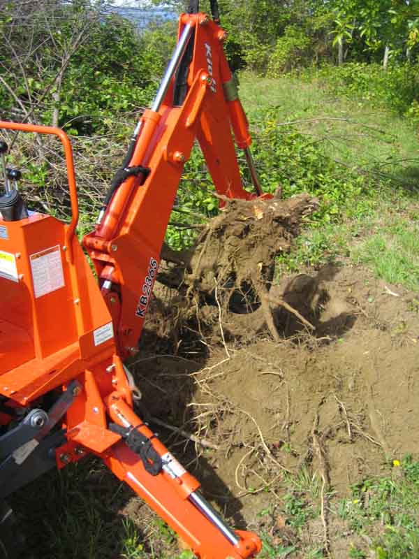

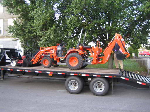

Your backhoe looks very much like the Kioti BH for the CK series. I have the KB2365 (6.5 foot model) which is subframe mounted and uses tractor hydraulics. I like the unit and it has performed well. I wonder if it is the same manufacturer given the Korean connection.
It wouldn't suprise me if this company did some oem hoes. The opportunity is certainly there with Kioti, LG, TYM, Kukje. I definitely feel the South Koreans make some top shelf stuff.
