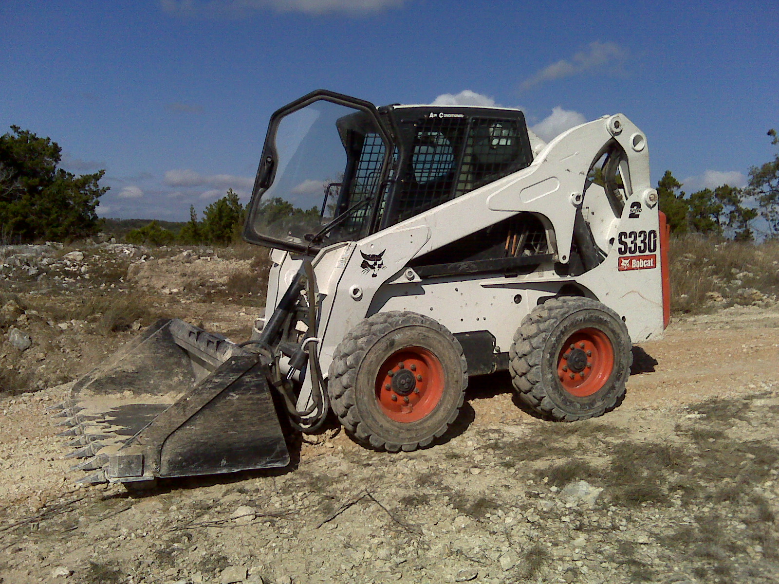

How do you like the big hulk tires in comparison to the originals. Could you post a pic?

Hulks or the equivalent blow away standard tires. I work in a lot of rock and they grip incredible and hold up. I can get over 2k hours on a set of tires! I'm at 1000 now and more than 50% tread left. One hole, plugged it. Run with slime instead of solid fill which is a smoother ride. I downsized from the 330's original 14-17's to the standard 12-16.5 so my machine looks identical to an s300 but it's a 330.
