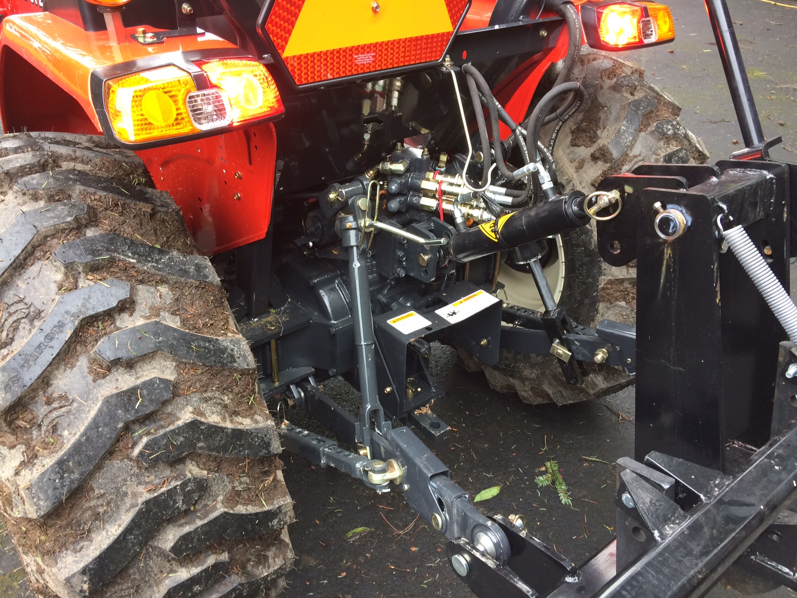

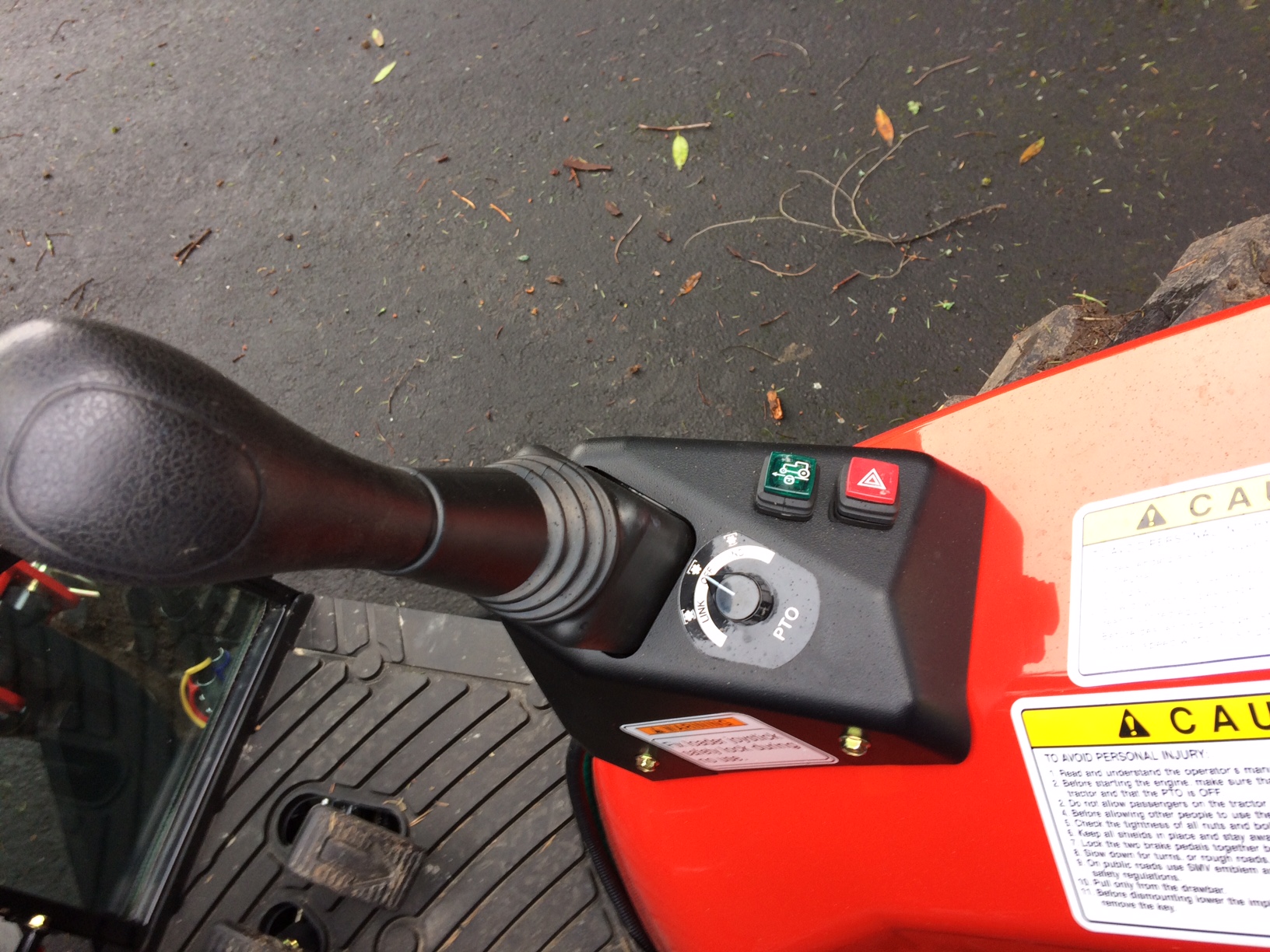

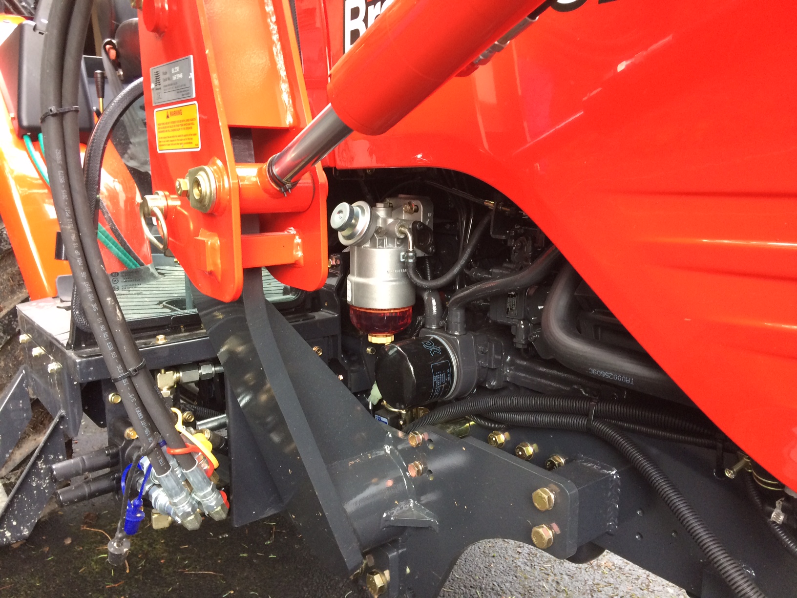

Finally got a day when I was home and the light wasn't too bad. It's been raining a lot here. Pictures show the 25 series' left side adjustable 3pt link (I see I left the handle lock unlocked) and two factory remotes. I got a dealer added top and tilt. There's a larger fuel filter, dashboard that I think is a little different from the 20 series, and the moved PTO, cruise and 4-way flasher switches.

Question: In your second picture I see something orange on the right side. Is that the trans/hyd fill cap or is/does it have a second position control...depth setting control back there at the 3 pt. If so, PERFECT. Would be like my 6530.
For you folks thinking about a purchase, take a second look at the second picture. Notice the lift arm extensions (standard), the lift arm sway stabilizer arms, tube and slot with a locking pin. If that tractor has the position control I asked about, you will be hard pressed to find an easier tractor for one person to hook up implements.

If I may butt in and answer on Eric's behalf, it is the fill tube plug for the hydro.
Sorry, took me a while to even realize what you were asking about, you have sharp eyes sir. I have same tractor and had to study the pic to even see it.

Yep its one of those question mark shaped fill plug/vent things. If the pic was from the other side you'd be able to see the whole thing.
A second position control lever back there would be useful. I walk forward a couple steps and reach over the fender now. It looks like there's room to make a simple rear position control linkage if one wanted it enough.
I'm loving the Pat's Easy Change system. That's super helpful too. They add about 3.5-4" to the length of the lower arms but that hasn't hurt me in any way with the attachments I have.

Thanks for the compliment sir but on my 6530, the UTF fill plug and the knob on the lever I mentioned are both orange. Could only see the color, not the outline of the object.
