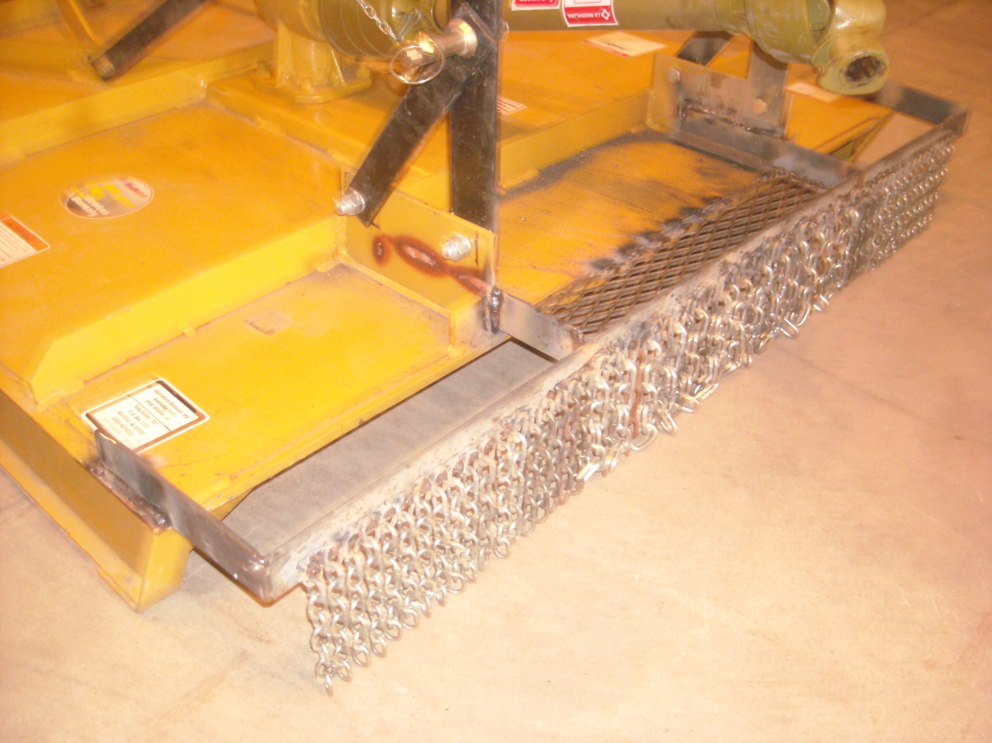

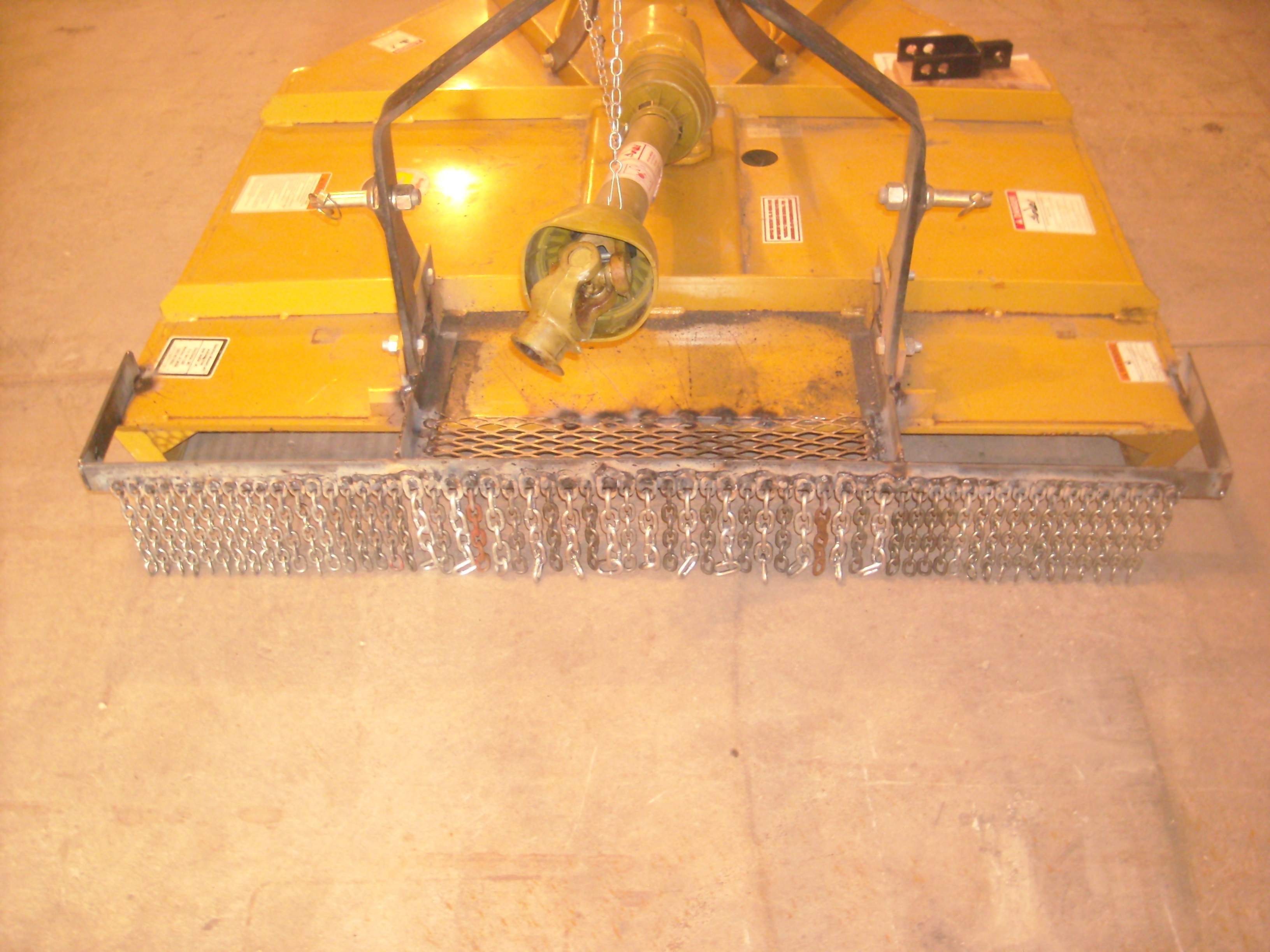

I just purchased a used Bush Hog 480 for by BX24. It doesn't have either a front or rear deflector. Reading this thread I understand that chains are the answer. Does anyone have plans or a picture or two to show how they build theirs?
   / New Bush Hog Chain guard necessary??? #18
I built a chain guard for the front of my KK lite duty 5 footer over the winter. I just finished doing about 3 acres of brush hogging with it. I went through some pretty heavy brush (up to 3" stuff) and it held up just fine. I am not sure how necessary the front guard is....but I figure if I can see the blade tips from the tractor seat (without a guard) then those blades could hit me with some trash....therefore I now have a guard....and no problems to report. I made mine from some scrap chains and about $35 in steel. Just remember to postion your chains so that they don't drape back into the cutter blade (as shown by my pics)....or they will be shortened for you. I was not as concerned with a rear guard....as I will keep people away when brush hogging...and my land is pretty remote. BUT....trash DOES FLY out the back of the cutter FWIW. Good luck.
