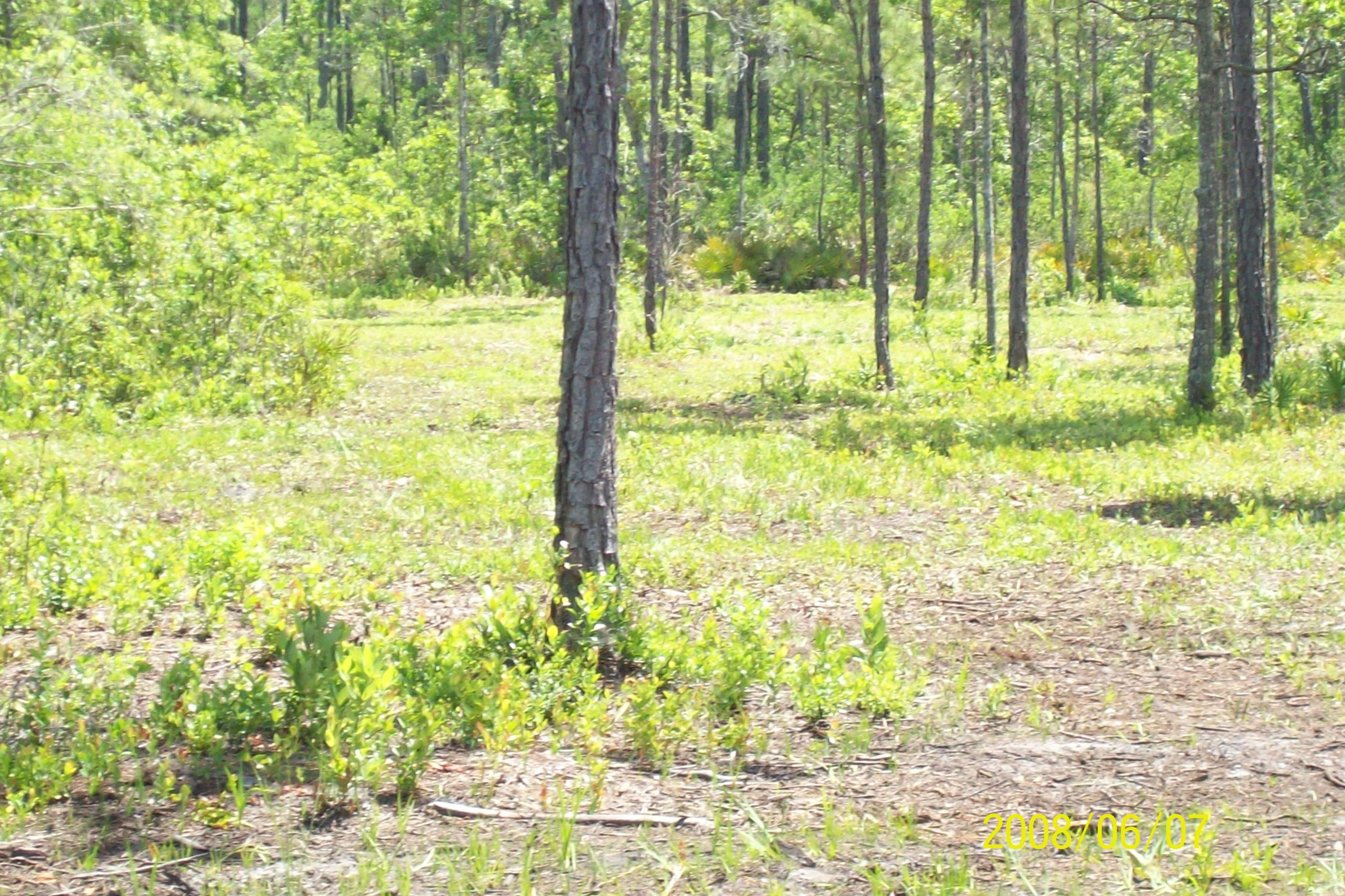

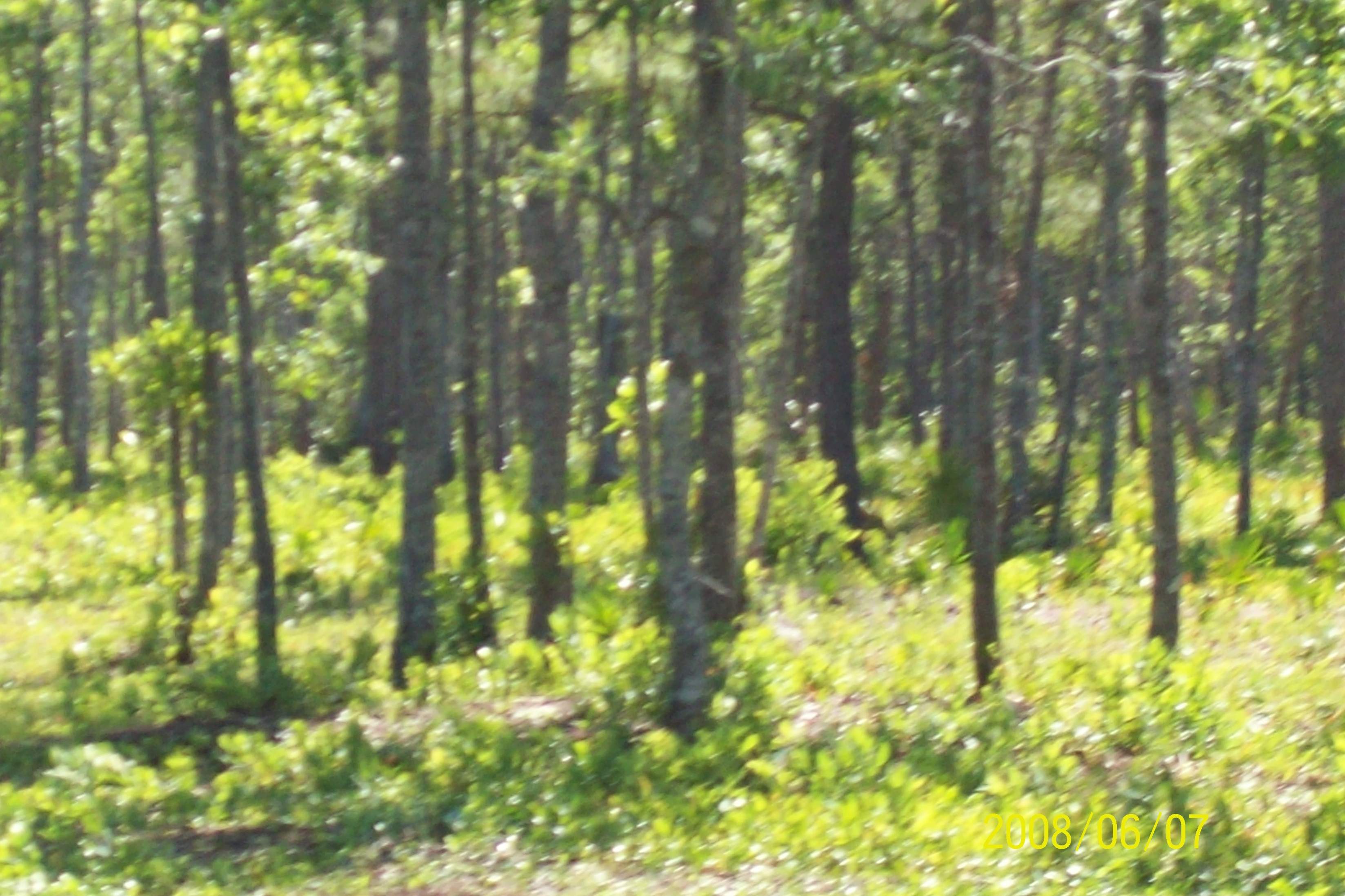

Maybe look at a yanmar you might save enough to buy a nice Zturn for the yard too I have a YM1700 the thing is a work horse If you went a little bigger 4wd with fel you prob would be very pleased i did this with my 1700 and a 4ft bush hog there is 7 ac there almost took all day and welcome
