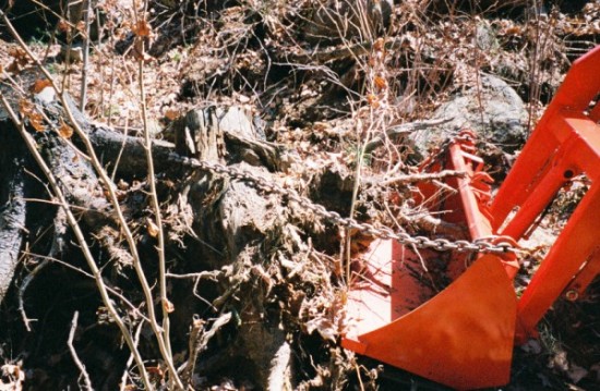

I had the dealer weld chain hooks to the bucket and they did a great job. You can see how they welded them on with this shot. I use these hooks so often I wonder why they are not standard. Other than moving dirt or wood chips I use a chain attached to the bucket.

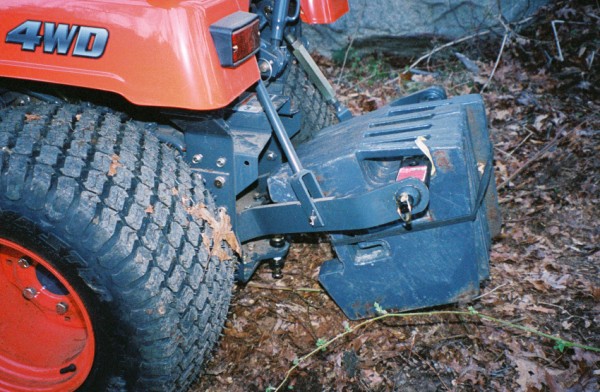

Here was my solution, 250 lbs. of ballast. This did the trick and the whole tractor is stable when using the bucket with heavy loads. Of course they sold me suitcase weights for the front of a tractor. I found if I put a threaded rod through the center (not shown) and a 2x4 piece of wood through the handles with the drawbar, the weights are well balanced back there, take up very little room, and provide the stability I needed.
