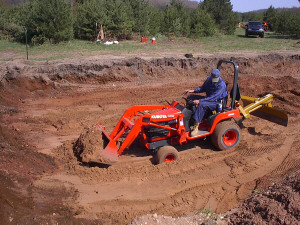

My two cents. I think it has to do with peddle position. And/Or inital load. I to have had it not move or load up when trying to move forward under load. And yet when working with the loader it will almost stall. It has something to do with how I approuch a high load situation. It seems if I am all ready moving into a high load situation the engine will load up and if I am starting into a high load it will just sit there. does that help any? All I know for sure is this little tractor compared to other hst types I have owned ford, case is far and away done more than I thought possiable. Have fun /forums/images/graemlins/smile.gif
