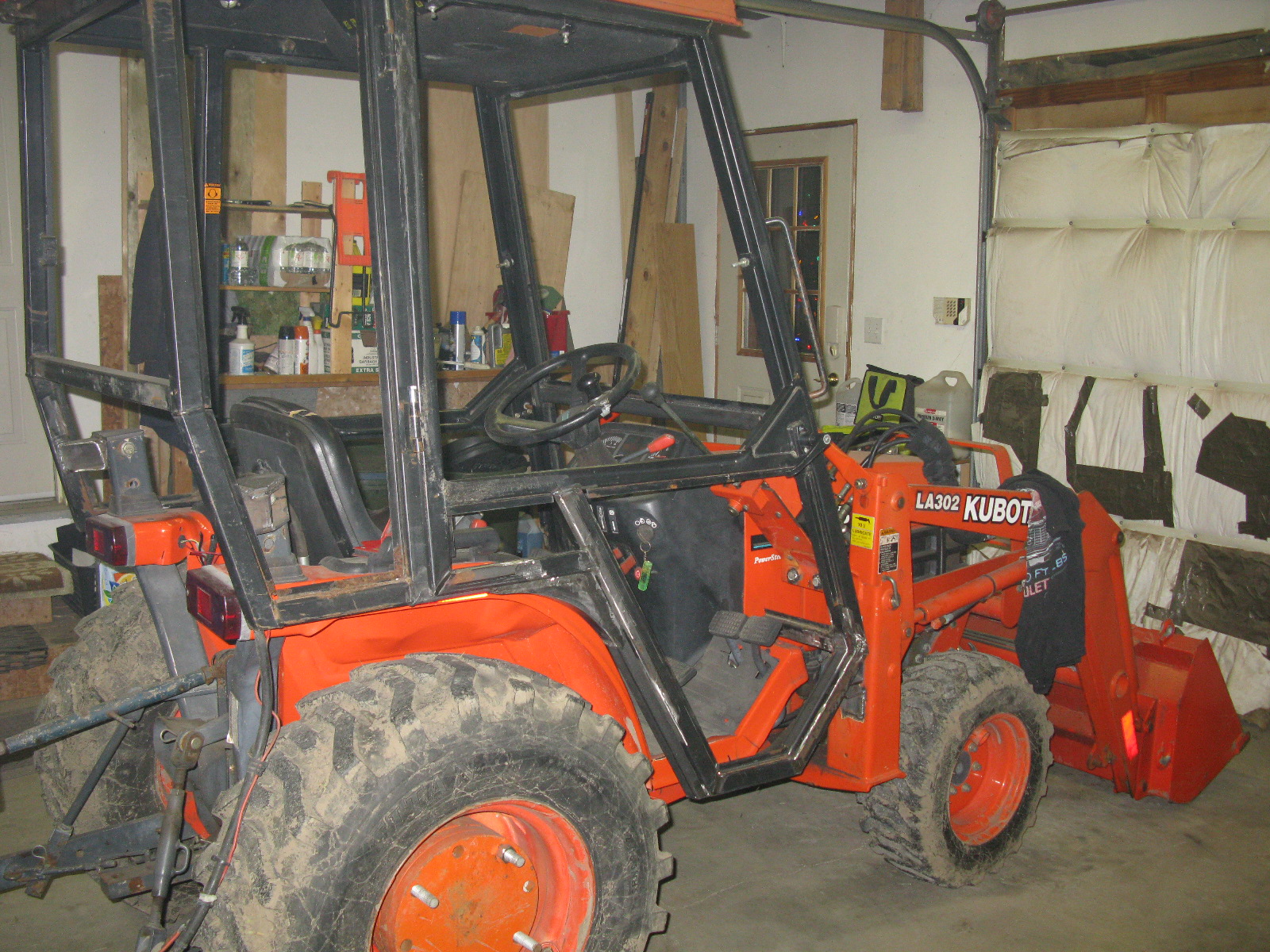

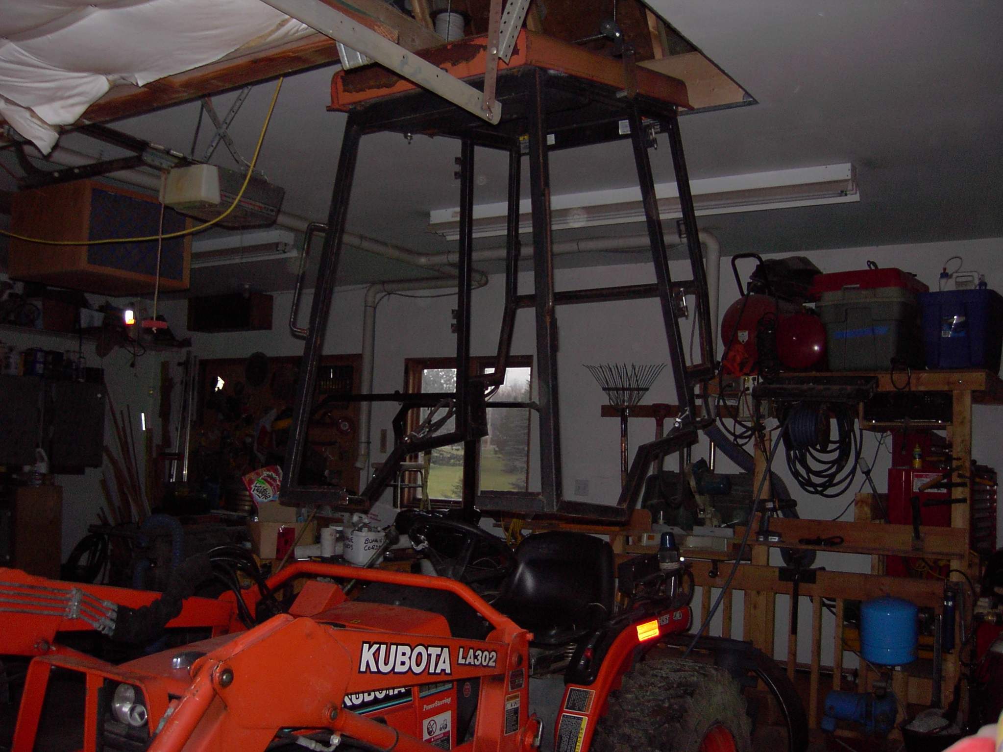

After following a number of threads on building cabs I decided to jump in and build one for my 2002 Kubota B7500. I found a used Joedale Perry cab on Kijiji from a Kubota Front mount mower series tractor. The seller was very helpful answering all manner of questions and sending me detailed measurements. The seller was even so helpful he delivered to cab to me (from 5 hrs away ) while on his way through snowmobilin. The first order of business was to add an attic hoist to my garage to allow me to lift the cab on and off the tractor while fitting it up. The opening into the attic is actually large enough to raise the cab into the attic to drive the tractor in underneath the cab. The attic hoist took a little longer to complete than I expected but works like a charm. I made up a bracket to mount to the cab lift point and did an initial test fitting. All the measurements the seller took were bang on and the cab fit as expected. The lower section on the cab was cut off and new lower section mocked up with 1.5" square tubing 1/8" wall. The cab uses the rear ROP mounts and new front mounts fab'd to the loader arms.

Definitely cut down on build time. The front mounts are done and the sides are welded up. Rear mounts welded.

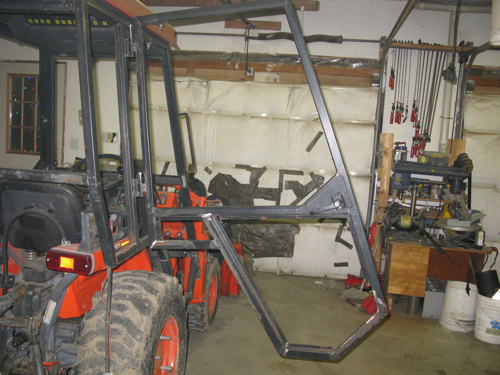

I'm afraid my welding and fab skills aren't on par with mjncad's but I'm hoping it will stay together. As for the glass guy, I have a wizard of a glass guy, he disappears through the week though. As able to spend some quality time but myself today, work in the garage. got the front window sill put in and a lower window framed, added a radius the area above the fenders and shortened the doors.

I'm ok with the big stuff, its all the little finishing detail that will slow me down. Trying figure out a way to do the front wall in one piece and be able lift the cab straight up and off. The loader controls are in the way and don't really have enough hose length to pivot them out of the way if I unbolt them. The next issue is along the same lines how to seal the area between the cab sides and the fenders? I think I'll either weld on filler metal or bolt on and make it removable and then add car weather stripping.

Was able to get one door welded together today. The original doors use 3/4 by 1 1/2 rectangle tubing everywhere I looked for it told me they don't carry it or they can get it but it will be pricey. I bought 3/4" square tubing to make the rectangle tubing but was able to salvage what I needed for the door from the original waste. All in all a productive weekend for a change.

Looking at the picture in your last post of the cab being suspended by your attic hoist reminds me of a Star Trek movie where the Borg queen's head and neck are lowered onto her body. :thumbsup:
