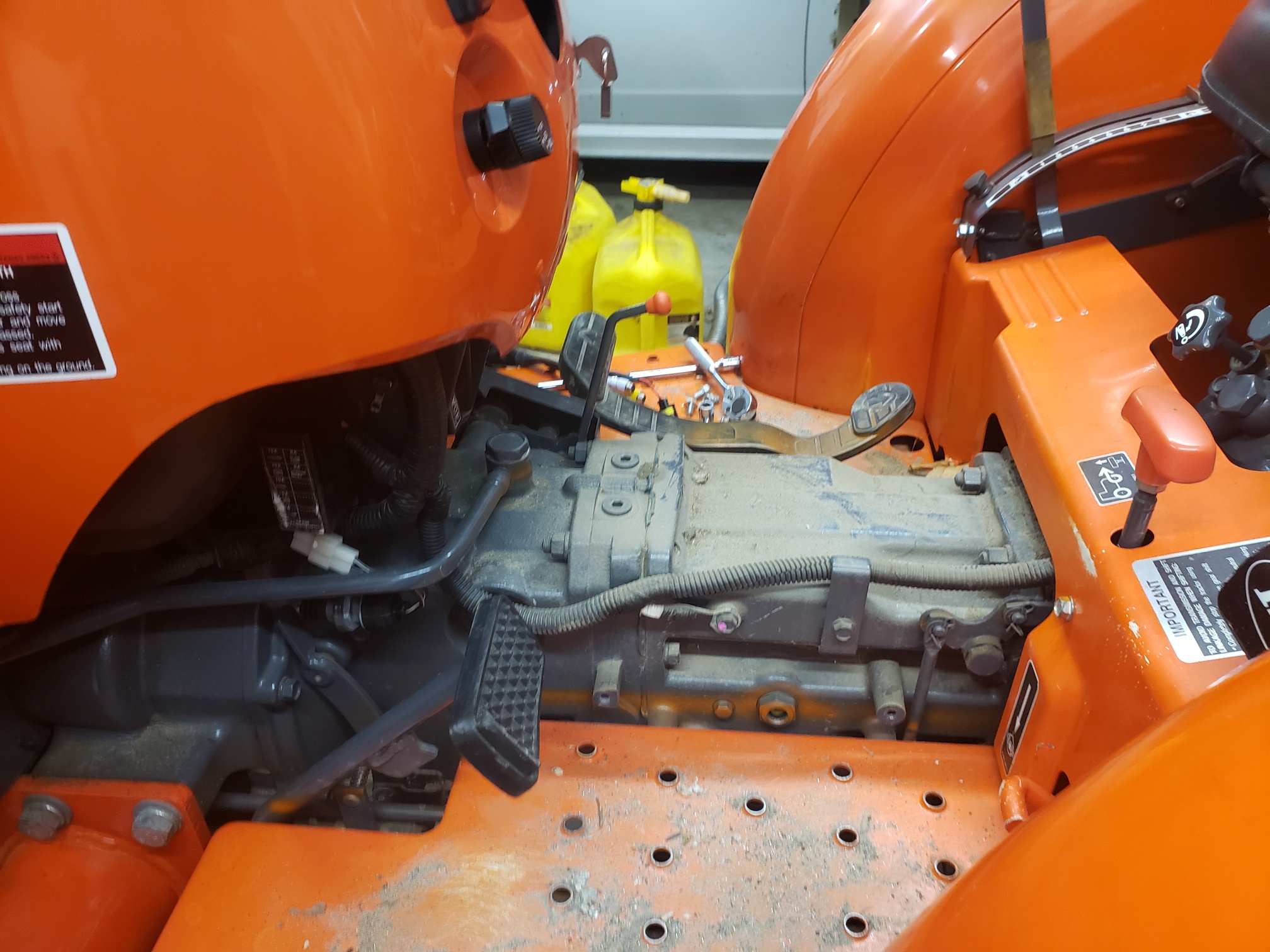

With my recent cervical fusion I'm not quite as 'head flexible' as I used to be. My current project with the tractor is regrading my driveway that is requiring a lot of swiveling in the seat. So I decided install a rear facing camera.

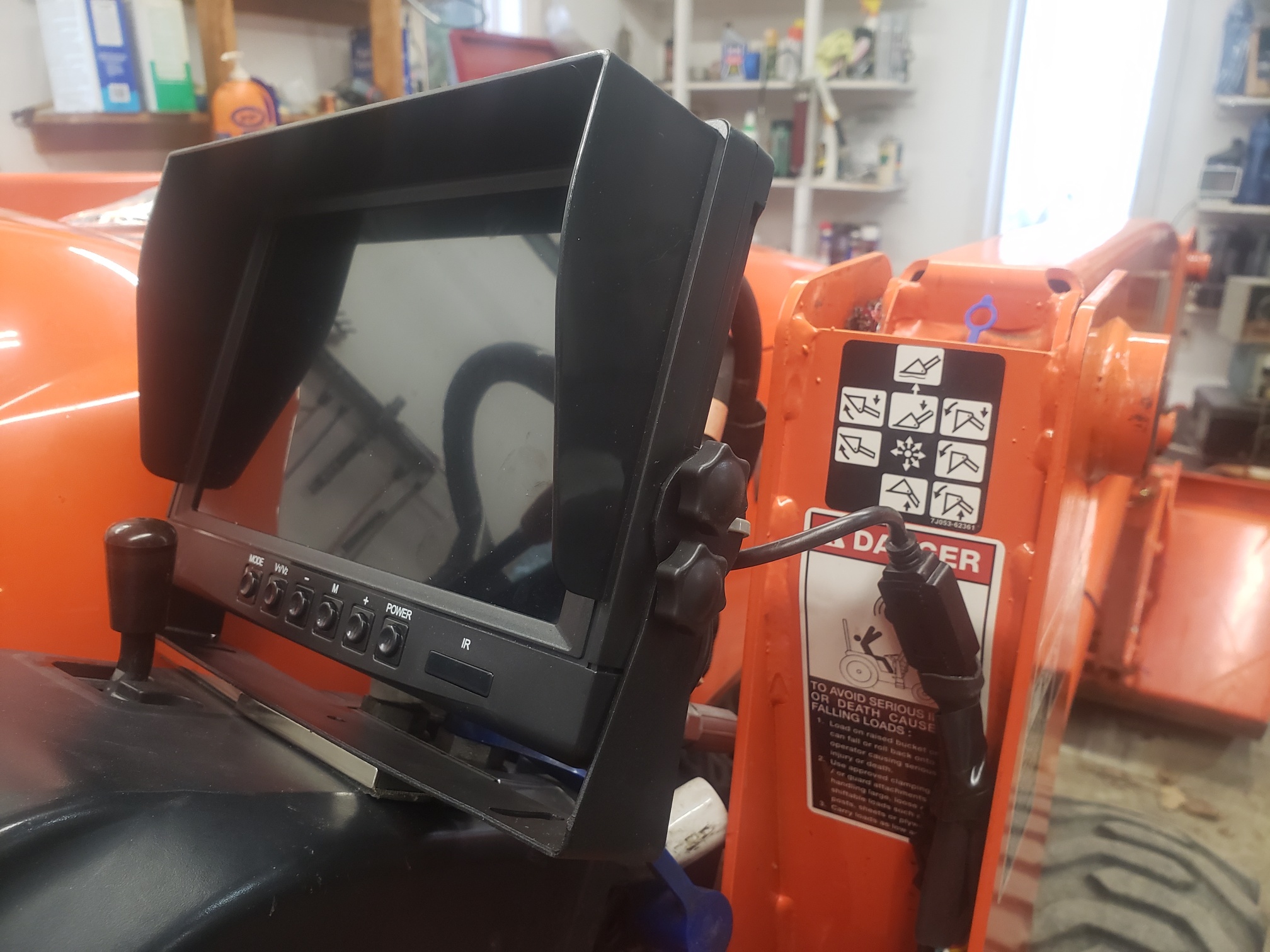

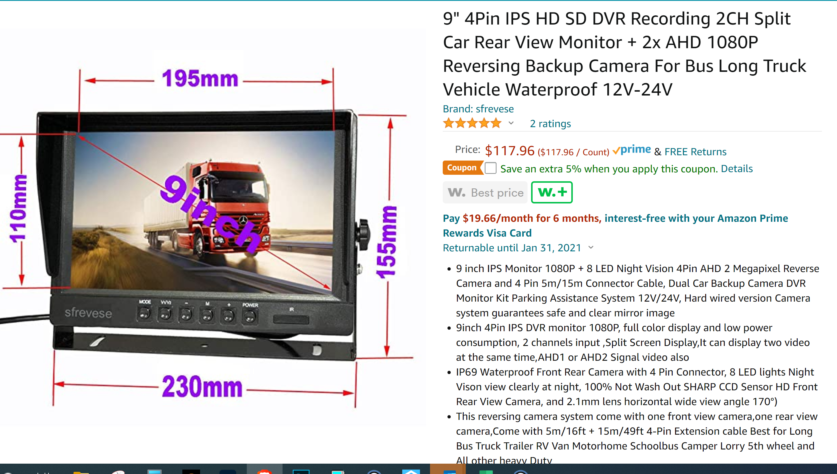

Note I don't operate the tractor in the rain. The monitor is NOT waterproof. That said I did make the install in such a way that by unplugging the 3 connectors at the monitor end I can remove it completely. Here is the unit I went with:
I chose to mount the monitor on the FEL valve plastic cover using strong magnets with foam tape at the bottom. This makes removal easy. The magnets:

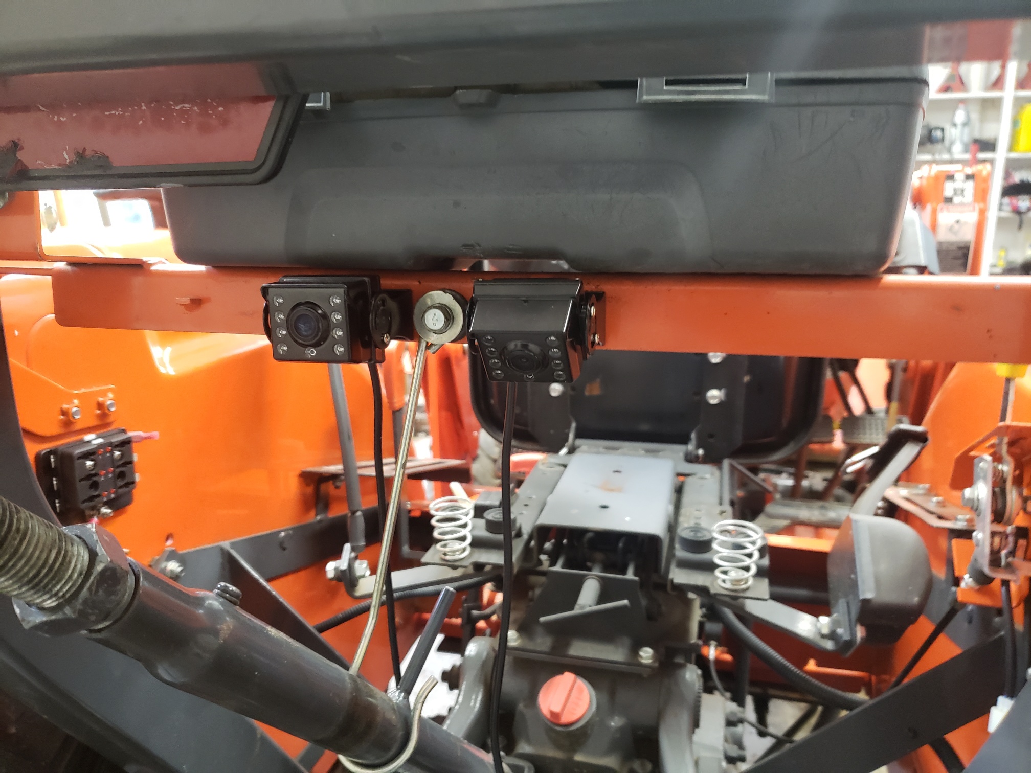

The two cameras the system came with I mounted on the bar supporting my toolbox. One faces down at the 3ph implement, the other pretty much straight back:
I sleeved the 3 cables (2 camera, 1 power) in split loom and ran it under the 'hump cover' next to the existing wire cable (going from fuse block area to rear of tractor). This was areal pia getting that cover off n on again.

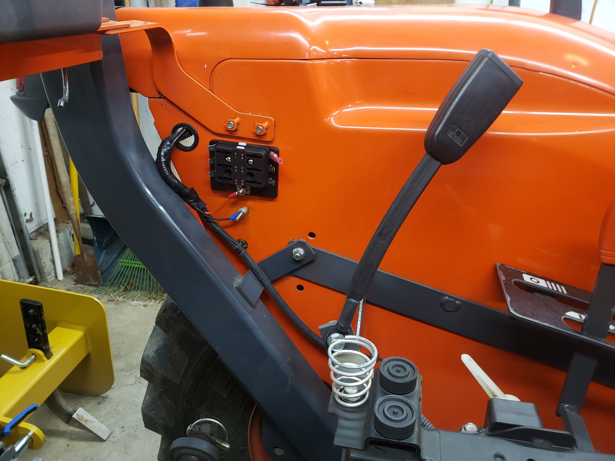

I also mounted a 6 position fuse block on the inside of the rear fender to power the camera and led work lights I'm putting on later.

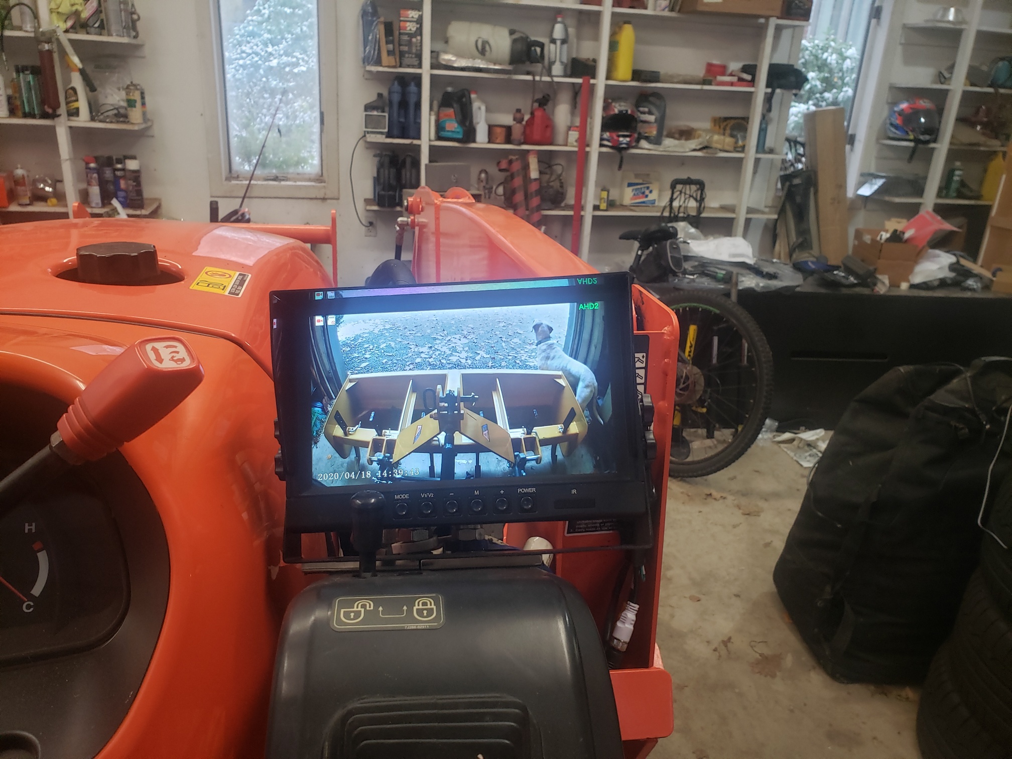

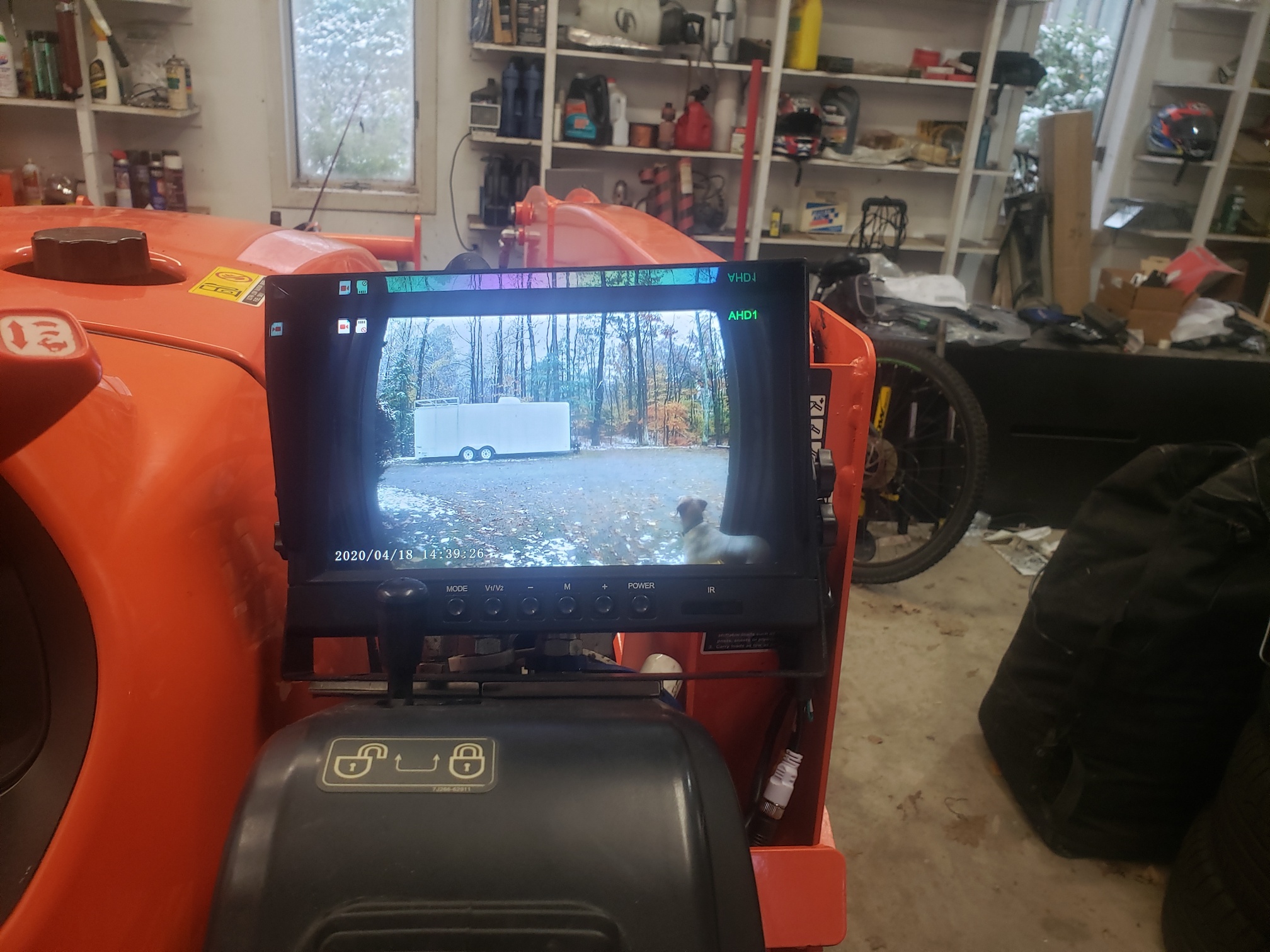

The final results

Nice work!! Sure going to beat looking over your shoulder all day.
How do you find the distorted view when backing up? Do you get used to it or is it hard to judge when the box blade is too low or too high?

As soon as I saw the unit records, I put my order in. :dance1:
Better hurry, they're going fast.
Here's the link: Amazon.com: 9" 4Pin IPS HD SD DVR Recording 2CH Split Car Rear View Monitor + 2x AHD 18P Reversing Backup Camera For Bus Long Truck Vehicle Waterproof 12V-24V: Beauty
Added: Not only does this unit record (128GB) but also allows a split screen view. I was sold when I saw that.
In the split screen mode you can make them side by side or over one another - with appropriate cropping. I really only NEED the implement view so will probably keep it on a single camera.

Well my work with it is limited. I just finished it today and it was raining before it started snowing. I did make a run to the mailbox and practiced backing up a few times using the camera (btw I adjusted the angle downward a little more than what shows in the image here). I was able to raise n lower the box blade to just above the ground every time. I think with some practice it will work out well. I remember tho that a single lens has no depth perception :(
