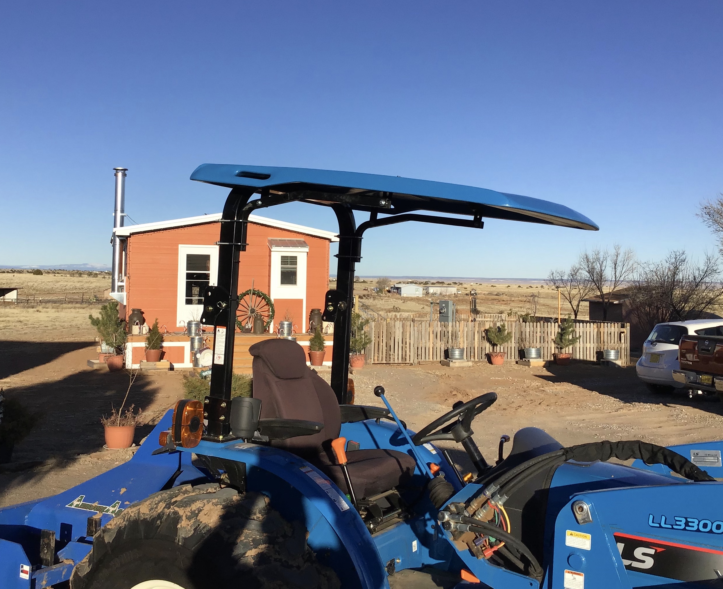

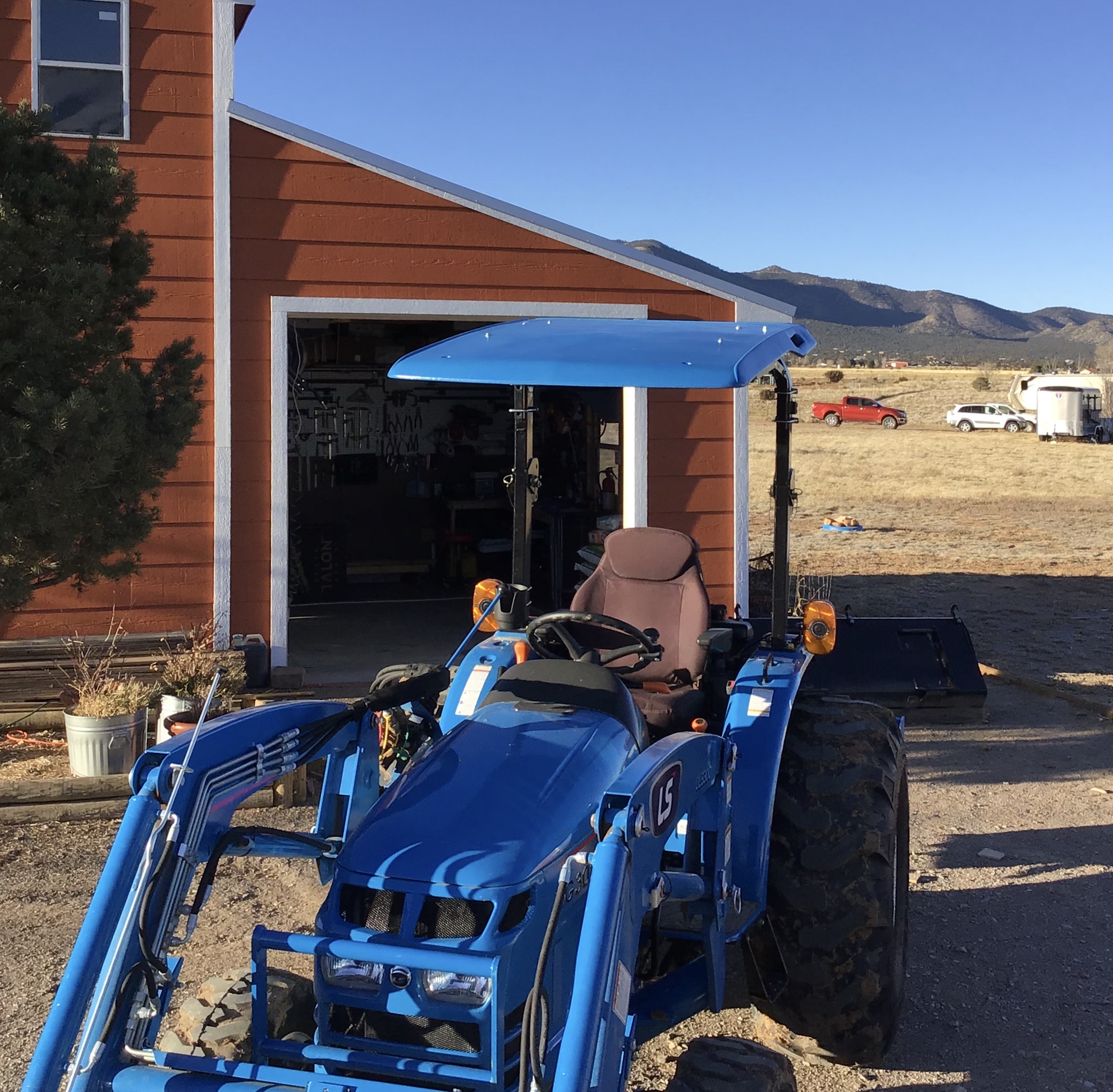

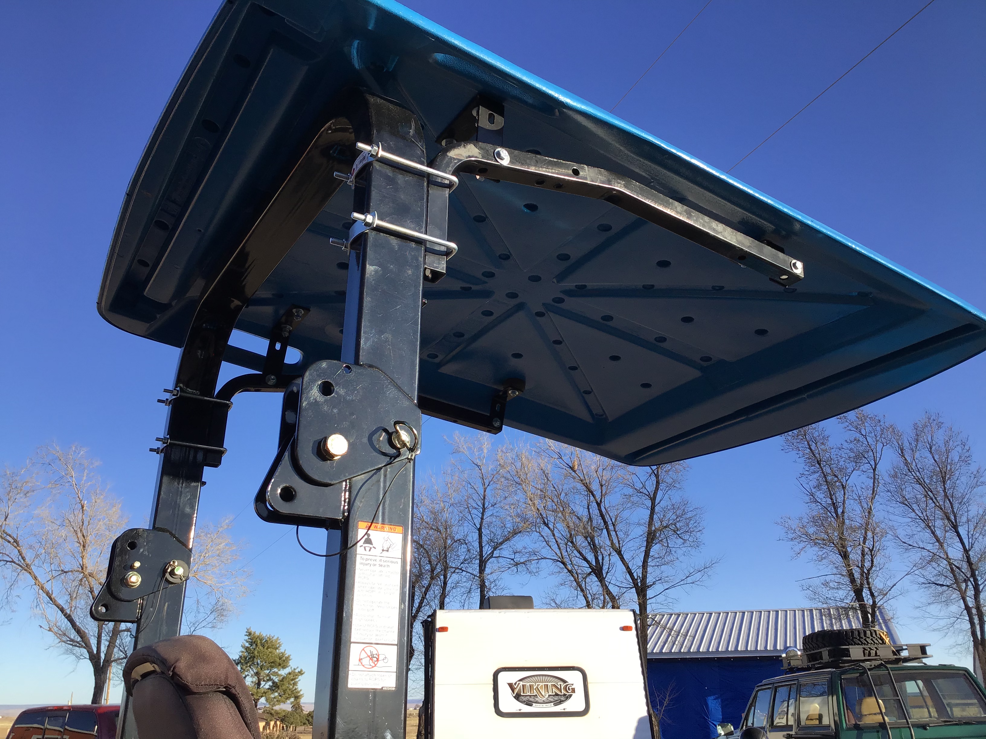

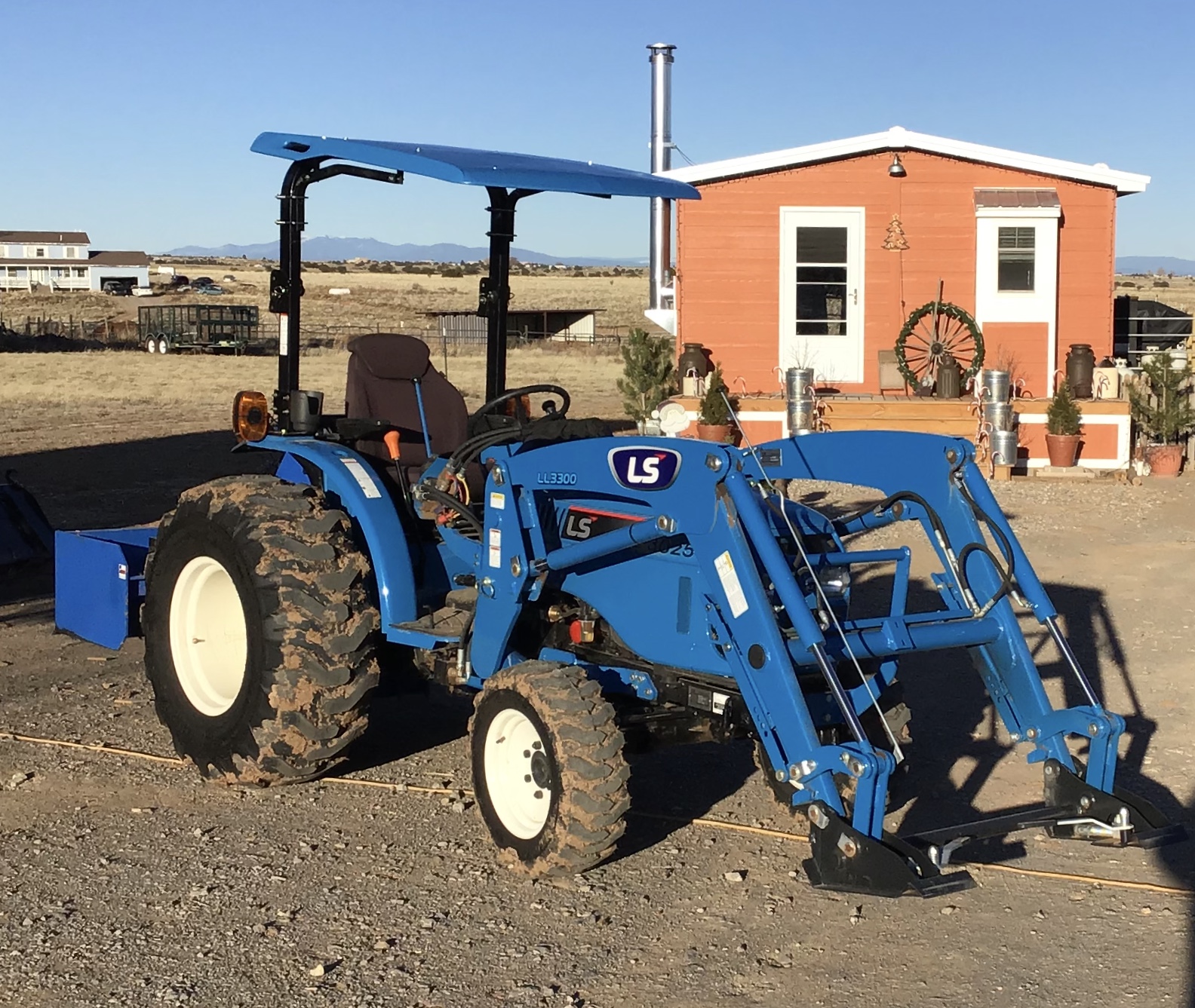

Thanks for all the compliments! Took it off, painted it to match, and back on! I am very pleased how it turned out!
I have already decided on the next adaptation. I will mount some slightly larger square tube onto the ROPS, then the canopy mount tubes will just slide down into. That will make it easy on / easy off by just lifting.

Ted, what did you use for paint? I may have finally found one.
   / New canopy (well, old parts)
#15
Paint that is a perfect match is Rust-Oleum Safety Blue. I have sprayed it on some scratches on the BH boom and blends / matches perfect. (Be careful with the name... there is another blue that is real close, (royal blue) but does not match).
It is available in spray can and in quarts / gallons. ( cheapest I found in stock was at Lowes)(buying a case of 6 made it $4.99 a can). I used 2 1/2 spray cans for the canopy, but I did primer it first.
