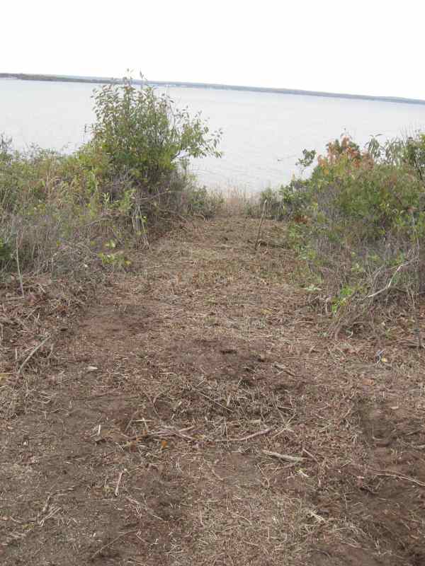

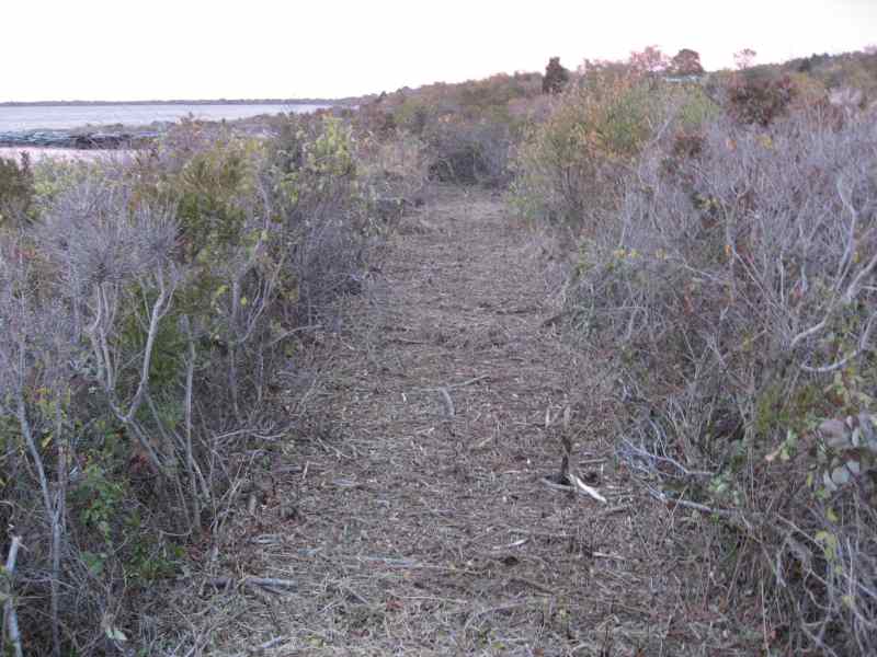

Are the brush "stumps" left by the flail pretty well mashed or rounded, to the point that they don't puncture tires too readily?
The flail tends to shatter small "stumps" on bushes so they are not like punji sticks at all but look like someone drilled a hole in the middle and stuck in a firecracker and exploded it. The material is still there but it is ragged not sharply cut. I have not had any trouble with punctures but I have R4 tires which are very puncture resistant. Not sure what R1s would be like.
