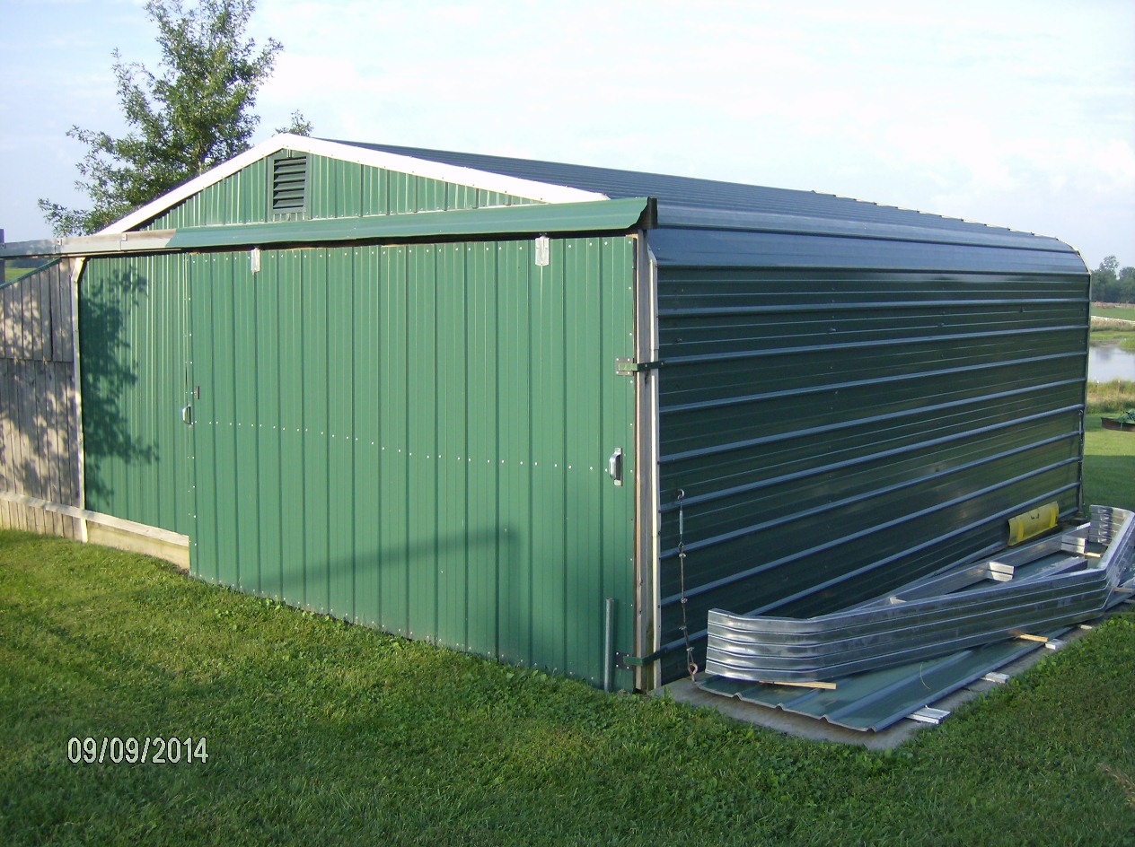

I had one put up several years ago by "Tri-State Carports". HPIM3182.JPG I later enclosed it myself & added a woodshed lean-to on the south side.

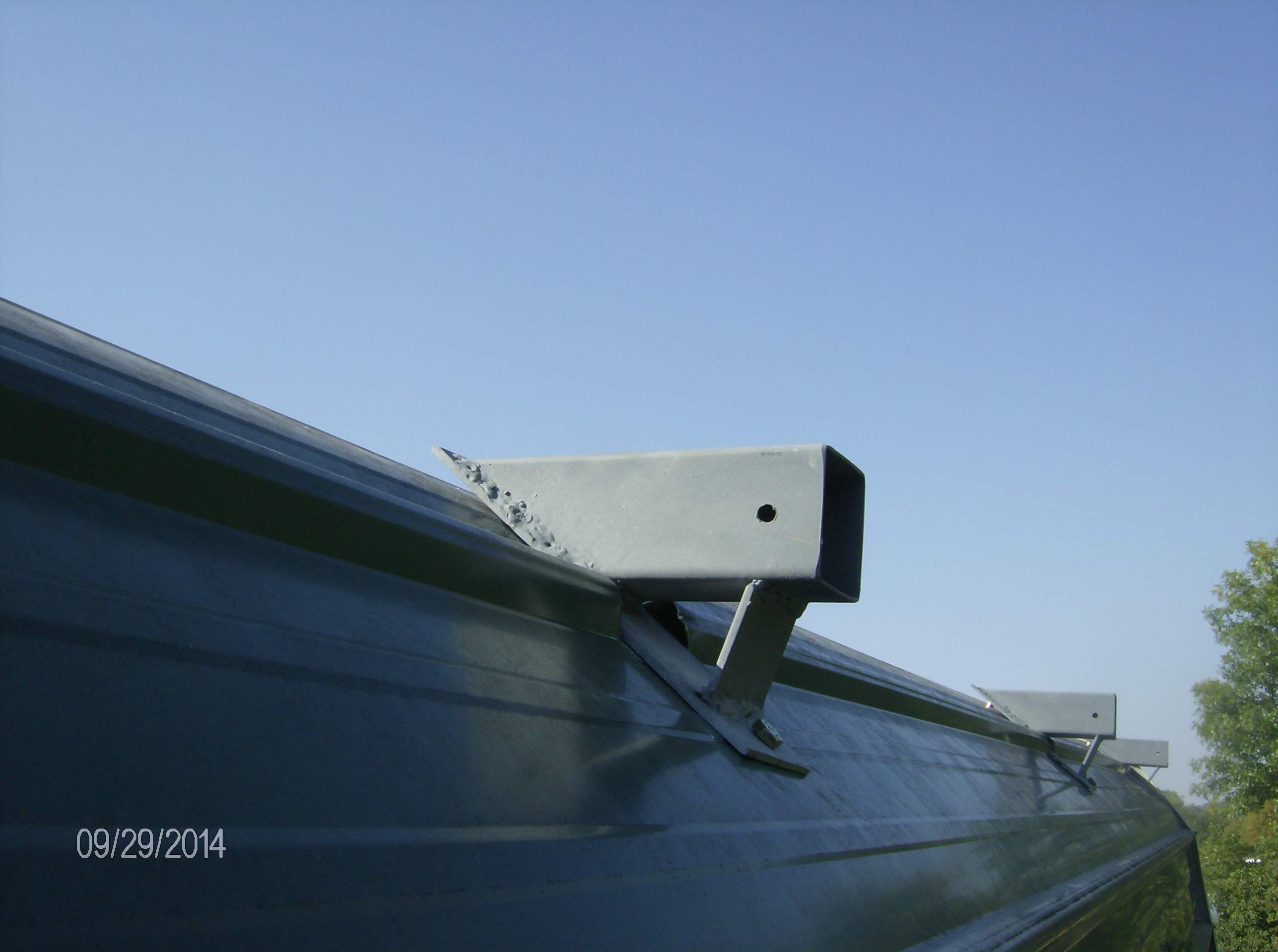

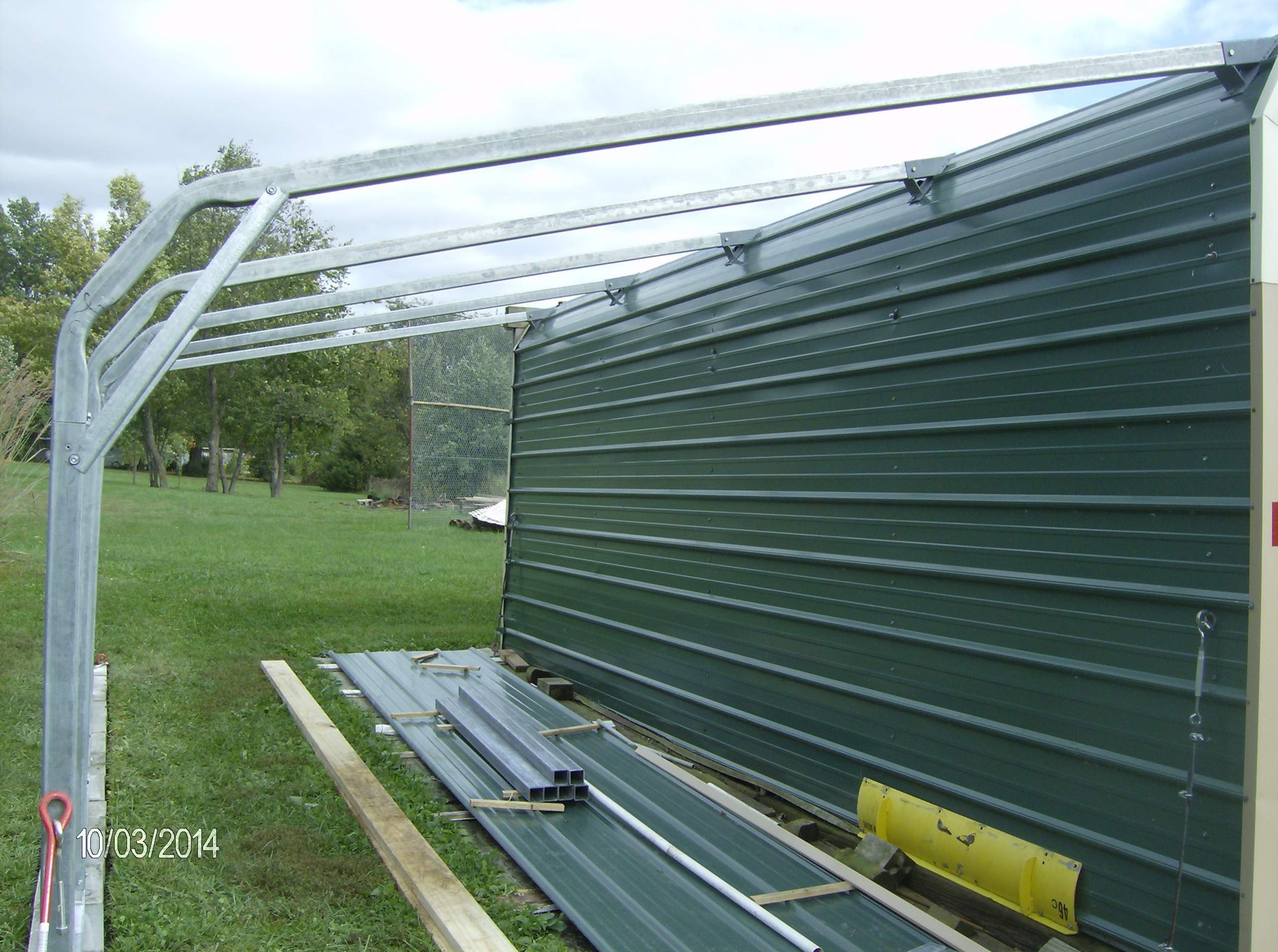

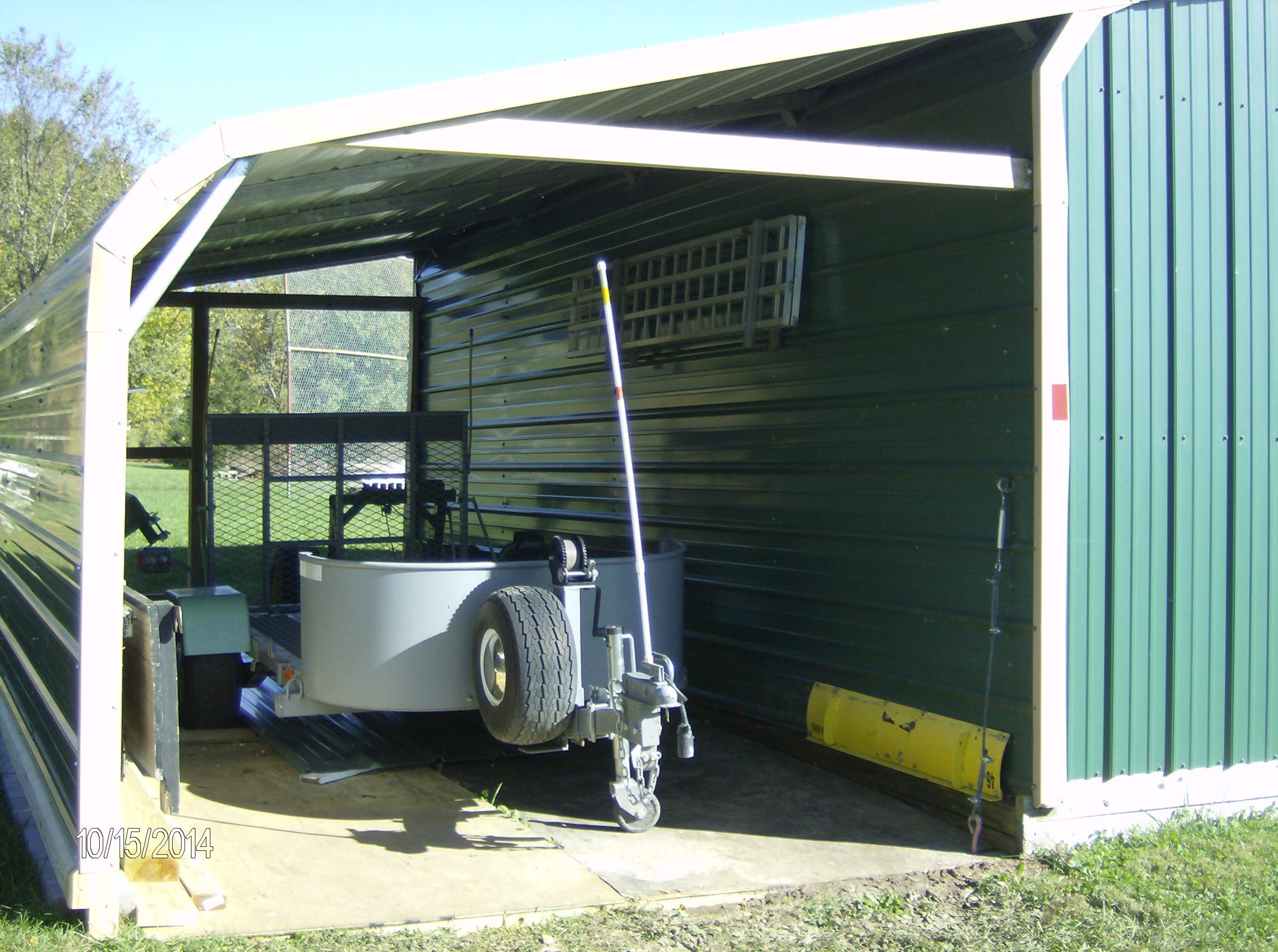

This fall, I ordered another one from "Elephant Structures" (another Caroline Carport name) as they were the only ones I could find that would sell me one not set up. The plan was to add another lean-to on the north side of the current one. I made brackets to bolt to the current frame: HPIM1338.jpg Cut the frame bows in half & bolt them into the brackets: HPIM1341.jpg I intend to pick up the metal locally tomorrow to finish the lean-to: HPIM1353.jpg

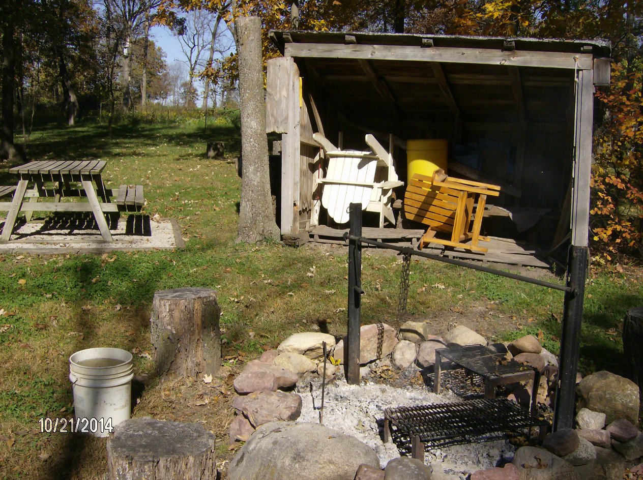

The other half will be used to make a 10' x 18' shade over the picnic table at the farm: HPIM3255.JPG
