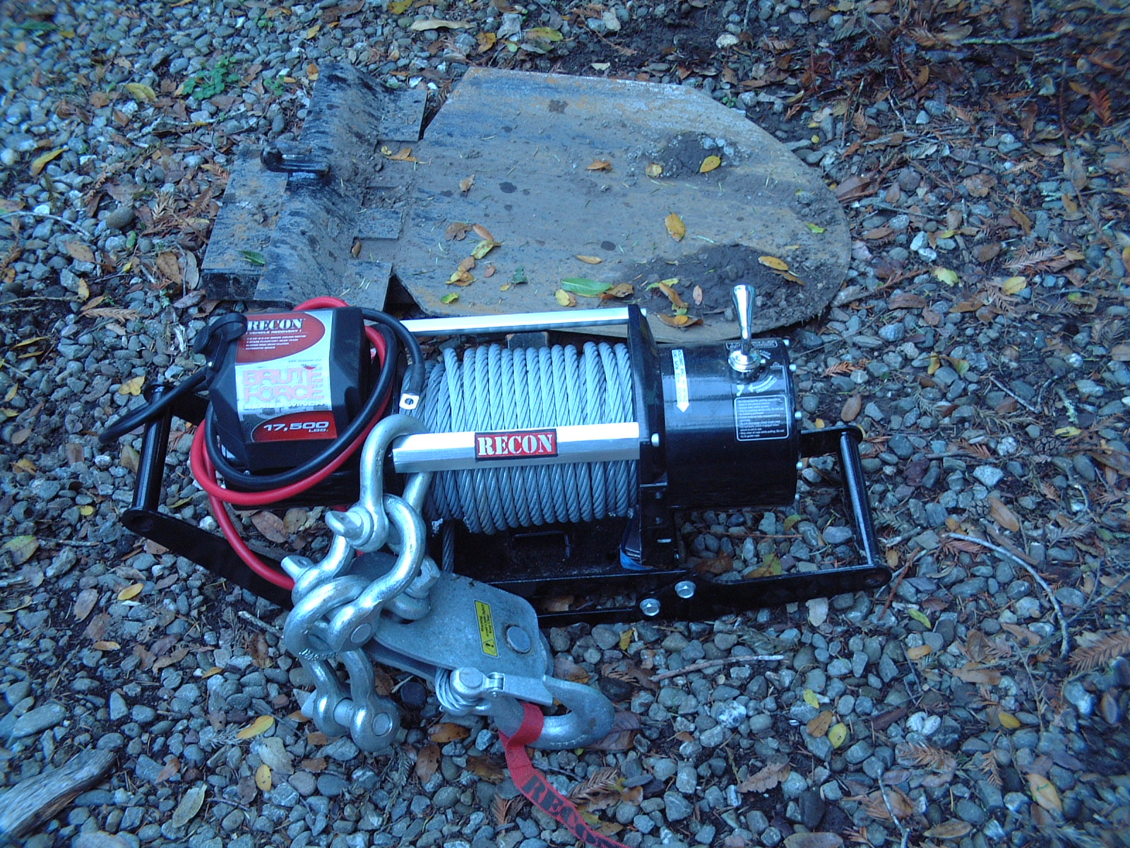

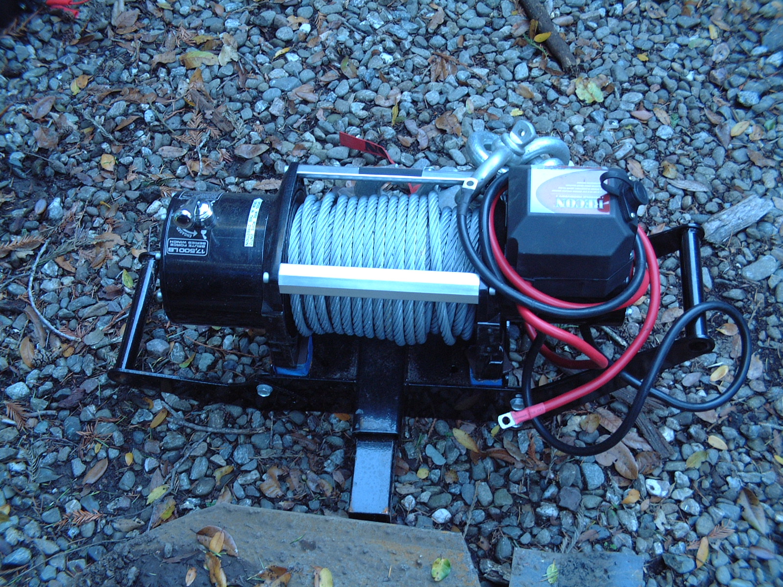

Hi Archem3,
I'm thinking of doing sort of the opposite of what you did when you pulled your truck out. You essentially used the blade and FEL as an anchor to pull against. I'm thinking of pulling the tractor out when it gets stuck / can't make it up a muddy slope. Very similar to a bumper mount on a Jeep. I'm probably being too cautious about mounting it on the FEL. Maybe I will put in two mounts or use a chain between the bucket and the frame to redistribute the force created by the winch. Although two mounts seems feasible too, one on the bucket and one on the frame. The big disadvantage of the frame mount is that it will interfere with the FEL. So if it was to be used that way then the bucket would need to be raised or left behind and pulled up the hill later with the winch.
Attached is are a few pics of the winch I will be using. It's sitting next to a quickspade combo for reference. You can see it's mounted on a receiver type mount.
Thanks,
Steve

Hi Archem3,
Thanks,
Steve
Do yourself a favor like I did, and get that polypropelene/kevlar/spectra whatever, synthetic winch line rope...cut probably 50 lbs (guessing?) from the weight of maneuvering the winch around and into receivers. No more broken strand punctures to the hands.
I would suppose there should be plenty of room up underneath the grill guard for a reciever and winch for your frame mount.
It's my hope not to require a winch too often (so as to benefit from the line change). I will always use snatch blocks, nylon straps, a winch bag and gloves when operating the winch.. The winch is massive, a ball park guess is that its roughly 30" wide without the mount. Wider than the space between the FEL loader arms? So it will not fit below the grill guard without protruding forward and requiring the FEL to be raised. The more I consider it the better bucket mount seems with a length of chain going between the frame and the winch mount.
Thanks,
Steve
