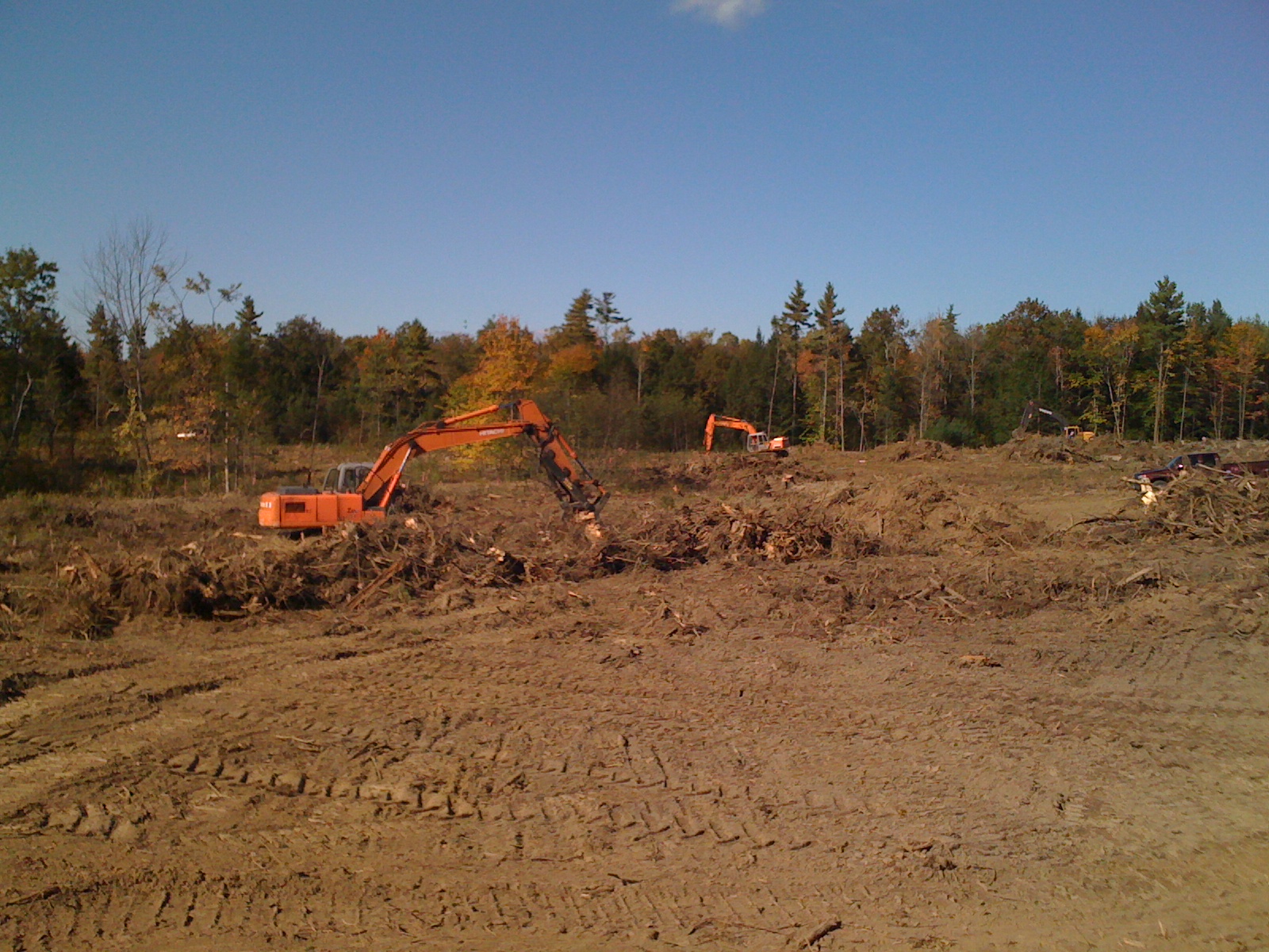

and to think, it started as this... and that was all trees at one point

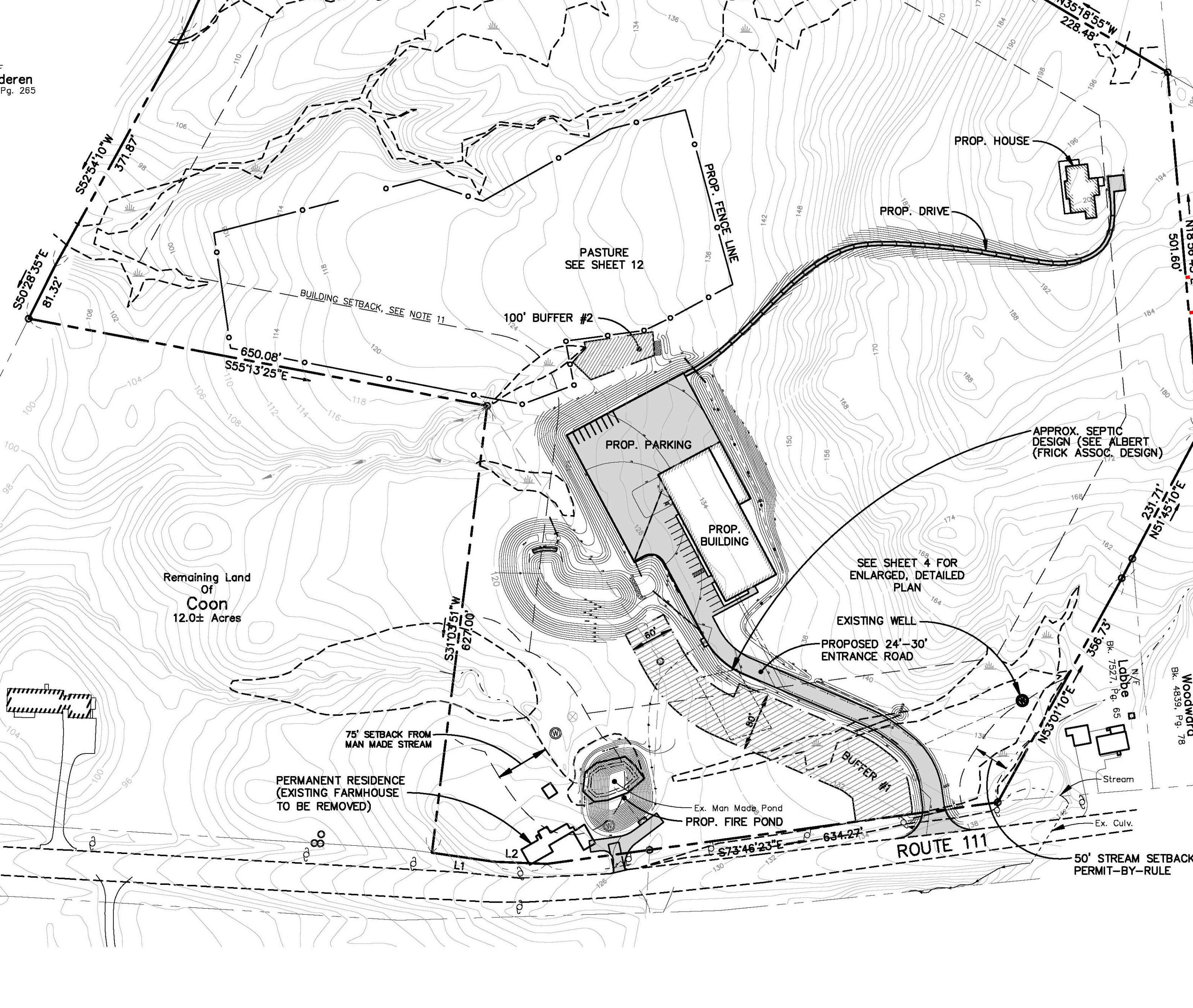

Of course the view is limited, but that photo of land clearing looks a lot flatter than your aerial photo.
Here is the topo of the original site and the development impact. I can say I had the original topo generated by flying the site and I would not say it is 100% accurate. Another big challenge of the site is that one corner of the building sits on ledge and the opposite corner sits on 21' of clay.
