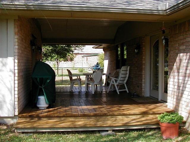

Freds, this house appears to have been recently painted inside, and whoever did it had to be one of the best painters around; did as good and neat a job as I've ever seen, even on a new house. Different colors used for different rooms (my wife likes it, although I probably would have just painted all of them an off white). And there are about a dozen paint cans in the garage; some Sherwin Williams, some Kelly Moore and a gallon can of Sikkens. I haven't gotten around to checking them out yet, but the Sikkens can feels like it's just about full. I guess that's what's been used on the deck (breezeway) between the house and shop in the picture.

That's so shiny it looks wet.

Freds, that picture was one the realtor had when the place was for sale, so I have no idea when it was taken. The guy supposedly had moved to Austin 6 months ago, but I don't know how long the place had been listed for sale. So the attachment is what it looks like today.
And Ron, "Sikkens Cetol DEK" is what the bucket of stuff left in the garage is, so I'm assuming that's what was used on the deck and I would guess he found it locally. I like the looks of that deck, so I reckon that's what I'll use in the future.
