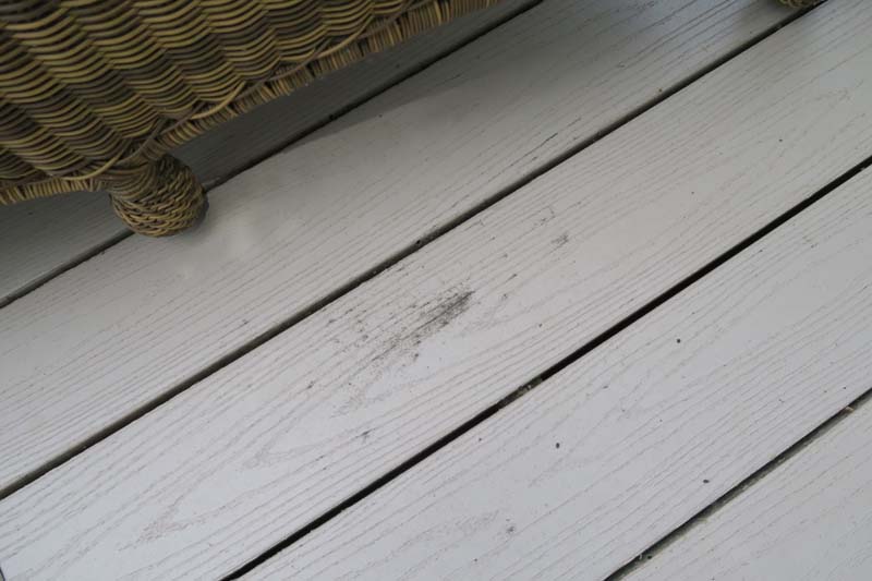

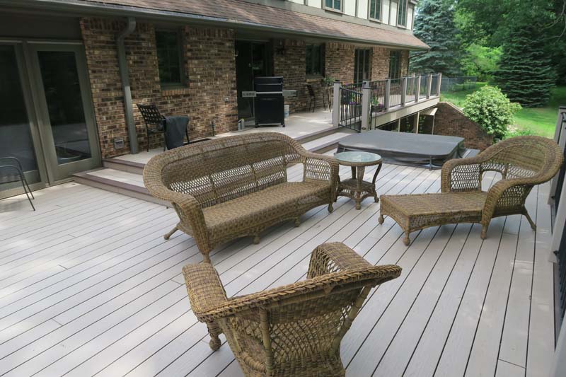

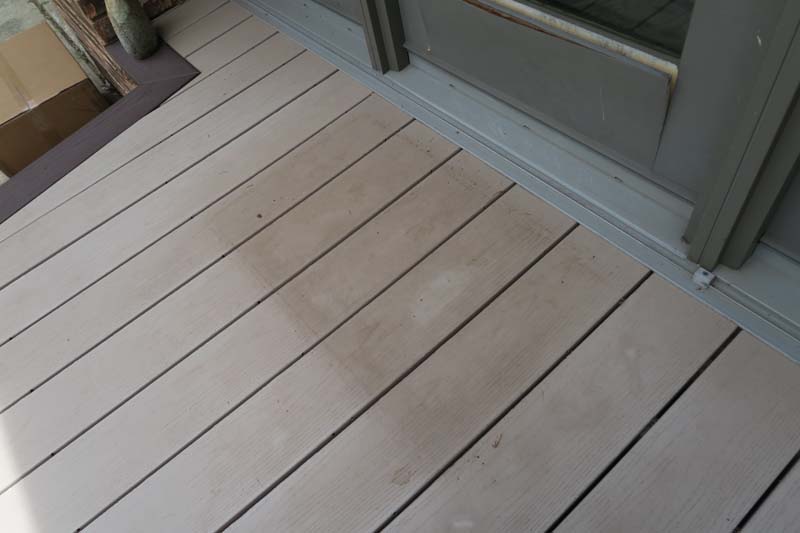

A few pictures of the Azek deck after over 6 years. Note the small stained spot. I've got two places like this. I'm not sure where it came from or if some harder work would take it out. Also, the spot under the mat showing the fading. This is in the sunniest spot on the deck.

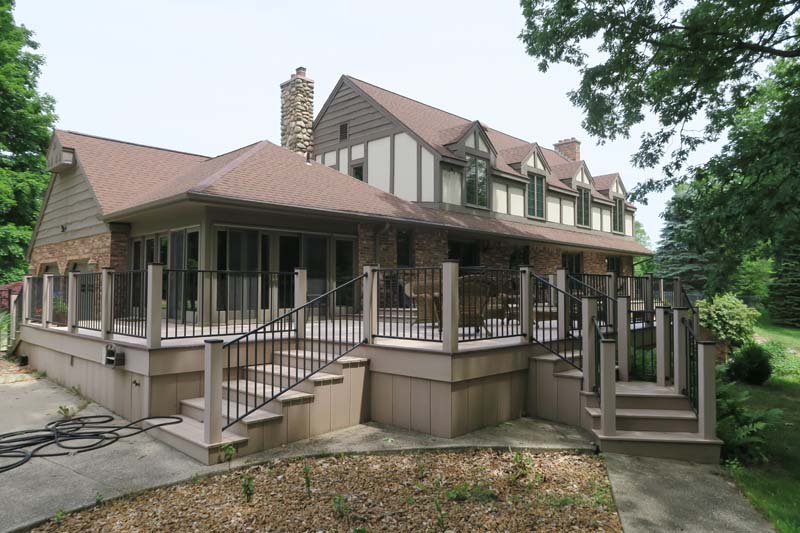

Also, note the borders on the deck with darker boards. This is something that's easy to do with composite decks. My deck has 5 stairs down off the deck and two levels. I added the borders as a safety feature to cue the level changes.

That is really nice looking.
Do you remember where you got the railings from? Those would be an excellent match for my needs.
I wish I could remember the brand. We went to three different local supply houses and must have considered a dozen differnt styles before choosing this one. They are powder coated steel. The post covers are Azek. We made the post tops out of Azek planks and painted them black.
