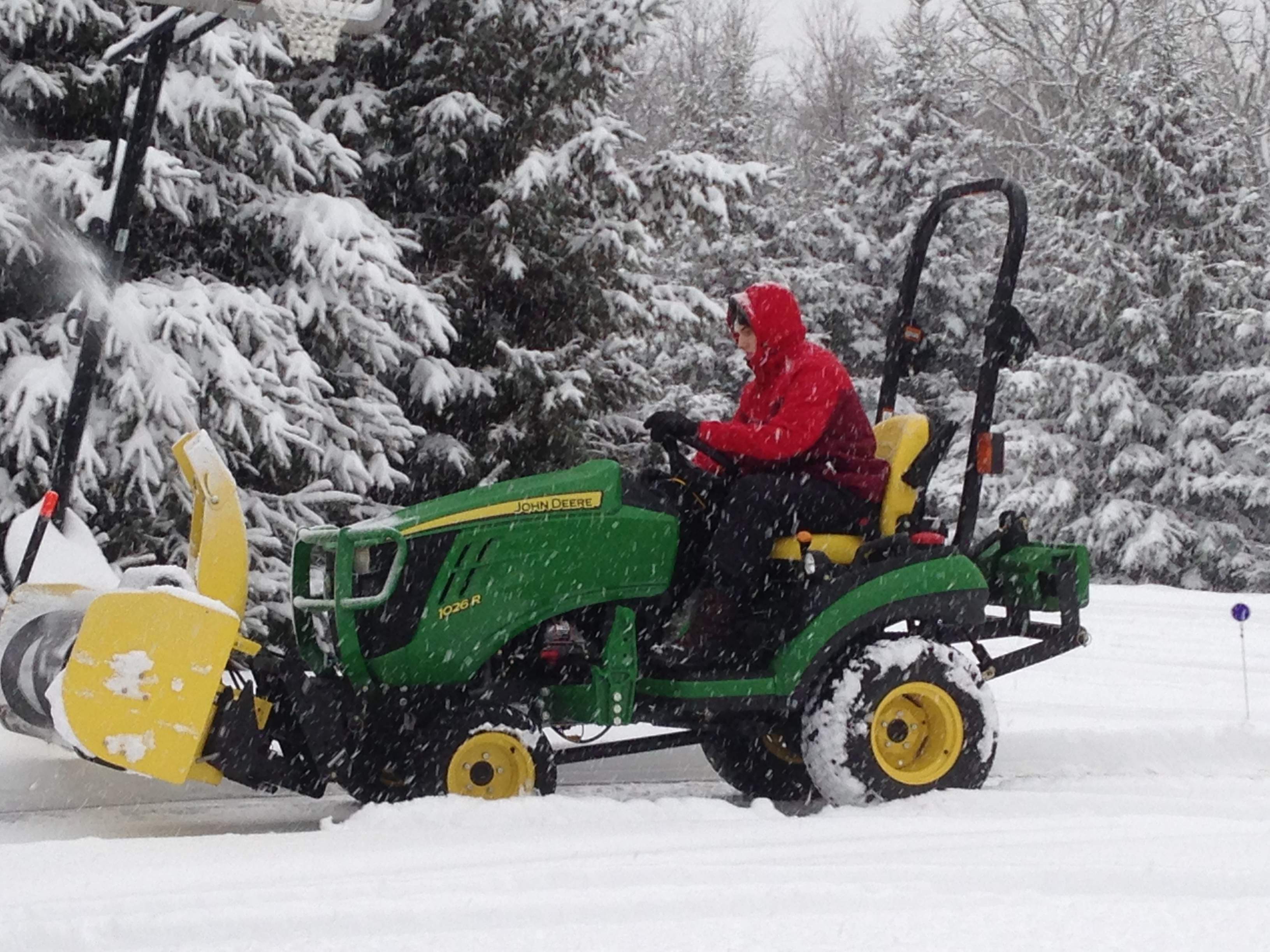

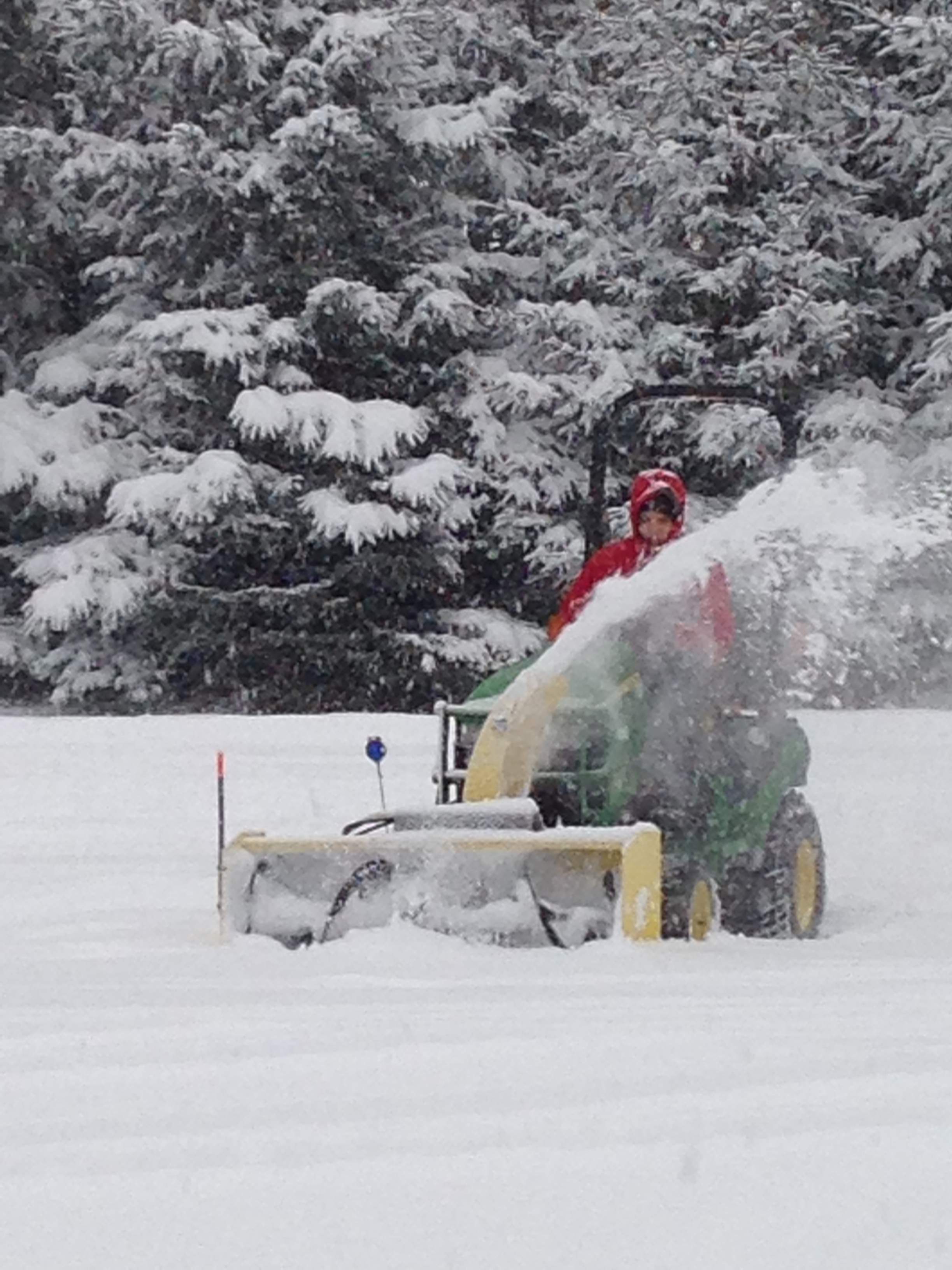

First big snow here yesterday. 7 inches of heavy snow, with wind afterward (this be flyover country, obviously). Temp around 20 degrees F.
Performance observations:
New Plastic Impeller:
The 54" Deere snowblower seems to throw a bit less further than my previous 47" Deere snowblower, but not so significantly that I was unhappy. Maybe throws 25 feet rather than the 30 feet my old one did. Many attribute this to the poly impeller, but it should not be the material itself that causes this. It is a function of velocity of the outer blade diameter, blade design (& no. of blades), & slipperiness of the surface finish. The diameter appears to be larger than my previous impeller, same no. of blades, so maybe blade design & surface finish are the culprits? It was difficult to tell because this was such a heavy snowpack (snow does not throw as far when wet & heavy). Anyway, it's good enough for me to not consider swapping to a used metal impeller.
Traction w/o Tire Chains:
Absolutely no problem here - with turf tires & 4WD the tractor never slipped - flat surface, uphill, downhill, sideways, whatever. Thank goodness cause I hate putting tire chains on!
Power:
Wow! With that little 25hp Yanmar diesel and wider clearing width I can really go! The engine never lugged like the previous 22hp Kawaski gasser - I didn't have to slow down to prevent the engine from lugging like my previous tractor. I only had to slow on snowplow drifts via sheer volume of snow so the impeller could digest it.
Conclusion:
The 54" snowblower performs well, I recommend it. Especially with a diesel SCUT or CUT, it is a powerful combination. My only issue is I MISS MY CAB!! - from my old tractor (had a FEMCO cab, similar to Curtis soft side cab, with heater, lights, fan, wiper, etc.). The swirling wind nailed me full-face with blown snow a couple times last night & it hurt! I re-discovered I'm not 30 years old anymore, onward to put on a cab. And yes, I'm gonna get one with a heater.
Questions welcome, here are some action photos with my oldest boy operating..........
