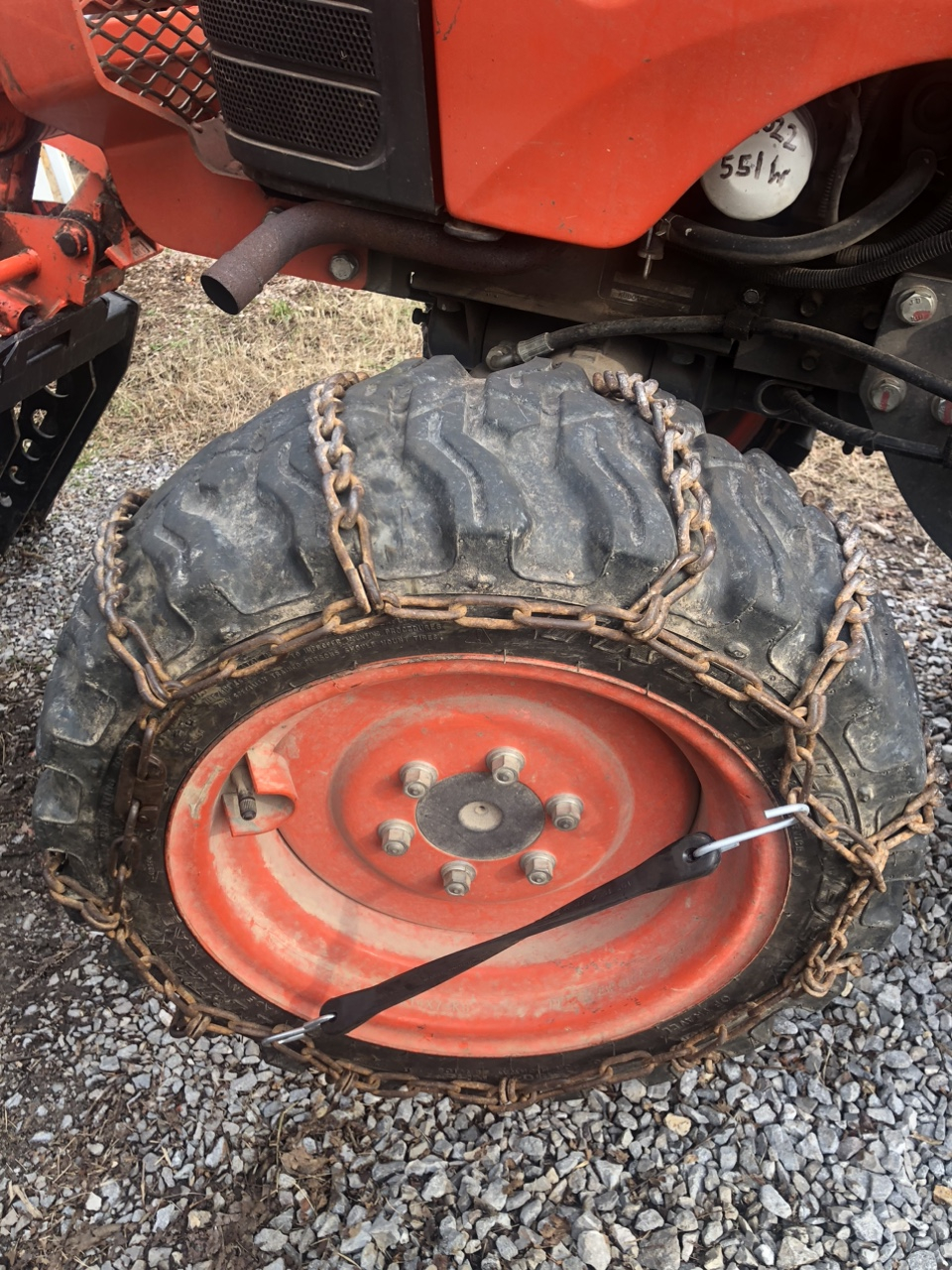

My main reservation with the R14 tires is trying to determine if they are as tough at the R4 tires, particularly in the sidewall area. When using them in the woods, I generally prefer R4 over R1. The traction is not as good, but I almost always have "Euro-style" chains on anyway. The R4 sidewalls seem to better resist damage from scrubbing up against stumps or rock than R1 does. IF the R14 has similar sidewall/belt construction as the R4, I might consider them when I need to replace tires (which is something that is probably coming all too soon.)

Don’t know about the L45 but my M59 and B26 needs the tough R4 tires being a TLBs. Have grooved the tires to improve traction in snow and lawn and pasture.
